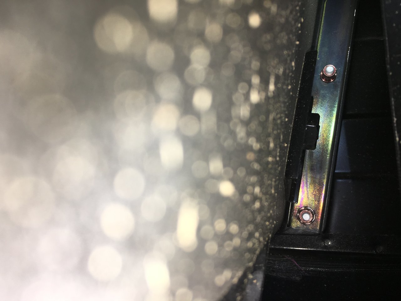

    is the stock hooks/rings bolt on to the frame? Not the bolts on the bed floor that bolts the bed down, but the ones on the left and right side of bed wall. If so what’s the weight capacity on them? I’m planning on carrying 3 dirt bikes but I feel like it’s too much stress for 3 straps per hook.

    I bet its a steel backing plate on the other side sitting on the plastic bed.
    I def cant see your frame... what frame? Its a steel outer skin, and a plastic composite bed right?
    Can u see the other side from crawling under the truck and looking up with a light?

    I believe it's just a steel plate behind the rope hooks....

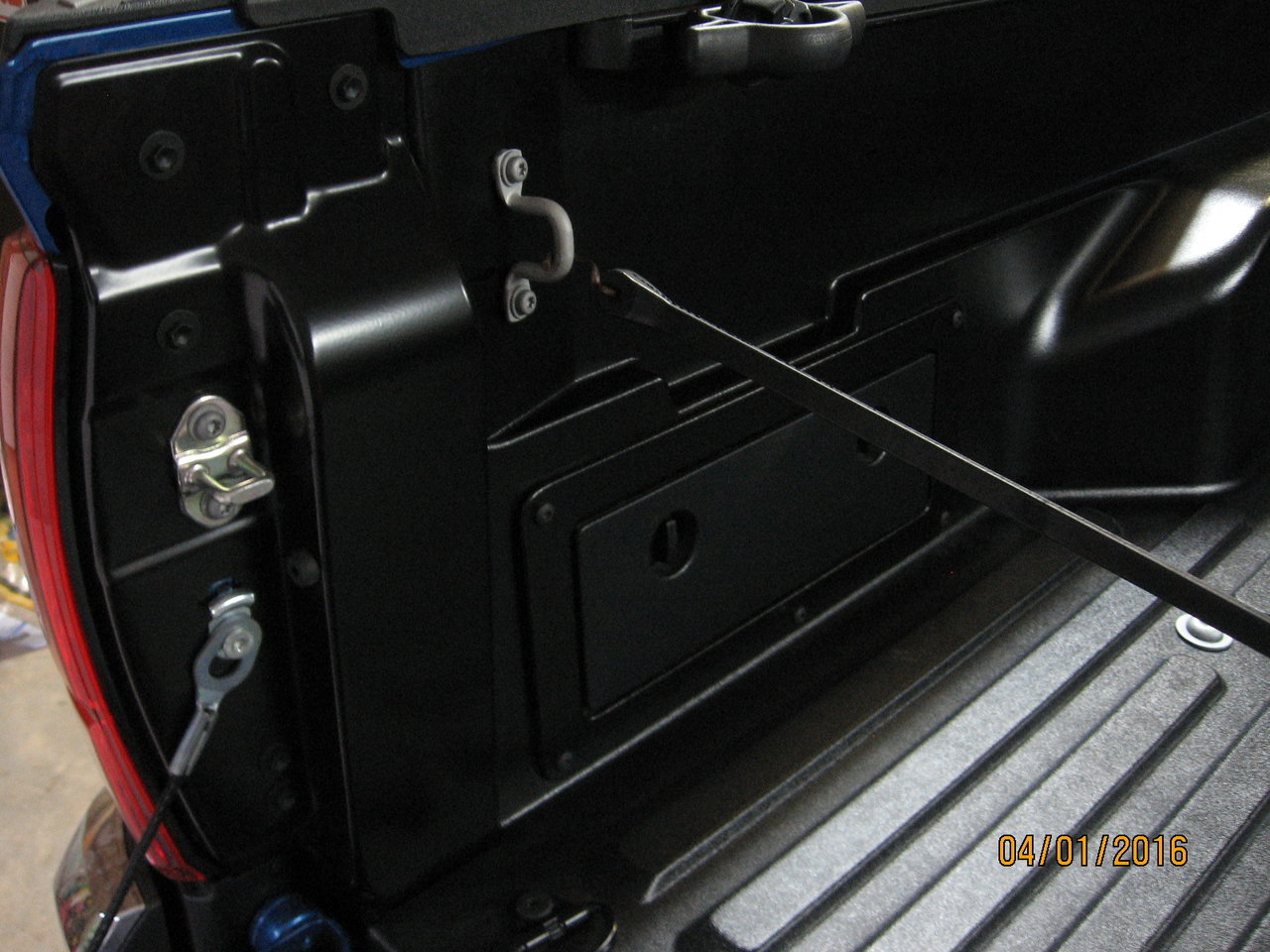

    I put a set in the rear of my bed and just used fender washers that were about 2 inches in diameter on each bolt...2 on each side

    They do have steel backplates. 2018, built 11/17.

    My 1999 king cab has these in the spot you pictured which I use all the time. Looks like the 2018 DCLB I have on order doesn't have them. Can you give more detail on the install please? Did you have to drill for them or... ? And if you had a part number that would be a bonus! Thanks!
