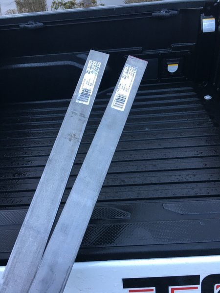

    Picked up some quickfists and some flat bar. Still need to get harware and some sort of T nut to go in the bedrail. I got the deer in the headlight look when i asked home depot for a 3/8-16 t nut lolIMG_0754.jpgIMG_0739.jpg

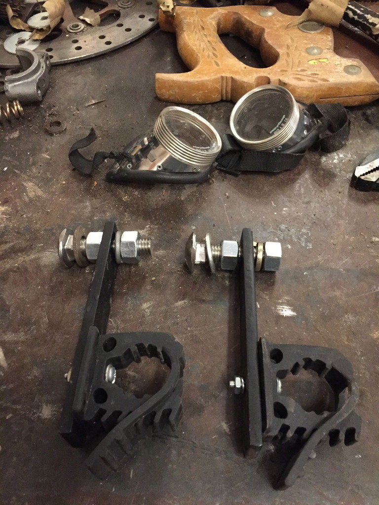

    Here's what i made before i bought the 5 pack of Tnuts. The head of the big bolt, i ground down on 2(opposite)sides(you can see in the photo) to make flat spots so it stayed in place in the bed rail. I wanted the shovel being held to be lower than the bedrail so it was kinda out of sight from afar.

    Love it!
    I plan to do a shovel and smaller camp axe on one side and the high lift on the other.
    Anybody make rubber bumpers or found another mounting location for the bottom end to minimize bounce on heavier loads?
