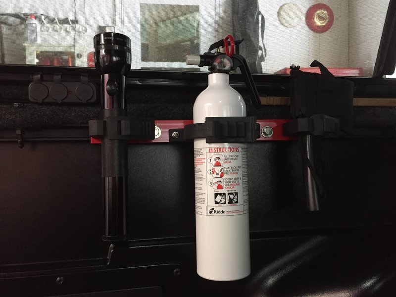

    IMG_0420.jpg This is what I did for my stuff.IMG_0421.jpgb

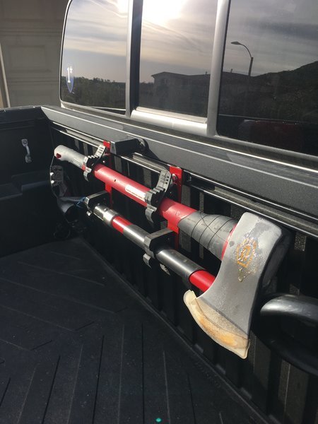

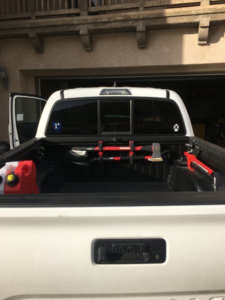

    IMG_2631.jpg IMG_2629.jpg IMG_2628.jpg Fabricated my own bedrail mount for rotopax , shovel and axe. Got the hi lift mount from @Shmellmopwho a member here

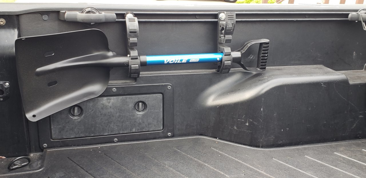

    Here are my simple quickfist mounts. Just a bolt through the quickfists with a large washer for some support, then the tnut in the bed rail. I have had these on for 20k miles and they are simple and solid. I have my axe and shovel mounted this way. I used a bolt with a large head to keep it from pulling though when tightened.

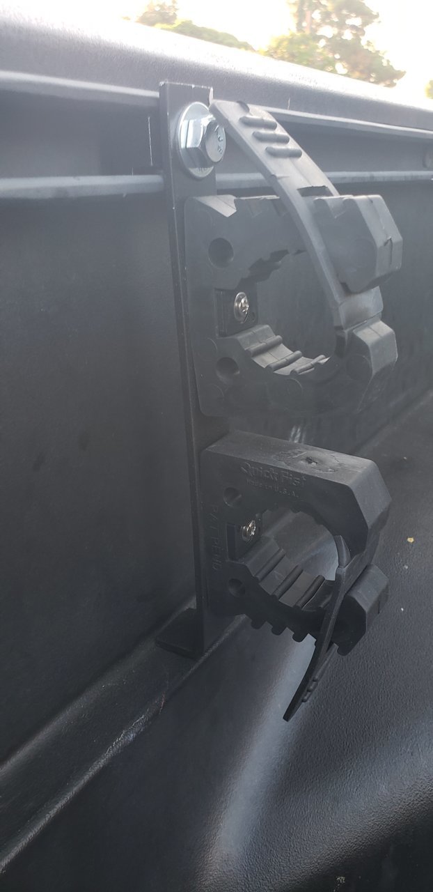

    Shovel mount, and extra anchor point. Ordered t-nuts and quick fist on Amazon, and everything else from Home Depot.

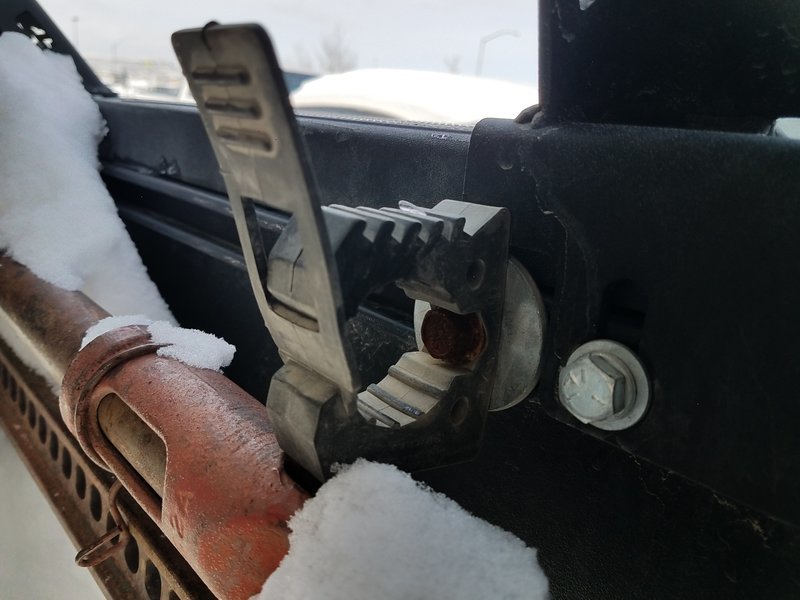

    Found in 2nd gen area.. made these a few years ago and still work just fine. 1/8"ish plate cut and bent to desired length, t slot nuts off Amazon, hardware from lowes. Not perfect but works great and fits under tonneau. I recommend taking time and painting. I didn't and rusted quick so I sanded and painted later on.
