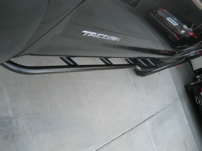

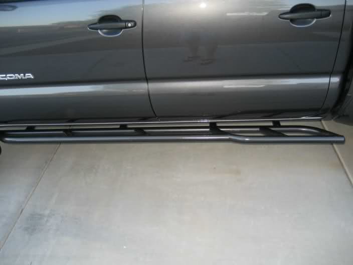

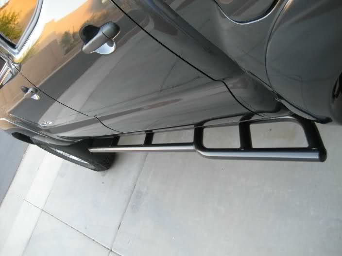

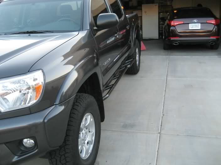

    Sorry it took me so long to post pics. I've been busy with work and a remodel on my spare time. A couple things I want to mention. It helped to drill a small pilot hole then finish with the large H.F. step bit. You also should consider wearing a long sleeve shirt when drilling to save your arms from getting burned from the metal shavings & eye protection is a no brainer. Also when bolting the drivers side rear leg it helps to drop the front 2 bolts from the gas tank skid if you have one. This will allow you room to get your hand in there to get the nut started and get a wrench on it. These sliders IMO are the best bolt on designed sliders on the market.
    As you can see I'm not a Photographer.
