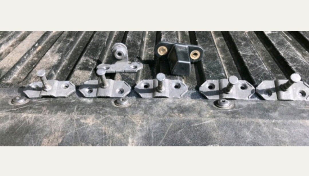

    So found someone selling a used oem cover but I'm starting to second guess my possible purchase. Can't do a rail swap unfortunately bc he's got a cap on now. He sent me a pic of the hardware and does it look complete? I know I'd have to mod my rails but why does it look like it's missing something. I fear It won't be water tight :/ like isn't there plastic that goes over the connection points usually?20190522_234101.jpg

    You're correct. There should be a plastic cover for each of those grey brackets with the pin sticking off.
    More importantly to most people though, there should be two rubber blocks that "seal" the front of the bed and bed rail gap.
    Dig around on here and you should be able to find on of the parts explosions to show what I'm talking about.
    Edit: here you go: https://www.tacomaworld.com/threads/rubber-plugs-for-gaps-in-bed-rail-available-now.420884/
