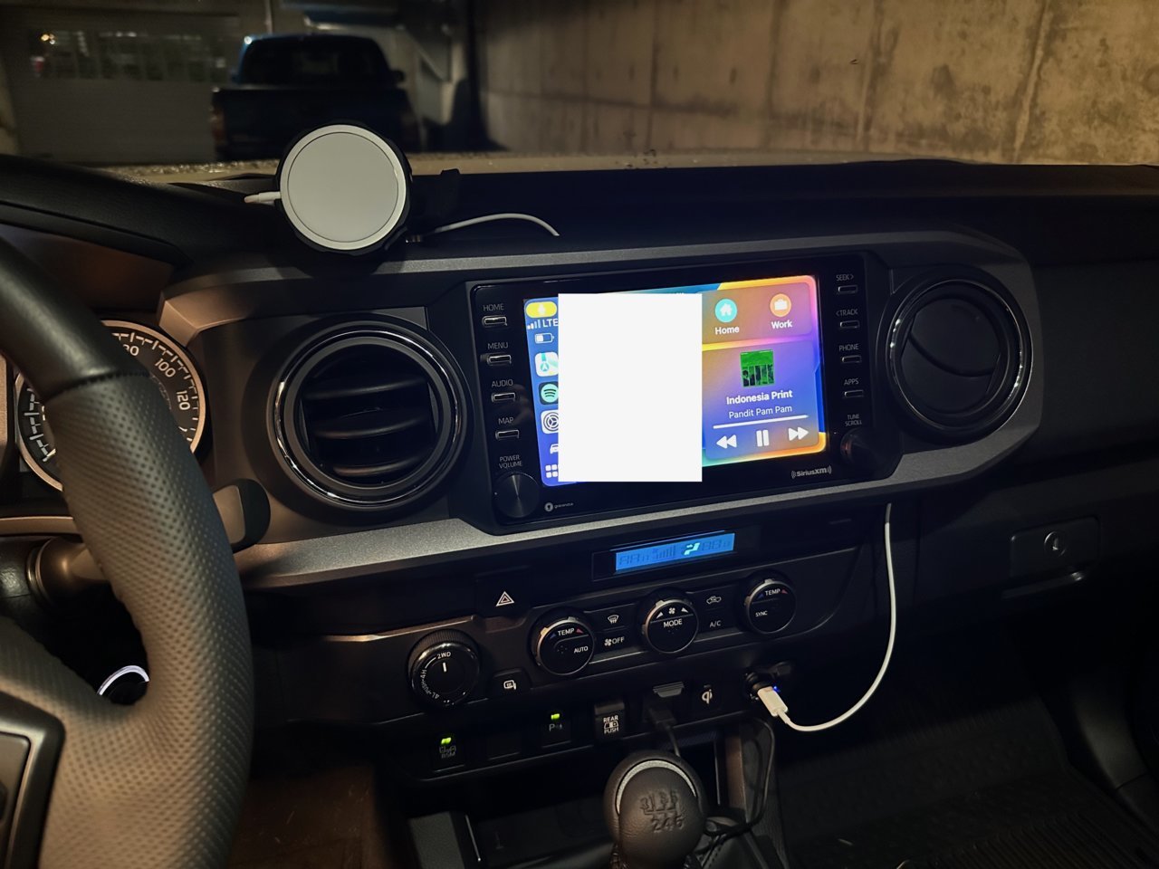

    I've seen a few ways of getting power behind the dash, from starting at the in-cab fuse-box, to stealing from the 12v, etc.
    What's the best, cleanest, safest, easiest etc way to go about doing this? I just need to basically get another 12v setup behind the dash with a 12v-to-USB thing, or even USB directly.
    I've even seen this, which looks like nearly exactly what I want, but it's out of stock (and doesn't make it clear where they are getting the power from): I've installed the DMM and love the mount, I just want to get rid of the ugly external power loop on the lower half now and clean that up by moving the power behind the dash. I have a wireless carplay adapter plugged into the USB, and magsafe into 12v, so I just hop in, throw my phone on the magsafe and go.

    Thanks. I'm using magsafe so I'll need like 10-15 watts. You went from the fusebox though versus forking off the existing 12v? Was it easy to do?

    I'm surprised there's not something like a y-splitter that uses the same factory connectors for the 12v or something... Maybe I'm just googling the wrong terms? I could also just relocate the center-console outlets (or unplug them somewhere and put a new harness in their place that I only run to the middle dash)? Running something all the way from the battery seems excessive given all the fused power running to the dash already that I don't need.

    I have a wireless carplay adapter hooked into that USB, so I can't use it. It does seem like I might be able to steal the same connection used by the center console plugs though, which are extraordinarily useless. Still trying to figure out the plugs. Maybe I have to just go tear the interior apart and get a good look.

    OP, I also put my phone near where you did (Hondo Garage mount that attaches to the round portion of the A/C vent). I also wanted to get rid of the charging cable hanging from the lighter port to the phone.
    Here’s what I did: Got a USB charger from Amazon, spade connectors for power and ground with inline fuse on power side. Went with Add- a- Fuse for power into a Ignition On only fuse. Grounded it by the existing ground stud by the driver kick panel fuse box. FYI, fuse box cover won’t go back on. I tie- wrapped the charge port to a wire bundle coming from the steering wheel.
    I popped off the head unit trim and ran the cable from the charge port in behind the panel and out the AC vent for now. Couldn’t bring myself to drill the trim.
