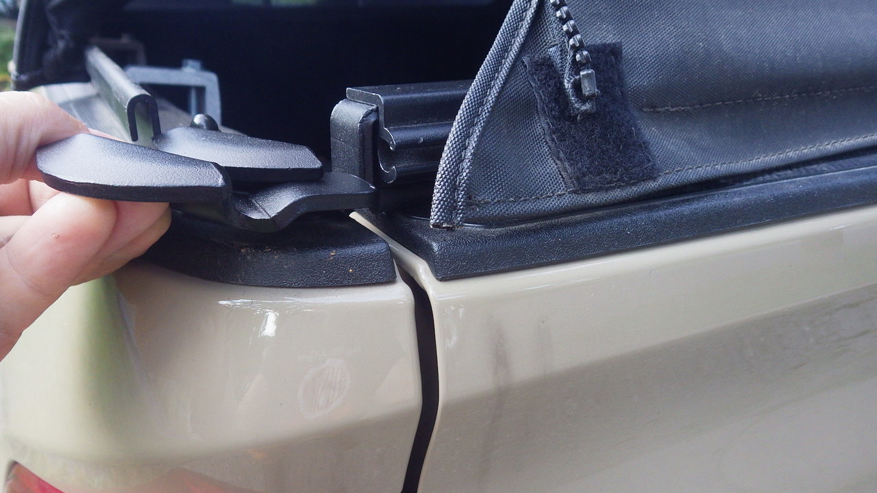

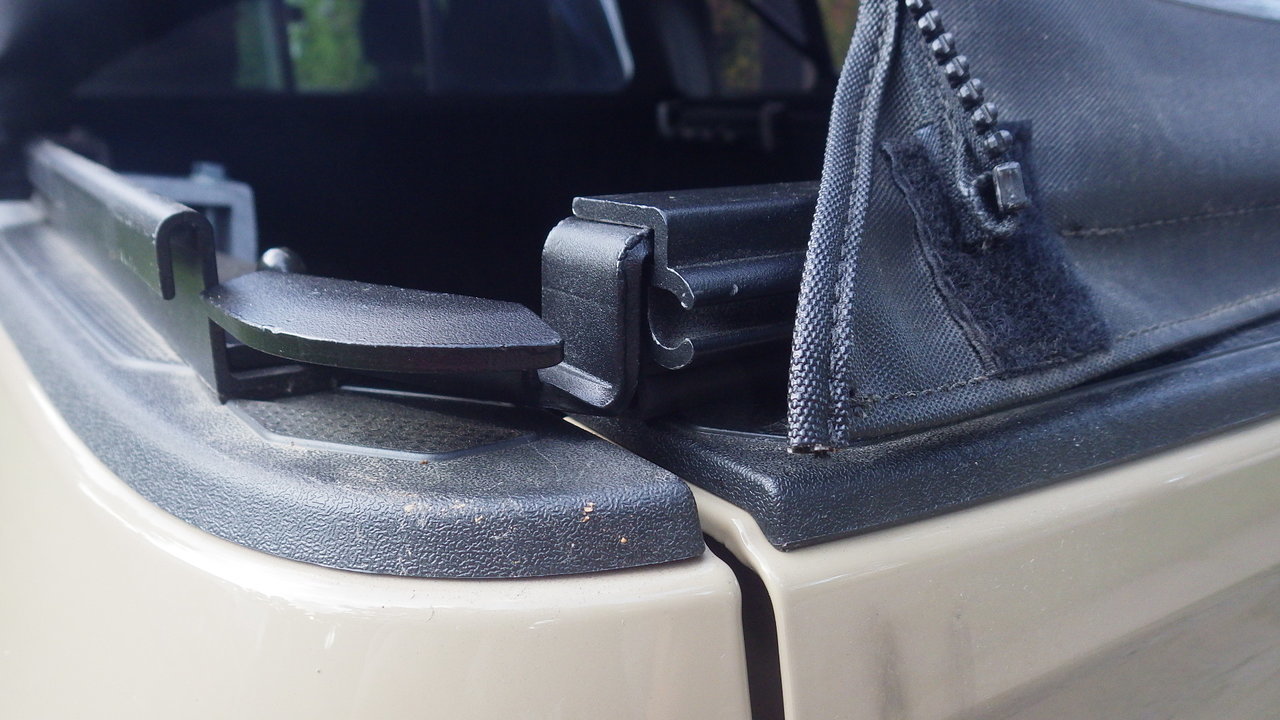

    Ok the first pic is the new corner bracket installed. Notice the tab which inserts into the tail gate bar, how high it comes up.
    Now below I am holding up the old corner bracket, the one that they ship with the kit. The tab is about 1/2" lower which doesn't work with the 3rd gen.
