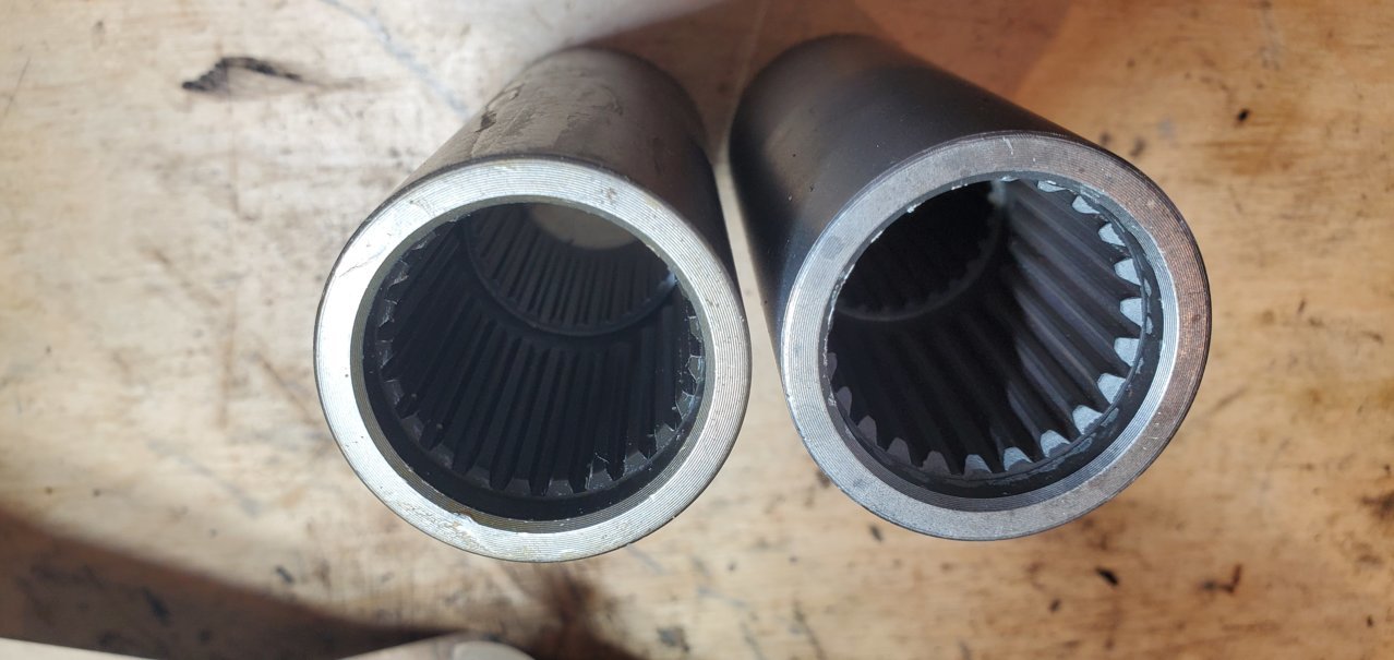

    So I went and grabbed the damaged adapter that they first sent me.
    And sure enough when I brought it home and checked it against the "replacement" one they sent, it was different :facepalm:
    I tested the original and it fits like it should on my factory case.
    I feel kinda dumb that I didn't notice this before hand when building it up, but I mean I shouldn't have to check for this kind of shit to begin with.
    On the other hand, I got the marlin coupler and it should work perfectly with the TG adapters. It's the same length and OD as the TG one. You can see that the splines on the marlin coupler on the input side are a big shorter in height than the TG ones.
    It slides right onto the marlin input gear splines like butter. Way easier than the TG one, so I'm happy with that. Still have to clean off all the wax coating from it though.
    marlin on the left and TG on the right
    I also checked the front plate adapter just to be sure there wasn't some hokey shit going on there too. But thankfully that matched up just fine with the transmission. So shouldn't be any issue there.

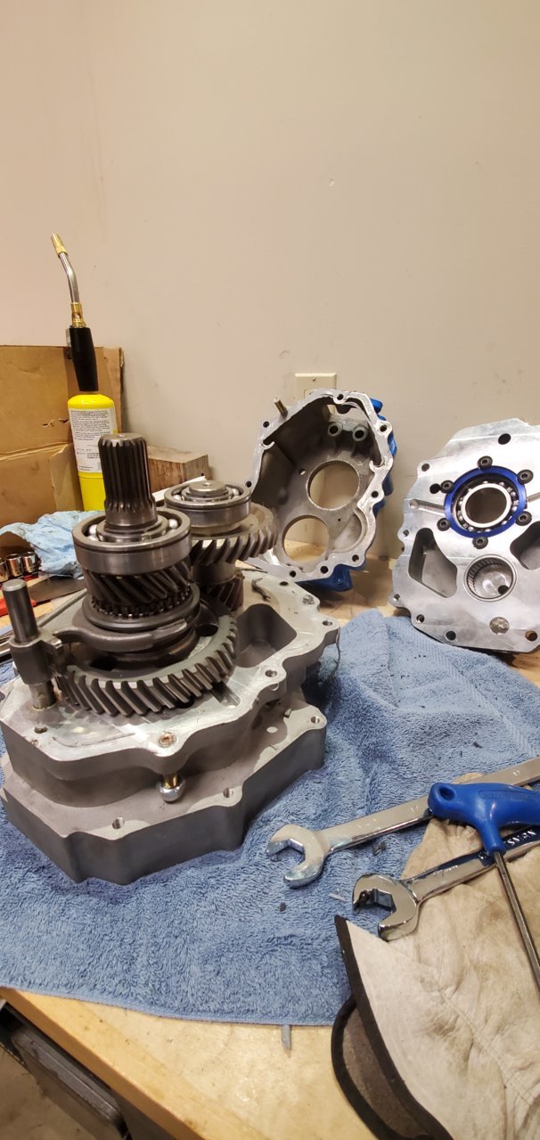

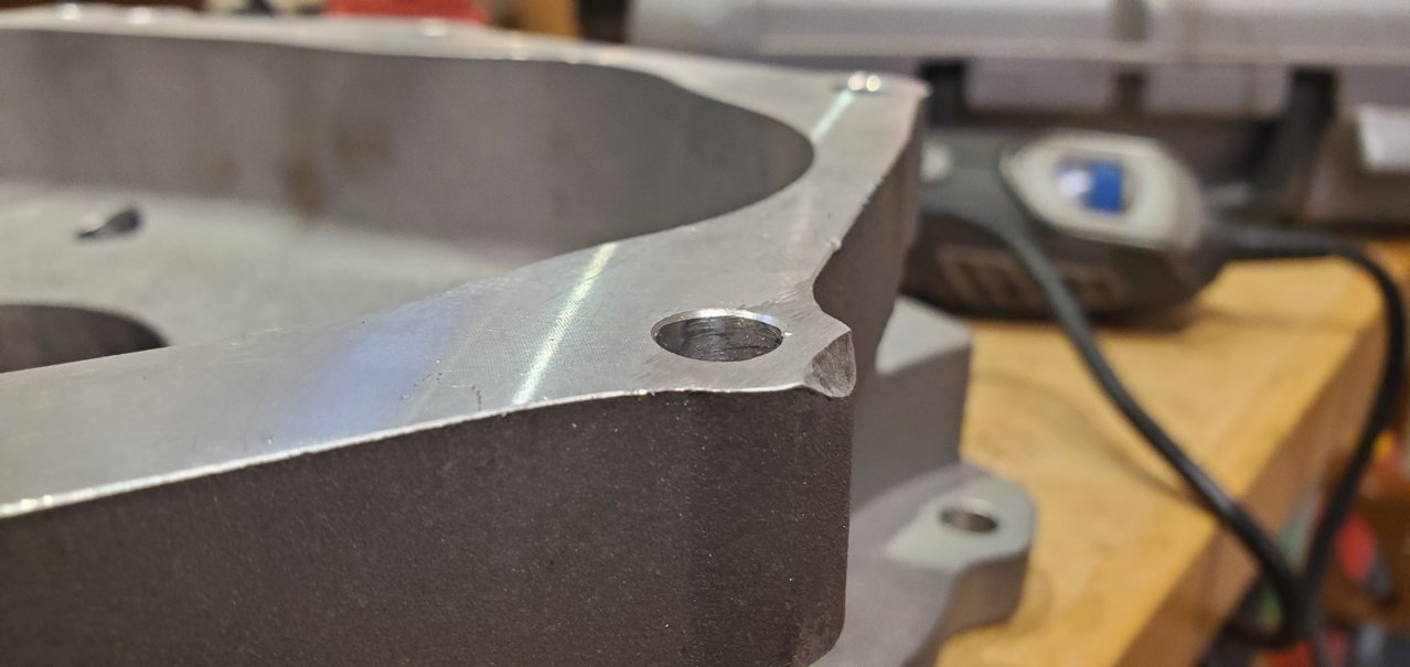

    So rather than wait for TG to get off their ass and send me the right adapter, I figured I'd just try and fix the first adapter they sent and make it work. Tear it all back apart and build it up again with the other adapter.
    Took my dremel and sanded down the part that got dented, and then drilled out the hole so it would accept a bolt. Should be good to go. Or at least i'll find out when I go to fill it all up.

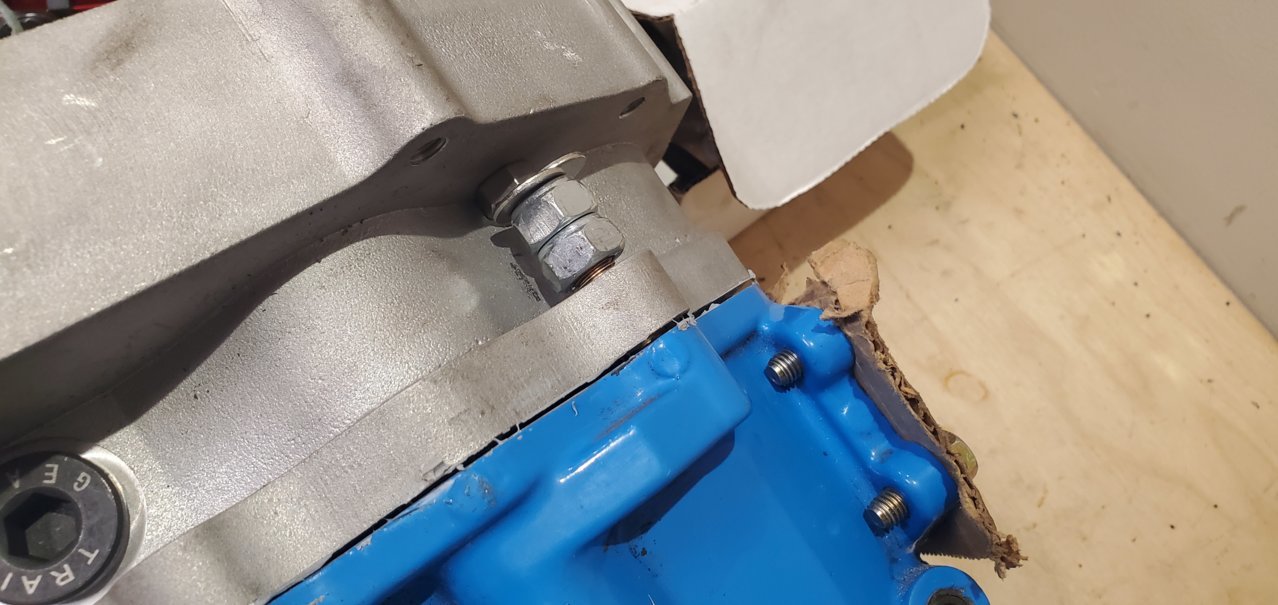

    Separating the rear adapter was tricky. Ended up putting another nut behind one of the studs and used it as a jacking screw against the adapter to push the other T-case away from the mating surface. Worked pretty well.
    Bolted everything together with ultra grey and waited an hour before torquing to spec. Interestingly my chain case already had the 11mm dowels in it. TG instructions tell you to install the ones they provide. Wonder if the v6 one doesn't have them or something.
    Really hope this thing doesn't leak because it's heavy as fuck and annoying to muscle around on the tranny jack to get it to line up.

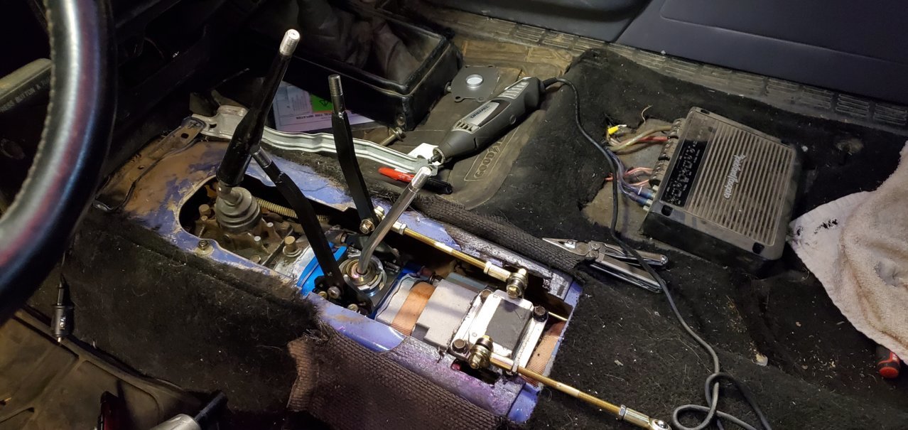

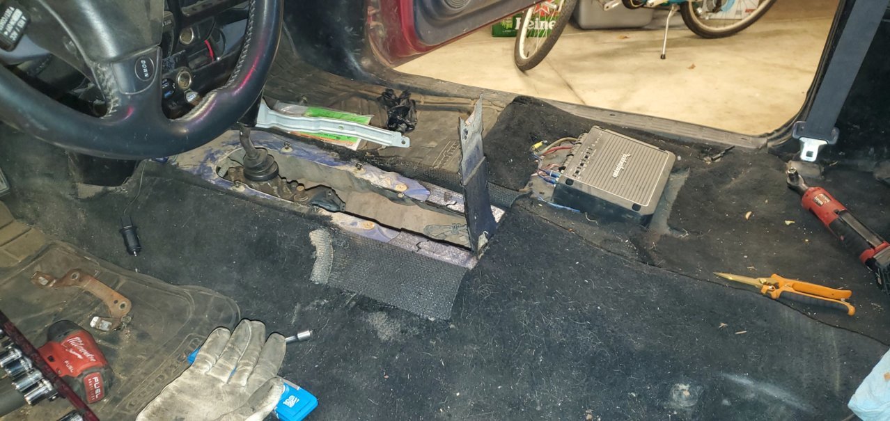

    Cut holes in the floorboard last night for the shift linkage.
    Also extended the 4wd switch wiring. Will also need to extend the wiring for the speedo sensor on the back of the case.

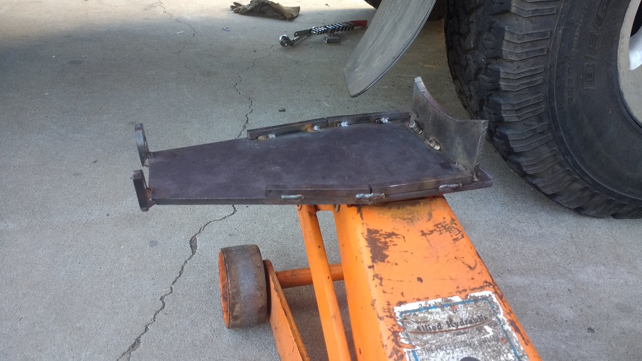

    Since you're diy to the bone I'd say making jacking plates that you could bolt to the pieces of the transfer case etc. and remove one section at a time could possibly be worth your while - I know you'd have to take a good amount of time tracing out mounting holes, but something I've seen on here for other things...

    Not a bad idea. although the methods I used worked pretty well. So if I were to pull it apart again, I would probably just use the same method.
    for the front plate, there are two mounting screws at the bottom that I just threaded bolts into that acted as jacking screws to push The adapter plate off of the front of the transfer case.
    You don't need much force, just really enough to break the seal of the silicone. Then the rest of it comes off pretty easy.

    Had to open the floor some more to make more room for the shifter linkage.

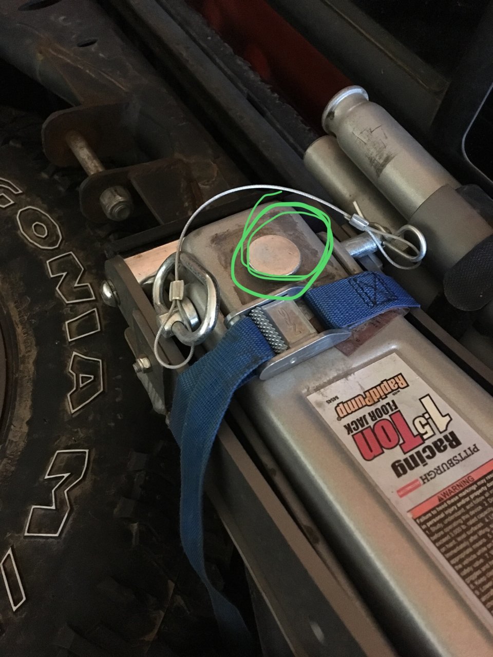

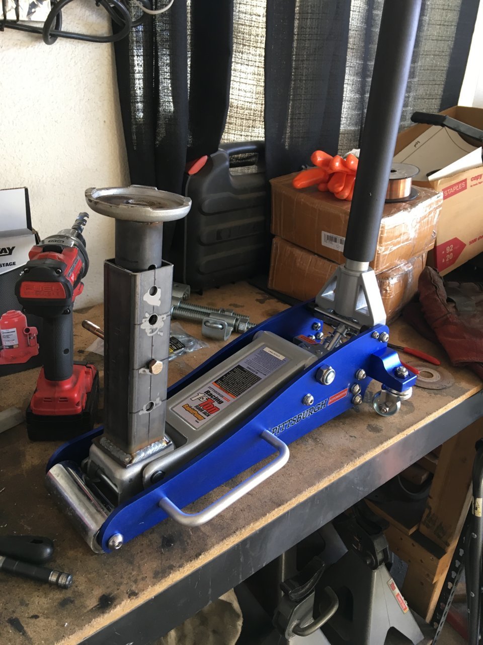

    When I did my clutch before, I had the HF 1500lb one (or whatever capacity their biggest one is). This one is better because it's smaller. It's the 800lb one. The bigger one is much heavier so more of a bear to move around.
    If I were to remove the transmission and leave the crawlbox and t-case attached to it, I would prob want the bigger one because this shit is heavy AF now. Would want the stability with maneuvering a long unit like this.
    Yea I would agree. Although it's usually a pita to get shit like that lined up regardless of the jack you have imo. It took me a while to get the splines to line up with the coupler on the crawlbox. Patience definitely helps lol
