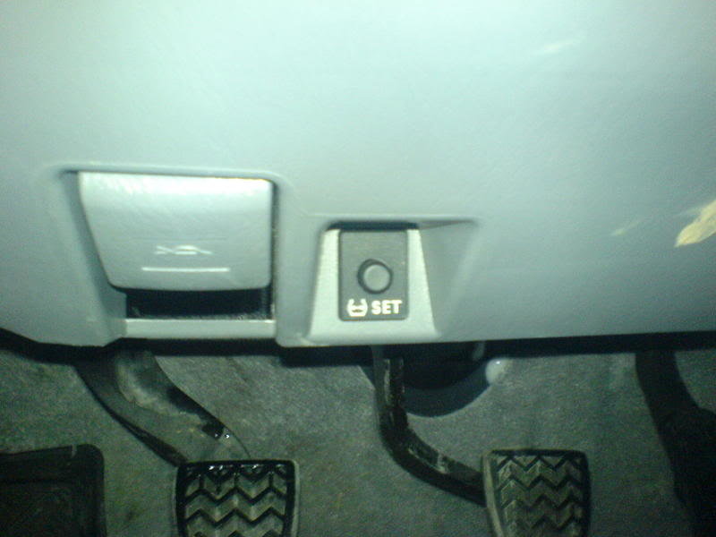

    Oh, the other annoying thing that happened. I did the tires on Wed, everything was kosher until late last night. The tire image light went out as soon as I got everything back where it should be and have drven a good 50 miles or so with the light being off. I drove 15 minutes on the highway last night and when I get off, the light flashes for a minute, then stays lit.
    Read the manual, when the light flashes for 1 minutes then stays illuminated, it indicates a TMPS malfunction. Hmm.....WTF???? I stopped at 2 different places and checked my tires, even crawled up and hit the spare with some air. Light still blinked for 1 minute.
    Went out this morning, none of the tires are flat or look low. Gonna Check the valve stems, check the pressure again, maybe take the spare down, get it at a good spot. If it's still on and I have inflated tires not losing air, black tape mod over the TMPS light.

    Well, the tire light is still on. Checked my tires and everything was cool so at this point I starting to not care about it. I put some electrical tape over it for now. I haven't done anything with the spare.
    Maybe the next time I do a tire rotation, I'll break the front bead and take the sensors out, replace them with regular valve stems and put the sensors in some tubing like I've seen some do around here.

    Air up all four tires and the spare tire to what PSI you want to run, and reset the TPMS. In order to reset it, there is a button (see picture below) turn the ignition to "on", press button, light cycles off and on 3 times, and release. It should turn off, if not, give it a few miles, if the TPMS stays on, the TPMS might need to be replace.
    The button is located beneath the steering column, I got the picture from this post.

    yea but if you aint runnin stock wheels..............sigh....

    Then you do the black tape mod. ;)

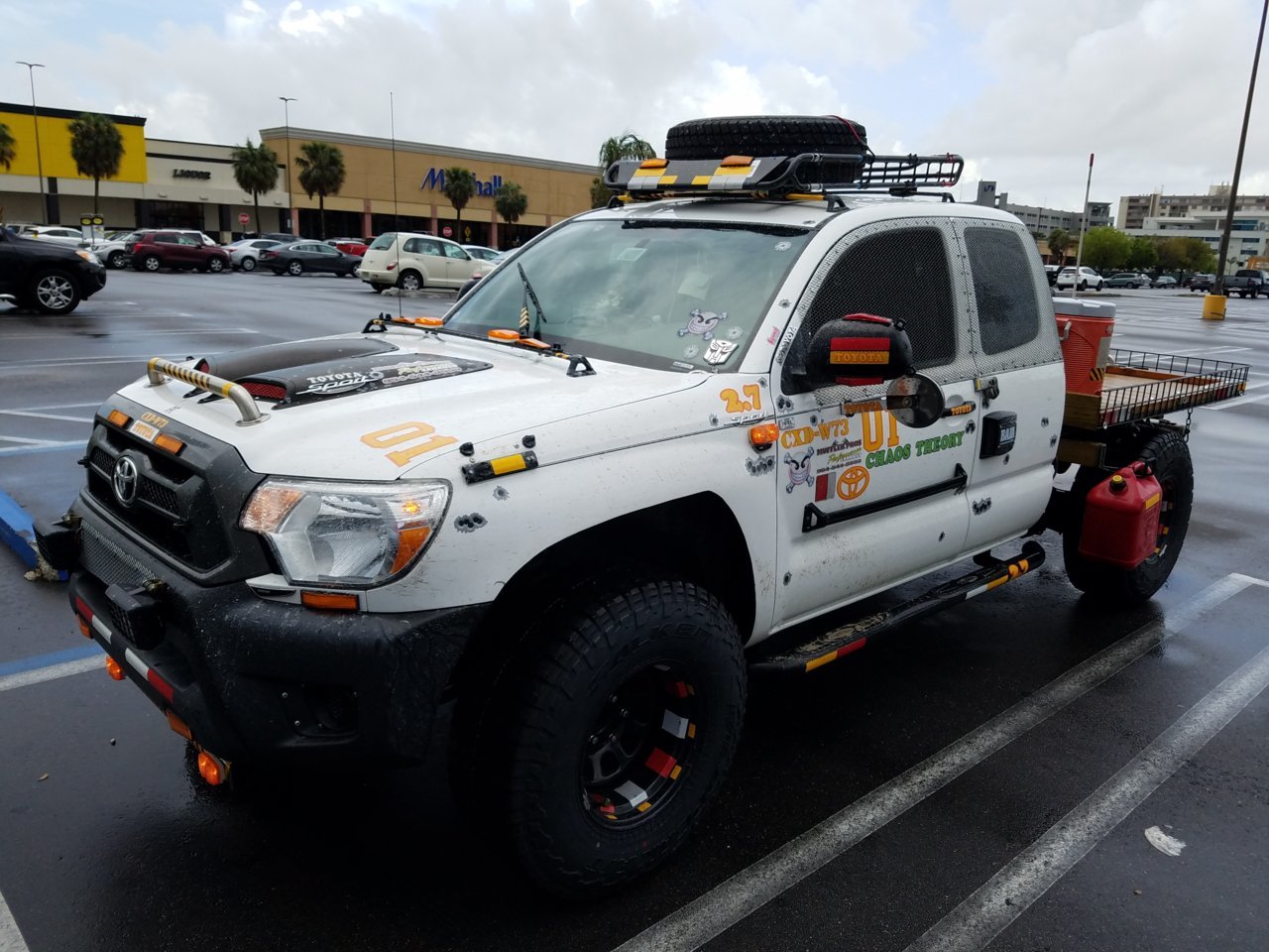

    I got 32's to fit my 2015 Tacoma 5 Lug without a lift.. All I did was cut the fenders
  18. Apr 22, 2018 at 9:29 AM
    #38
    TwistedKicker22
    TwistedKicker22 Well-Known Member
    Aug 20, 2015
    #162250
    319
    Manuel
    2015 Tacoma 2.7 5 Lug
    K&N. Magna Flow
    Honestly .. You shouldn't have a problem

    What a truck. Custom AF.
  20. Apr 22, 2018 at 9:40 AM
    #40
    TwistedKicker22
    Aug 20, 2015
    #162250
    319
    Manuel
    K&N. Magna Flow
    Lol Thanks.. Work truck.. But yes.. Biggest size tires are 32's I believe you can fit a stock
