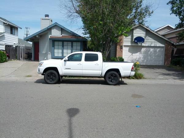

    Here is a picture of my truck with the 5100's installed, 1.75" setting on the front with TSB in the rear. This was before the alignment and the shocks settled a bit so its sitting even on the front and rear now.
