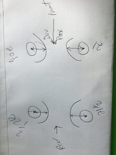

    My measurements were:
    DF = 19.5"
    PF = 19.75"
    DR = 21.5"
    PR = 21.0"
    The passenger rear threw me off because I was expecting it to be higher than the driver's side. Now I'm wondering if an aal will work for me. Need to investigate the spring pack - hopefully one is not broken.

    OK,
    So I tried to find a level lot and this is what I am almost certain the measurements from tip of fender flares to center caps on stock rims,
    DF -- 20 1/2"
    PF -- 20 1/2"
    DR -- 22"
    PR -- 22"
    they maybe a micro difference but not noticeable for the lot I was on!

    So based on this you could get the 5100's and set them on the second notch and be pretty level out of the gate without big $'s. The ride will be a bit firmer because you are pre-loading the coils. If you don't like that then a set of new taller coils is in order but the 885's will probably be too tall. The 883X's are a 1.5" lift iirc. Lots of options out there - more than I know about for sure.
