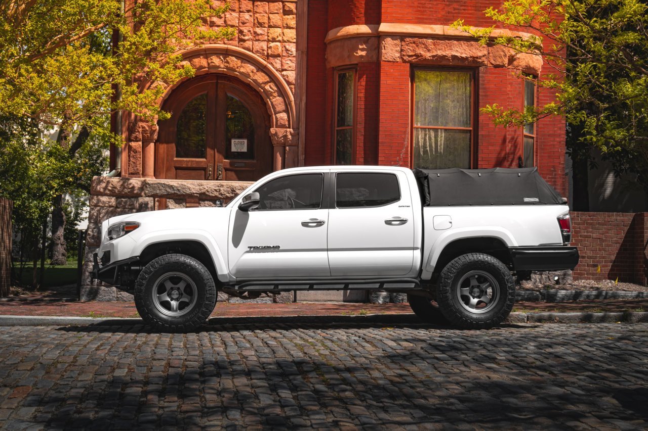

    Yo Man, you happen to remember your hub to fender measurements for front: 650lb coils at 5th notch on 6112 and rear: Icon RXT leaf pack option 3? and was it with any aftermkt weights on the truck? I take it Icon RXT leaf is somewhat same as Dakar HD AFAI (600lb constant weight in bed).
    I'm still debating on which notch to go with 650lb coils with the rear sitting at 26" hub>fender on Dakar HD leaf pk + overload leaf. Currently have 1" rake with 700lb coils on 6112 max 6th notch. Only aftermkt weight are the sliders. With 700lb on 4th notch I was at 24" hub>fender. I'm shooting for 5th notch with 650# coils for better ride quality. I don't want too much rake, ideally I would be fine with around 1.5" rake.
    oscolivar1[QUOTED] likes this.

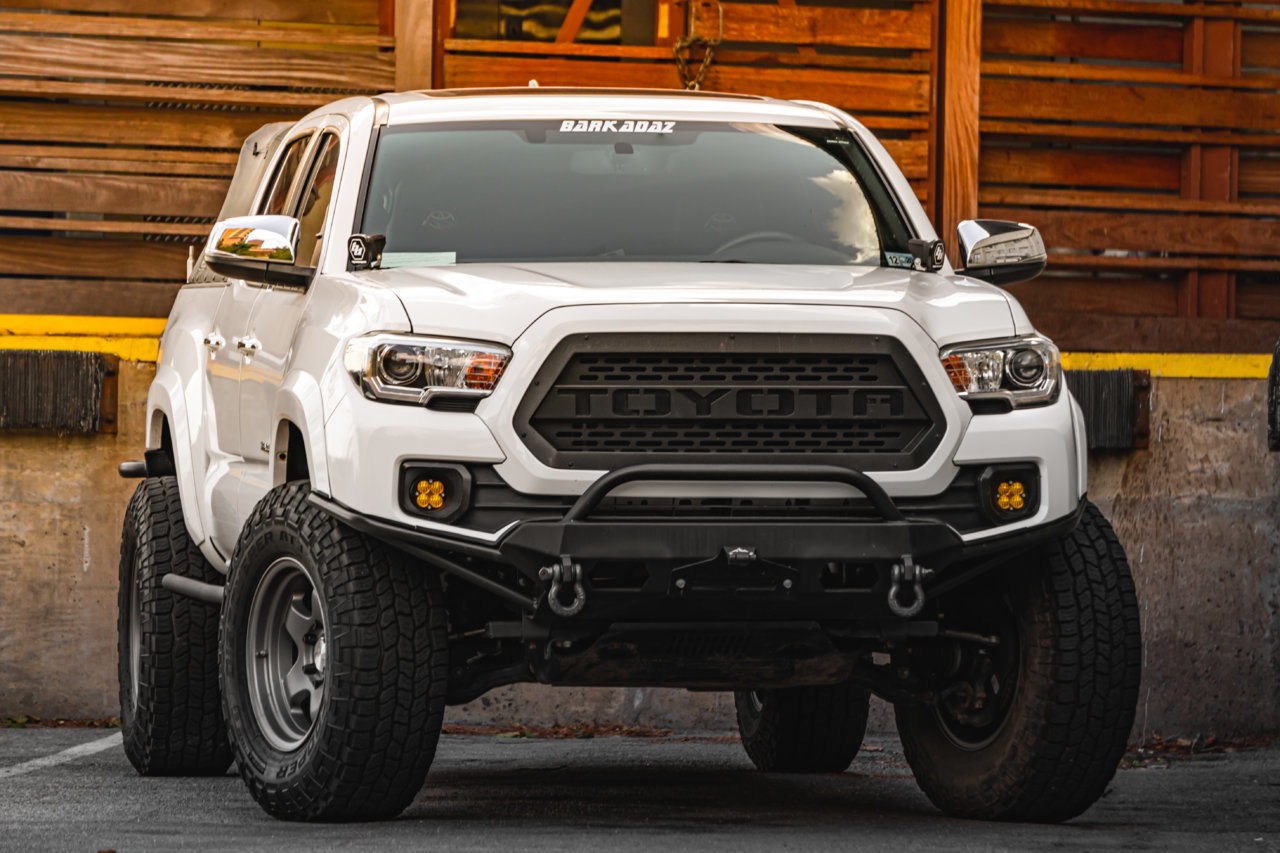

    Currently how she stands with 8112s 650coils and 8100s and icon RXT option 3. My measurements really didn’t change when I went for 6112 6/5 notch to the new setup. I’m about 23” from hub to fender front and the rear is 1.75”-2” of rake depending what I have in the bed. The rear bumper it self is 200 plus pounds, the front bumper is close to 85-90lb after I added tubes to the SSO offroad bumper. BA1D9D6E-18DA-4660-BE3B-849CECBA88F2.jpg 98CC3243-5502-4FDA-9E6E-9DAF6CA2A014.jpg

    23” at 5th notch so that would be 2” lift? pretty sure stock hub to fender is 21”.
    How much after mkt weight in the front?

    If your using 2nd gen 6112s I don’t have much input on measurements. I used 3rd gen 6112s. Max lift for 6112 and 8112 is 2” lift. 650/700 springs can vary your lift.
    Look at last post I mentioned weight for the front bumper. The sliders are 140lbs FYI and I just have the trd aluminum skid plate.

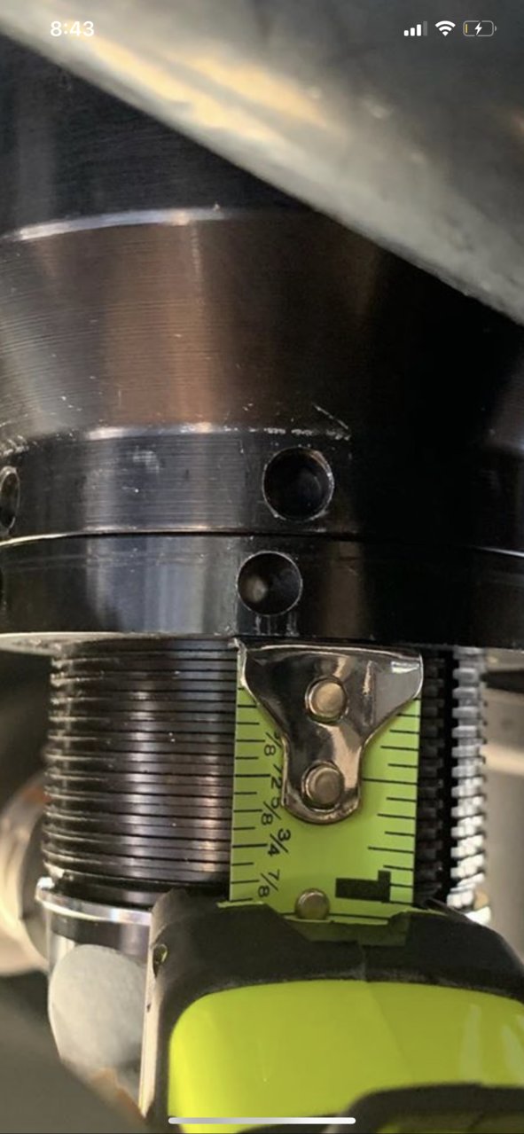

    How much of the threads are exposed on your 8112's to get your lift with the 650lb coils? I'm trying to figure out if I want to stick with the 600lb springs or step up to the 650's.

    this is the driver side and it’s the same exact threads showing on the passenger.

    That depends on your bumper. My bumper is 60ish lbs. At first it was 2.5” of lift....added sliders 140lbs and a couple of offroading trips it settled To just over a 2” lift.

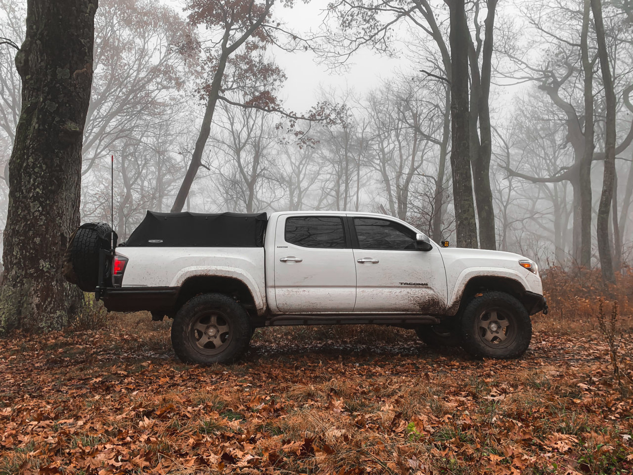

    Any pics of the setup?

    Looks good, man! Did you end up going with the 650# on 5/6? How's the ride without any weight up front?
