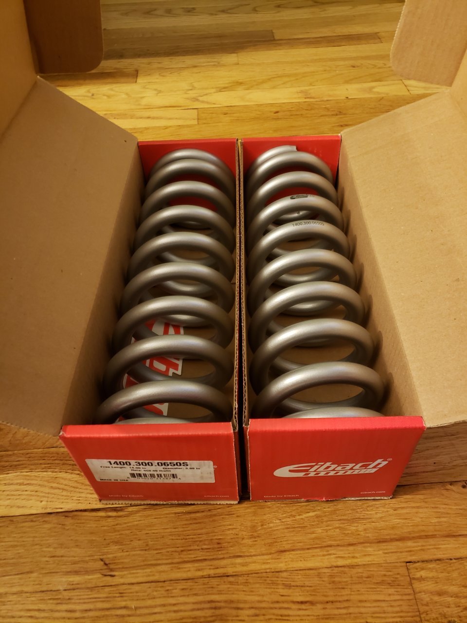

    Got them today. Will report soon. Once the bilstein 650lb spring are available again, i'd recommend buying that.

    650# 650lb rated front springs is a good choice! I've been on 700lb for over a year w/o any aftermarket bumper or skids. I do have slider but I would def recommend trying 650 over 700 if you don't plan to add weights on it for a while.

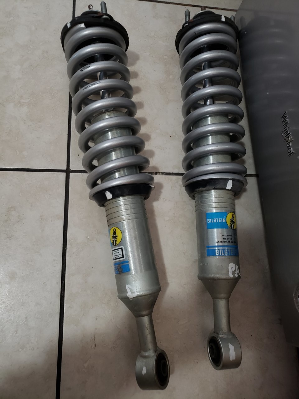

    I have slim front bumper, winch, sliders, front skid. I'm hoping the 650# will be enough. Just got the new springs mounted on 6112s. Will install on the truck tonight and upload pics.
    For the record, even with additional weight, the truck handles fine with the 600# springs. I lost some height, so trying to gain that back with the 650#.

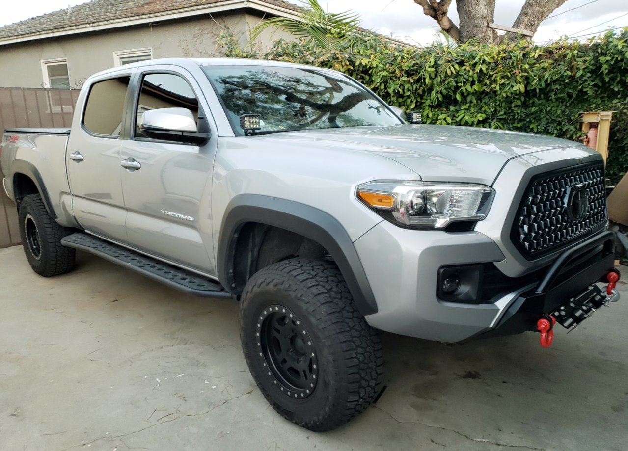

    650# springs on. :headbang:

    Why do people put a 1/4” spacer lift on driver side?
  18. Mar 25, 2020 at 8:18 PM
    #3158
    Superdave1.0
    Superdave1.0 Grandma Dave
    Dec 27, 2018
    #277158
    6,220
    SoCal
    LX470, 2025 Civic Si
    Because the driver side of Tacoma is heavier.
    You shouldn't put any spacers with 6112. The instructions say to set the driver side 1 notch higher.

    For 2nd gens, the 1/4" spacer helps correct for the driverside lean if the truck. On the 3rd gens, a 1/4" spacer is not needing because of the offset of the 6112 suspension.....being set at 4/3, 5/4, 6/5 etc.

    Dclb, extra weight. 650# springs at 6/5.
