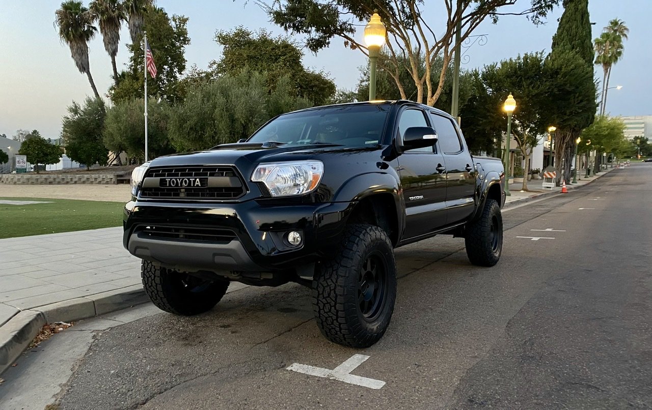

    I'm almost 1,000 miles in after the install, still riding pretty stiff (stiffer than what I want/feel like it should be)
    I feel it most when going over speed bumps.
    I'll try to explain... Approaching a bump even at a slow speed, once it hits, the trucks rebounds pretty harshly. and once over the speed bump, the truck drop and makes a quick "clunk" noise before it settles.
    Still set at 6/6 (how it came assembled)
    Planning to lower the height setting to 5/4 this weekend... hoping it'll help
    This wouldn't have anything to do with the SPC UCAs would it?
    (I came across another forum that talked about this issue, but wasn't convinced that it could be it)
    I wanna take the truck out to Ocotillo soon and drive through the washes (mainly flat, maybe some small whoops) to test out the new setup, but as it rides right now it wouldn't be fun at all.
    So that's what I'm trying to accomplish with the truck... More of a prerunner build for higher speed offroading. Slow trails/rock crawling won't be my thing.
    Long travel kit later down the road.
    Anyone have any feedback on this issue?

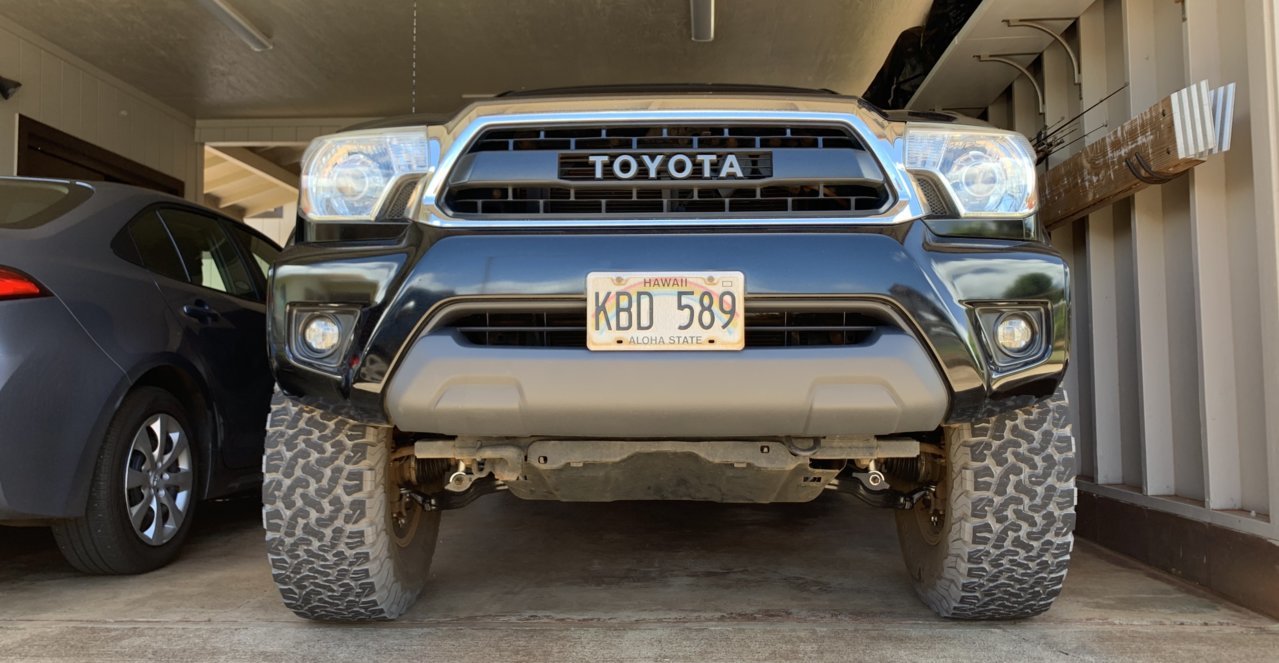

    Here’s a 3/4” difference, driver’s side being lower. Sorry for the low angle but it was the most straight on pic of it on flat surface that I could find on my phone. Can only tell if one measures.
