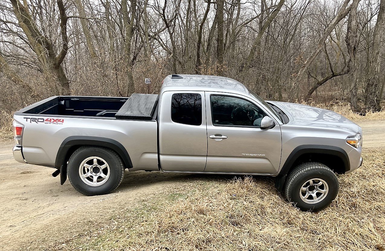

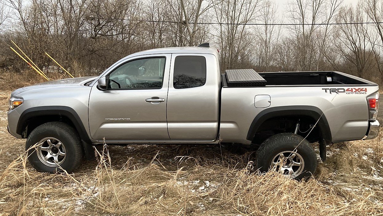

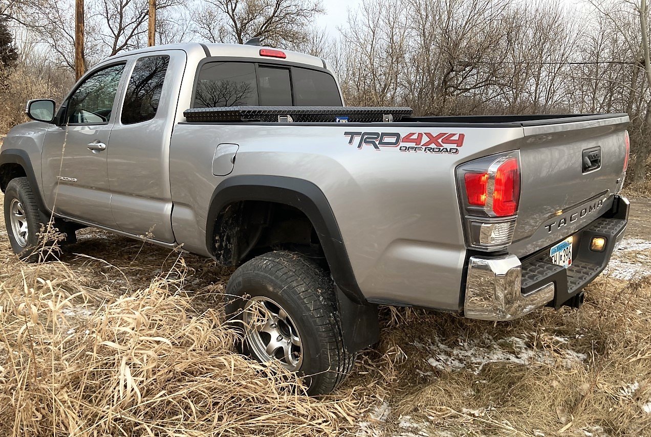

    My AC has 1 3/4" over stock configuration with the TRD OR front suspension.
    ~ 21" stock TRD OR AC - center hub to fender
    ~ 22 3/4" Bilstein (4th/5th clip) center hub to fender
    note.. I went to the dealership before I installed the Bilstein front coil overs and measured hub / fender on new TRD DB cab vehicles and they did measure less than mine in stock config.

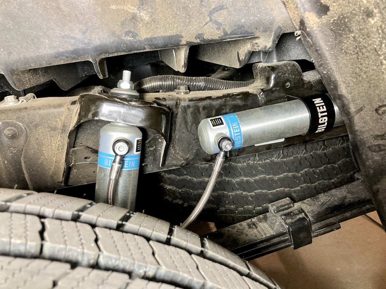

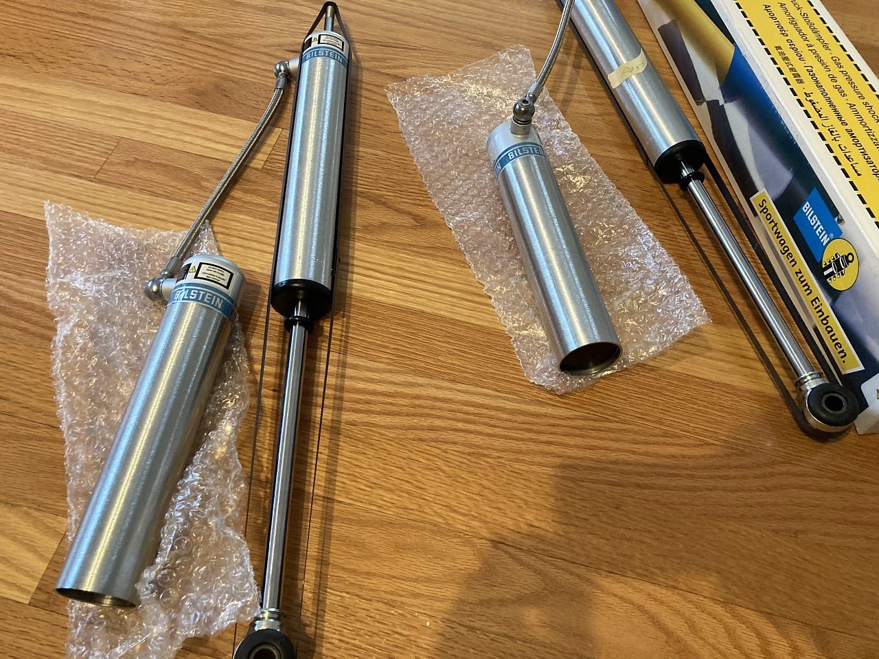

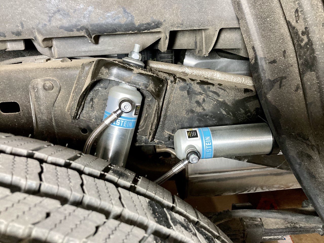

    Today I received the 5160s for the back suspension change out to compliment the front 6112s I installed a few weeks ago. Saw upon unpacking that these are stamped as being manufactured right in Germany. Cosmetics of the back shocks and reservoirs is extremely impressive, especially considering the relatively inexpensive cost. All necessary fasteners (incudes a spacer for the brake lines over the top of the axle), reservoir brackets, and instructions are provided with the exception of the factory lower rear shock bolt/washer/nut. Packaging was substantial with heavy duty package staples to secure the product from any damage during transit.
    Removal of the OEM rear shocks is a cakewalk, however the Bilstein product required more intricate fasteners that attach the reservoirs to the frame. Everything provided seemed top notch and very well designed. The difficult part was primarily involving the attachment of the reservoir to the passenger side in front of the shock assembly due to the extremely tight working conditions. The exhaust silencer hampers the ability to get your hand/arm in position to attach the two fasteners and backing plate in place on the inside of the frame rail while securing it to the reservoir bracket on the outside of the frame rail. I also found it difficult to get my torque wrench in position easily but did find it possible. The install was done with the OEM rear springs. I have not determined what my final bed weight will be yet, so I'm holding off at the moment for rear lift. Confirmed near max articulation with no issues after. There is a gain in front and rear droop over stock TRD OR when articulating the suspension. No front coil - upper control arm contact at full droop. Haven't read the entire thread so much of this may be a repeat of what is already mentioned.
