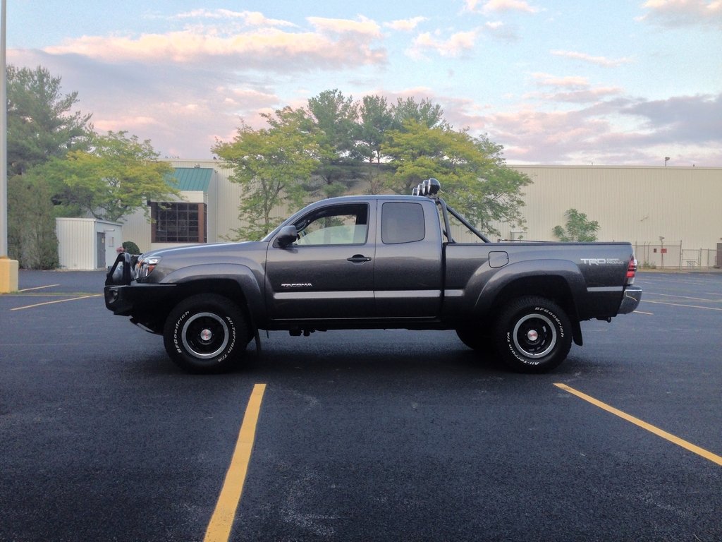

    #28
    MikeyMcFly
    MikeyMcFly This is heavy, Doc.
    Aug 11, 2012
    #84551
    6,263
    I'm a Masshole
    2016 TRD Off-Road 6MT / 2021 WRX STI
    Building a Broja
    46d3ba09-1d1f-4e05-897d-798afef22c1b_zps_5d27bd97b3e13bbccd8ed7c5ba2439dad16d08ee.jpg
    Eibach 112-620 1.6 Coils
    Bilstein 5100 on all (4) corners
    Front set @ 0.85" (approx. 2" of lift up front with the ARB giving some reduction from the advertised 2.4")
    1/4" Driver Top Plate Spacer
    Icon 1.5" AAL w/TSB springs (probably ~2-2.5" of lift total)
    I paid under $750 for everything (Eibach coils and spacer from ToyTec, 5100 and Icon AAL from DSM).
    My caster numbers are low (around 0.9 to 0.95) and I probably should be running upgraded UCAs, but I haven't noticed any particularly troubling characteristics on the road/highway. YMMV.
    Please note when you lift your truck you WILL run into vibrations, and some will drive you nuts. I had the very common 35-50 MPH vibration that I needed the ECGS bushing to remedy, so factor in another $175 for that (bushing, tool and shipping). I've still got something at 60 MPH that I haven't addressed, a take off vibe as well and all kinds of fun new noises which have been driving me nuts. I'll work through it and figure out what's going on, but it's not a set and forget deal.
    I'm not trying to sway you to lift or not, but think long and hard if you want to open the can of worms that is lifting these trucks.
    black_cukui likes this.
