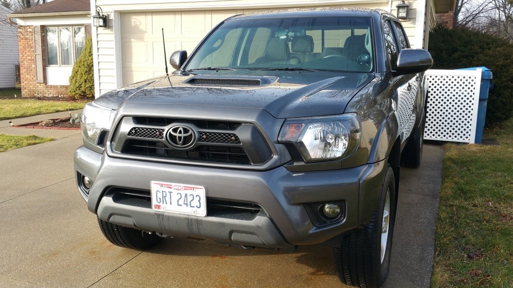

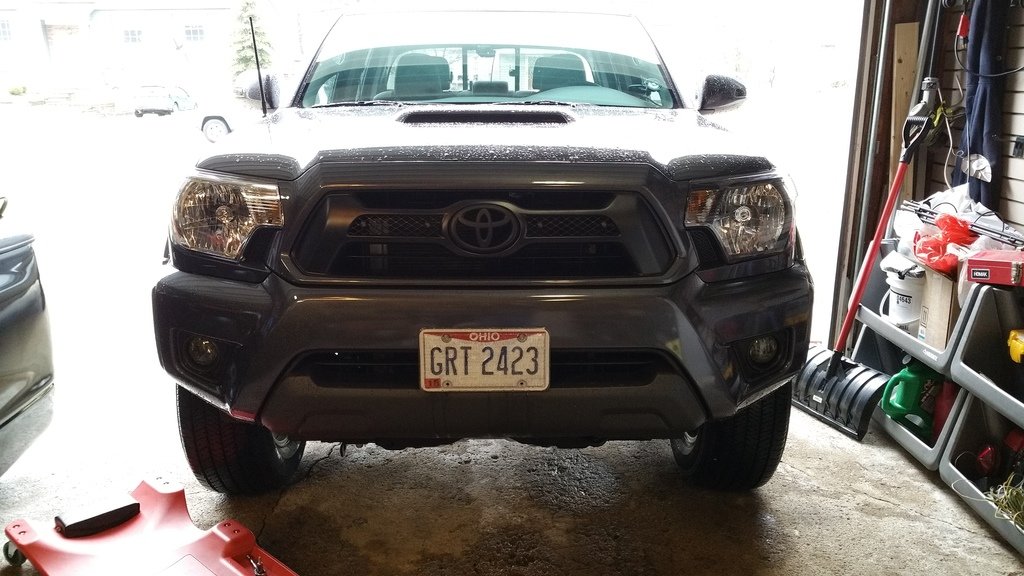

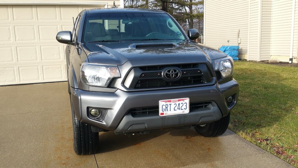

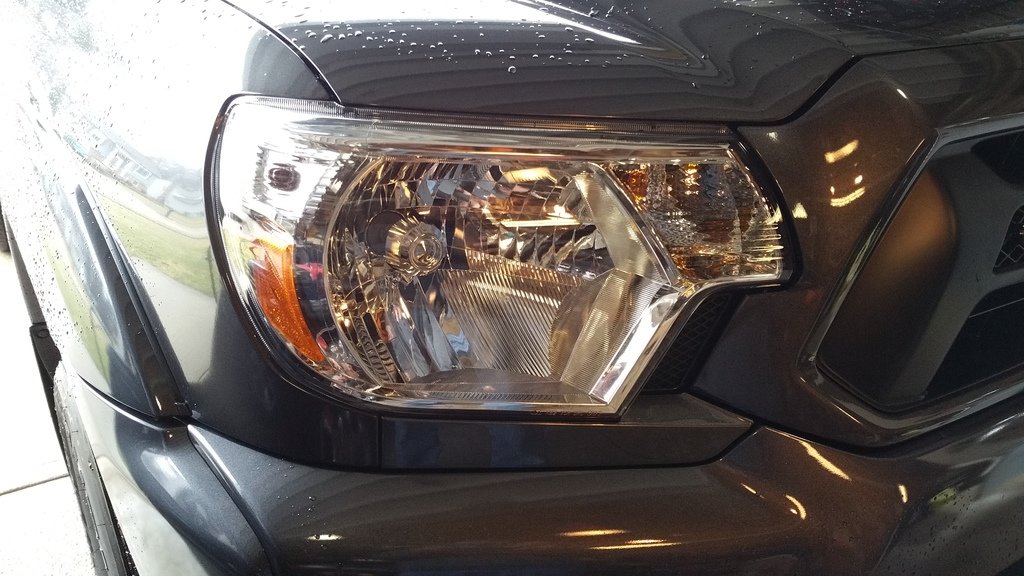

    Black Headlight Mod Success!!! Also sprayed the Yota emblem.
    Stock:
    Few Coats In.

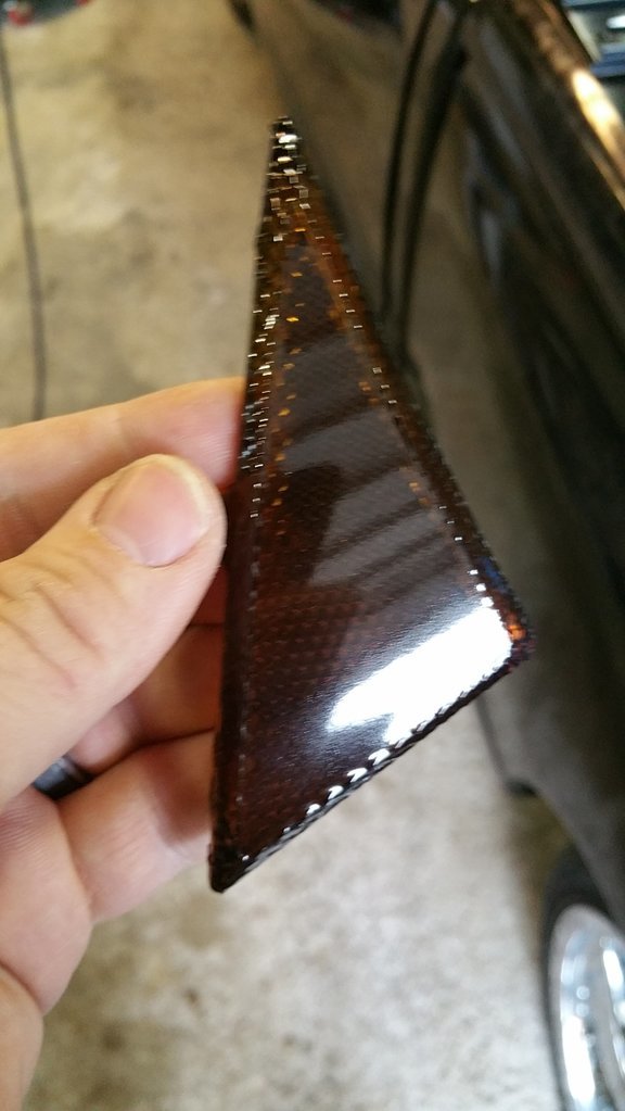

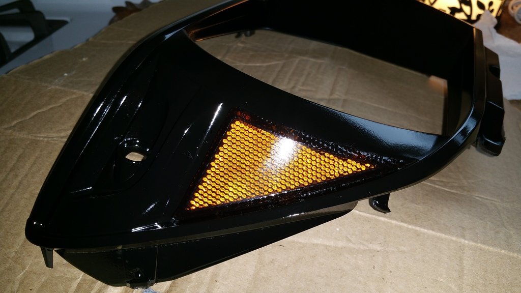

    Oracal 8300 wrapped the amber reflectors..'

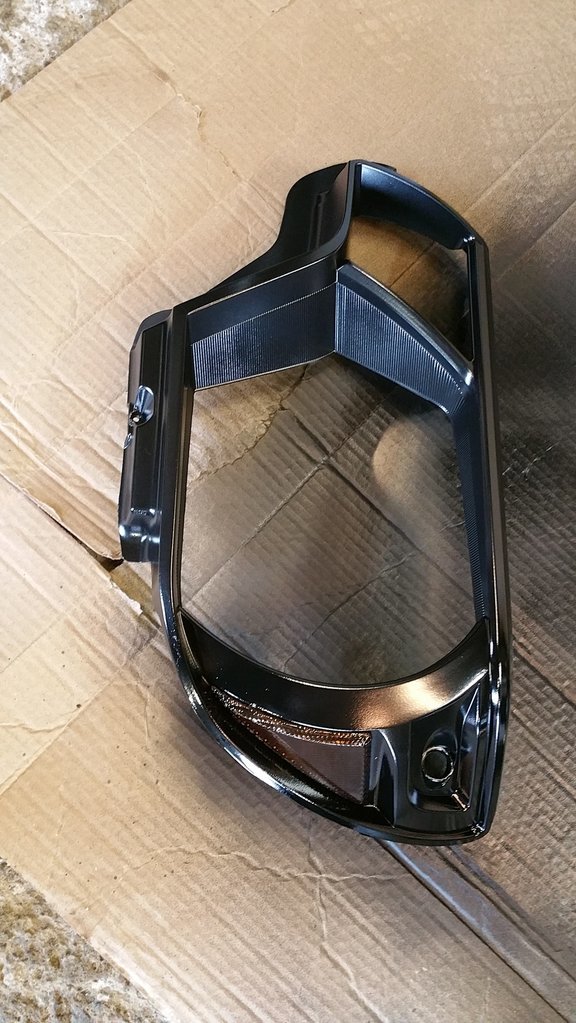

    One side done..

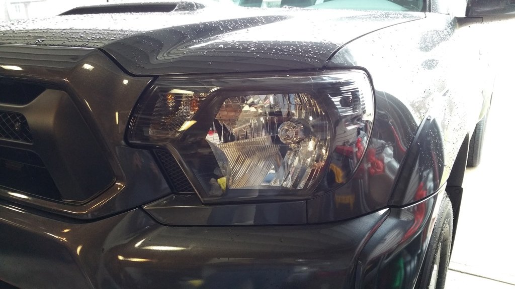

    Comparison..
    Done!
