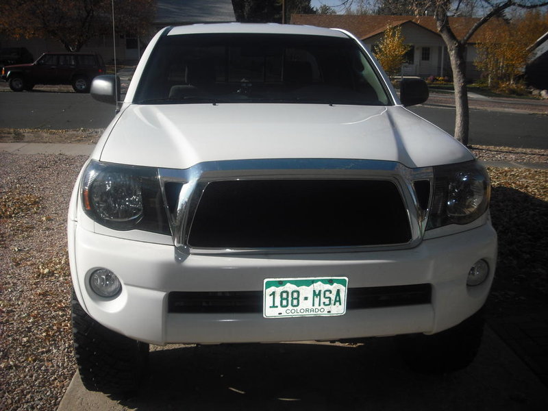

    167

    Finished my bhlm yesterday took 3 1/2 hours start to finish.
