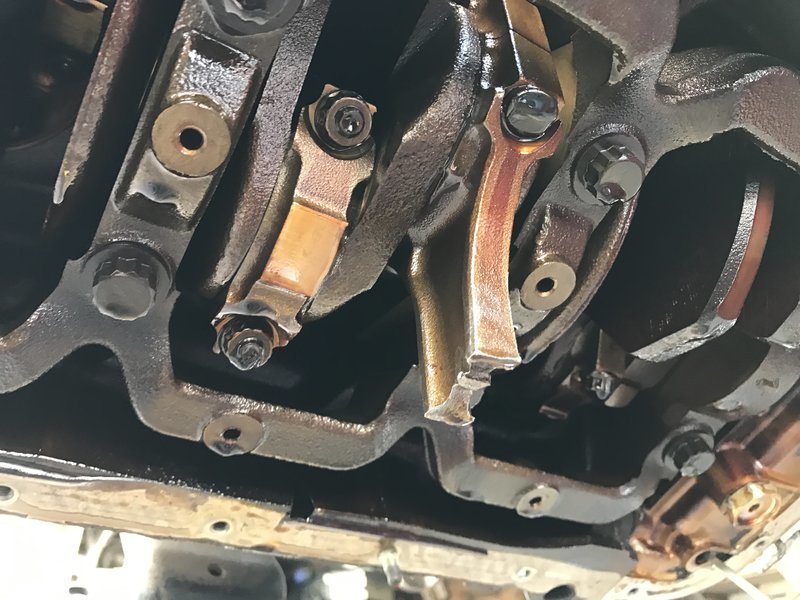

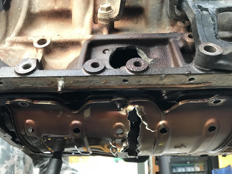

    Update: the engine blew a hole in the block when it hydrolocked.

    You call that damage? come on man! It's a 3.4, some JB weld and duct tape and it'll go another 300k.
    In all seriousness that's some nasty carnage....

    You windowed a block !!! , I've seen much worse damage than that and I've done that to many times I've lost count !!

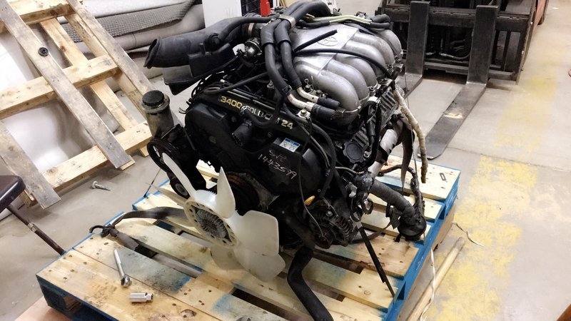

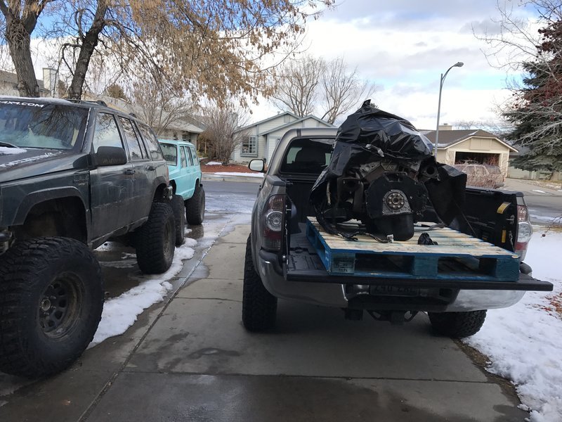

    The new engine showed up and is ready to go in.
    JoeT4R and 757yotas like this.
  13. Jan 19, 2017 at 7:23 AM
    #33
    ramonortiz55
    ramonortiz55 Not A Well-Known Member
    Nov 28, 2012
    #92013
    35,256
    Ramon
    Texas
    2015 DCSB Offroad 4x4
    stock
    did you end up going with a JDM?
  14. Jan 19, 2017 at 7:26 AM
    #34
    Paul123
    Paul123 [OP] Web-Wheeler
    Feb 26, 2016
    #179510
    822
    Paul
    Reno
    2014 TRDOR pyrite mica, 3" lift 33's, 4.56’s
    Yeah that's a jdm motor. It showed up exactly how it looks in the picture. All I did was pull it out of the taco with my forklift at work and unwrap the black cellophane it was covered with.
  15. Jan 19, 2017 at 7:30 AM
    #35
    ramonortiz55
    Nov 28, 2012
    #92013
    35,256
    Ramon
    Texas
    stock
    are these a full complete swap? or do you transfer/swap pulleys, pumps, etc?
  16. Jan 19, 2017 at 7:38 AM
    #36
    Paul123
    Feb 26, 2016
    #179510
    822
    Paul
    Reno
    It looks like everything would bolt right in. It came with a harness on the engine that the seller cut, but I'm going to remove that and reuse my old harness. I'm also planning on pulling the intake manifold and using my old one, mostly because I want to make sure the fuel injectors are the same 4 hole ones I currently have and I'll have most the manifold apart anyways. I left the ac with the lines still attached in the engine bay so I'll have to put that on the new motor (that way I didn't have to drain/refill it). I did the same thing with my power steering pump. Everything else I'm planning on using what came with the new motor.

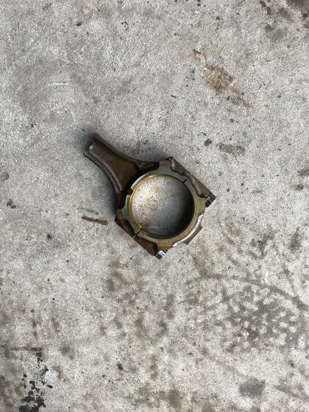

    Update: upon further inspection I found I broke a connecting rod in half.

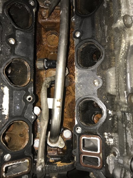

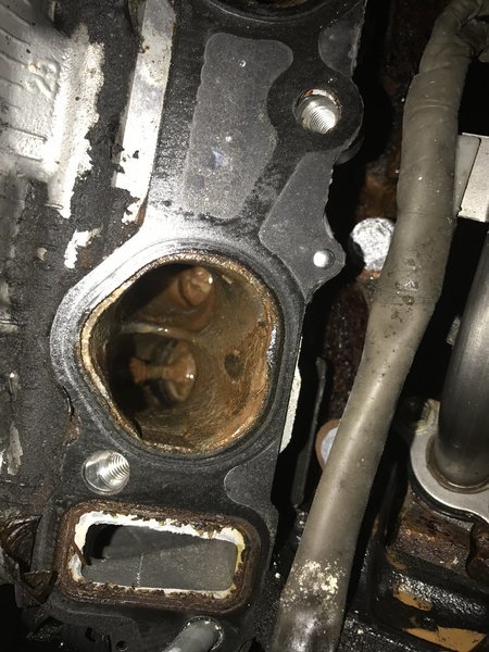

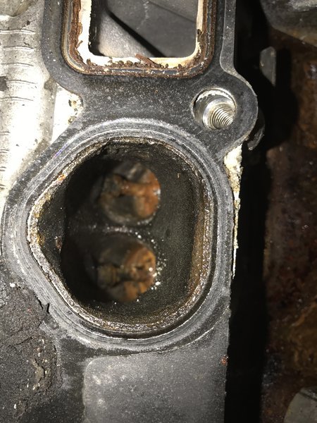

    This is what the inside of the new jdm motor looked like when I pulled the intake manifold off

    What would you guys do? Get a new engine from the same retailer? Send it back on sellers dime and have them refund you? Or run the engine with the rusty valves, rusty block, and standing water in the valley under the intake? There was more water standing in the valley than the motor I previously hydrolocked
