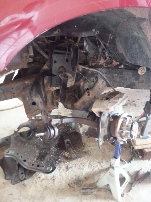

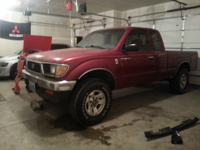

    All oils changed, VC gasket, front T-case output seal, park plugs, Fuel filter, new belts, steering rack boot, front brakes, flushed brake fluid, pulled master cylinder out and greased contacts, pulled driveshaft to repair zerks that had been sheared off, erased OEM body decals, and took misc. wiring out from all the equipment the PO had in it.
    I noticed the leaf springs were a little past worn out. Well, the worst frown I have ever seen. I wish I had taken pictures.
    I called up Wheelers and got the complete suspension kit with the 881's, Wheelers 5-pack, BPV relocation kit, 5mm trim packer, and original NitroChargers.

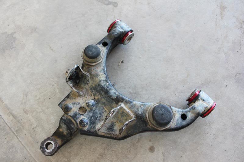

    While I had everything apart I decided the front end needed a refresh, so I replaced the control arm bushings (which can be found here: http://www.tacomaworld.com/forum/1s...replace-upper-lower-control-arm-bushings.html ), steering rack bushings, MOOG LBJ's, UBJ's, and shackle bushings.
    The R/L specific leaf packs combined with the 5mm trim packer do a very good job of leveling the truck side to side.
    Even after some settling, the driver side actually sits slightly higher than the passenger, but sits perfectly level with me in it (185lbs)
    Front torn apart:

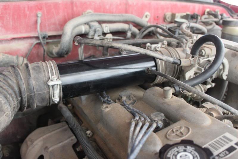

    Made an "intake" :p with a spare piece of exhaust piping and a plug I had:

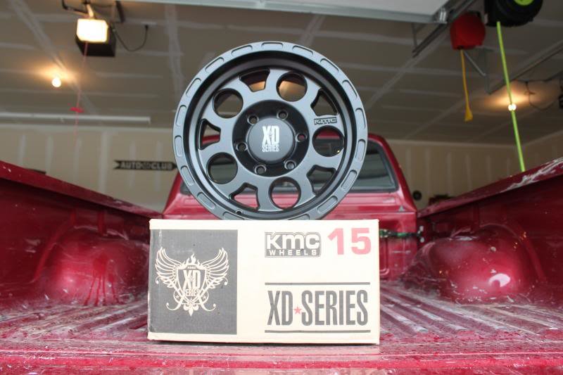

    Picked 4 of these XD Enduro 15x7 4.24" for $100 each with free shipping, lugs, caps, and stems.
    Still on the search for some cheap 33x10.50 BFG AT's.

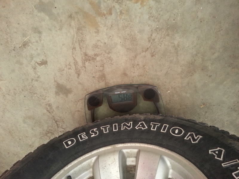

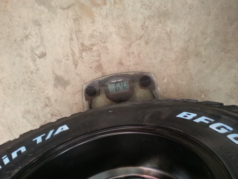

    Completely worn out 31x10.50 Firestone Destination A/T's on stock 15x7's:
    20130716_160438_zpsb777bc32_2222a905d7d8aff1d42e276065680c391e12ea97.jpgBrand new BFG A/T 33x10.50's on KMC XD Enduro 15x7's:
    5.4lbs per tire for much more meat is not too bad. The 4.24"BS fits perfectly with my setup also.

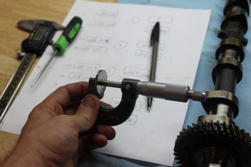

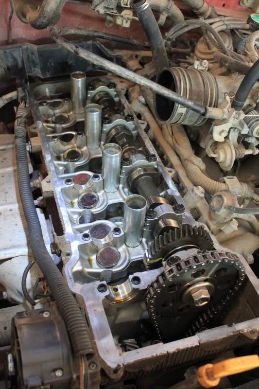

    At 250K my exhaust clearance specs were +double out of spec.
    Closest Toyota dealer is 115 miles away, so I ordered the valve shims from Toyota of Dallas @ $7 a piece.
    If anyone is curious they are 28mm diameter shims, and are sold from 2.50-3.30mm thicknesses.

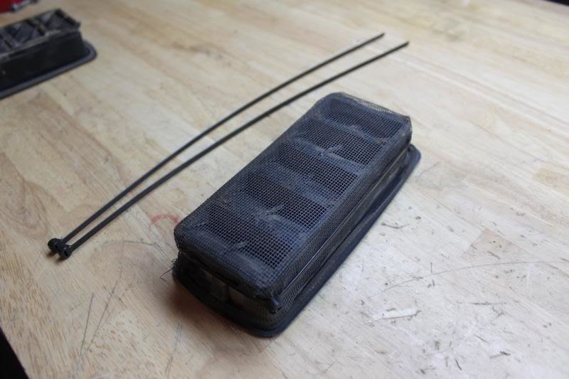

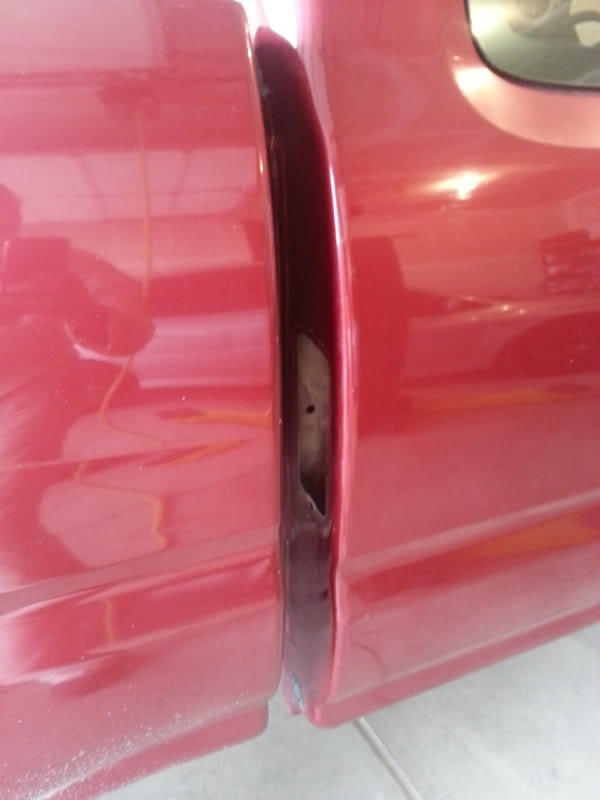

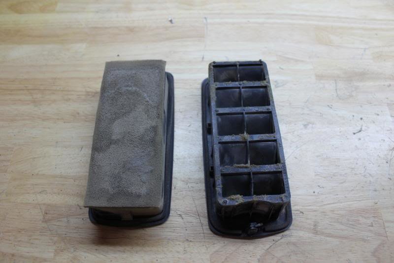

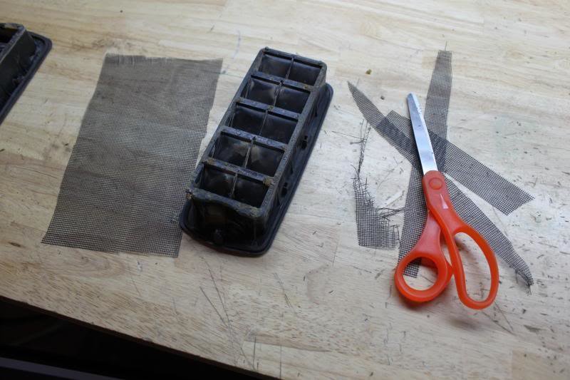

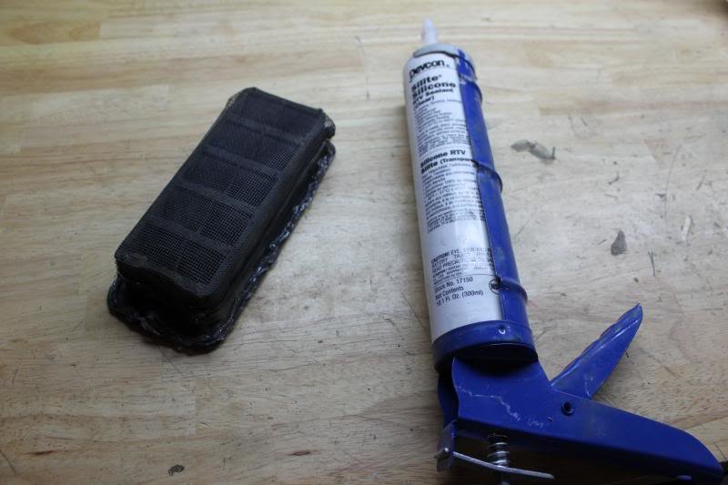

    Ever since new, I had a problem with my cab becoming VERY pressurized when the fan was on. I even noticed it when closing the doors.
    I eventually heard a high pitched whistle coming from the rear window area when the fan was spinning.
    I got out and the cab was becoming so pressurized that the third brake light was being pushed out and air was leaking past the seal.
    First I located the vents between the cab and bed, and then loosened the bolts holding the bed down so I could slide it back. All you need is a 12mm socket for the fuel filler nozzle and a 17mm for the bed mounts.
    To get the vents out pry on the bottom with a flat screwdriver. The top cannot come out first.
    The problem is resolved on the right. The left one shows the foam that gets COMPLETELY clogged with mud and dirt after 247k/17 years. I used a 90psi air nozzle on one side and could not get air to come out the other. All I did was peel the foam off.
    Although the vents have rubber flaps that should only allow air to vent one way (out) I though I'd add a little extra security against bugs coming in as the old flaps in mine were not closing all the way. I cut some screen from an old sliding door...
    Two 14" Zip Ties fit perfectly
    I added some sealant to the vents before installing because the worn out factory foam seal allowed the vent to not sit tightly against the body.
    The difference in air flow is night and day. I now can run my fan on "Medium", and get at least as much airflow as I did on "High" with the foam on the vents.
