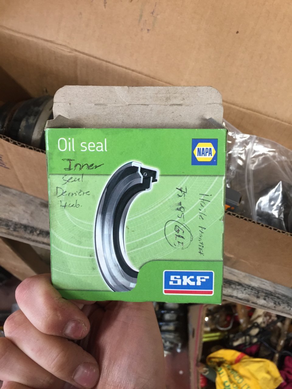

    There are two, one on the axle, and one on the hub, they get one in the other when everything is in place. The one on the axle is dealer only, the other can be found in auto parts store. I may still have the box of the one on the hub for the part# if you need

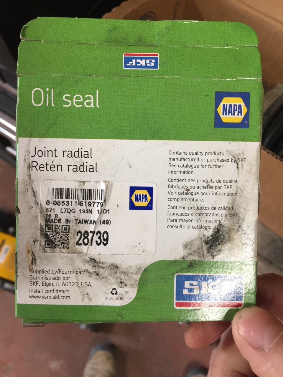

    Great! Ill get you the part# of the one that goes on the hub tomorrow if you feel like you want it. It is like 40$ I think.. expensive, but still, i think all seals on this truck are close to 40$ lol

    if you can find it that would be great. I would much rather have it on hand if I need it. if not it will go into the box of trucks parts

    There you go!

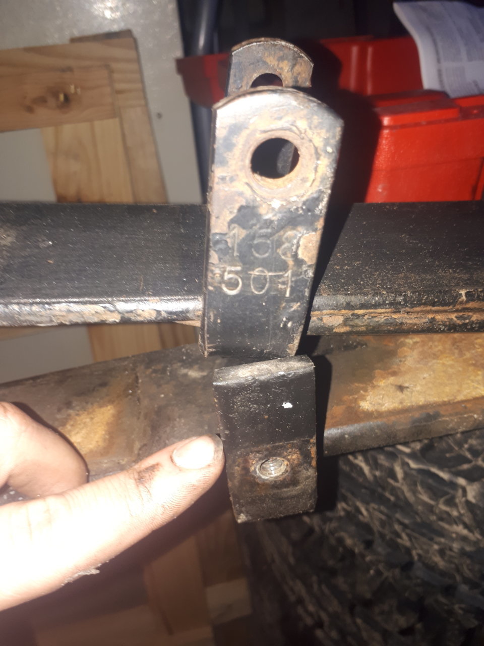

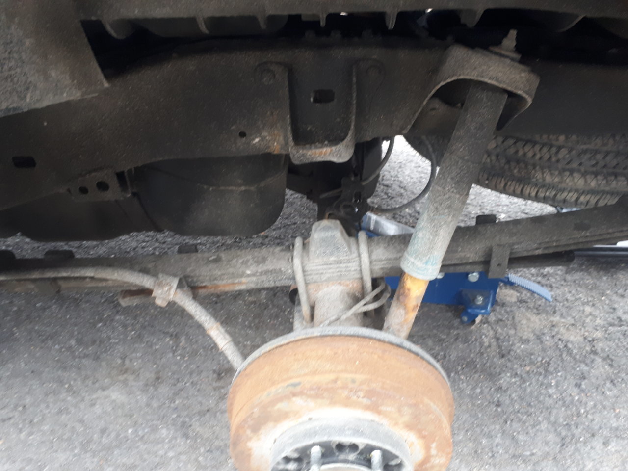

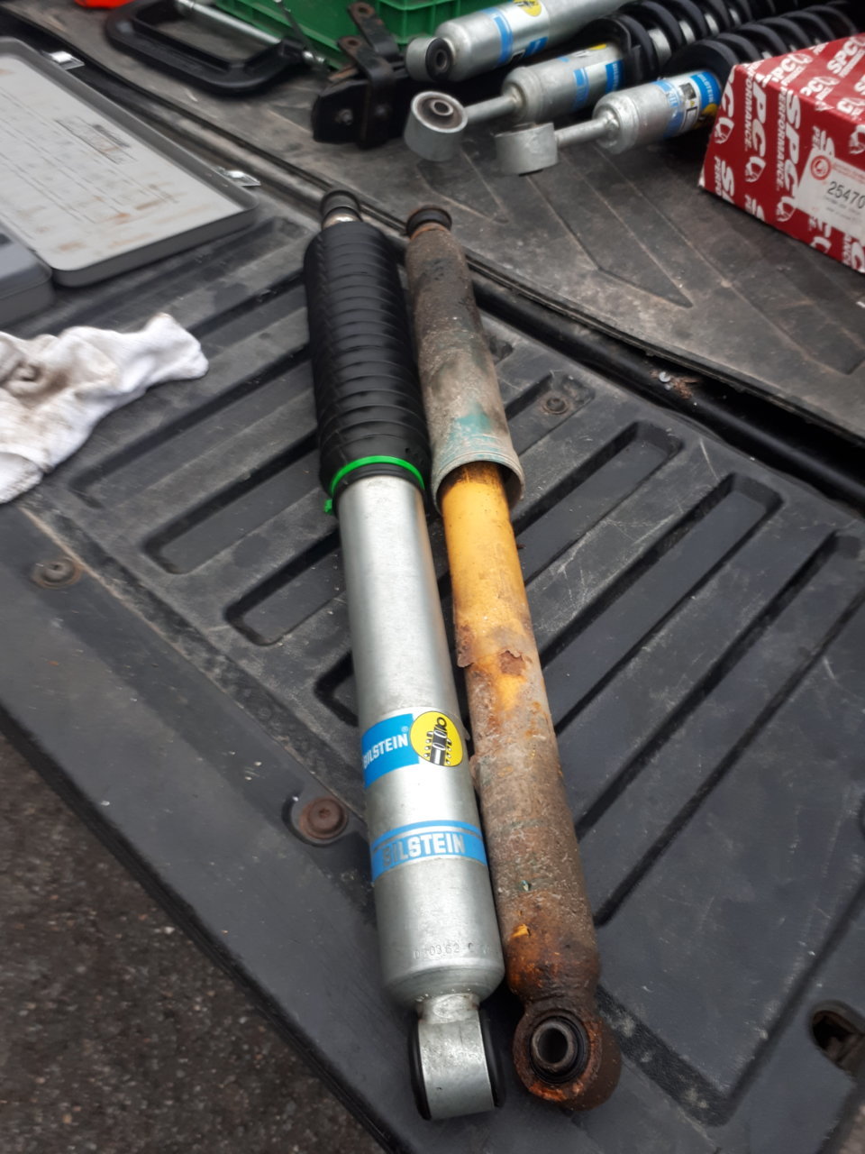

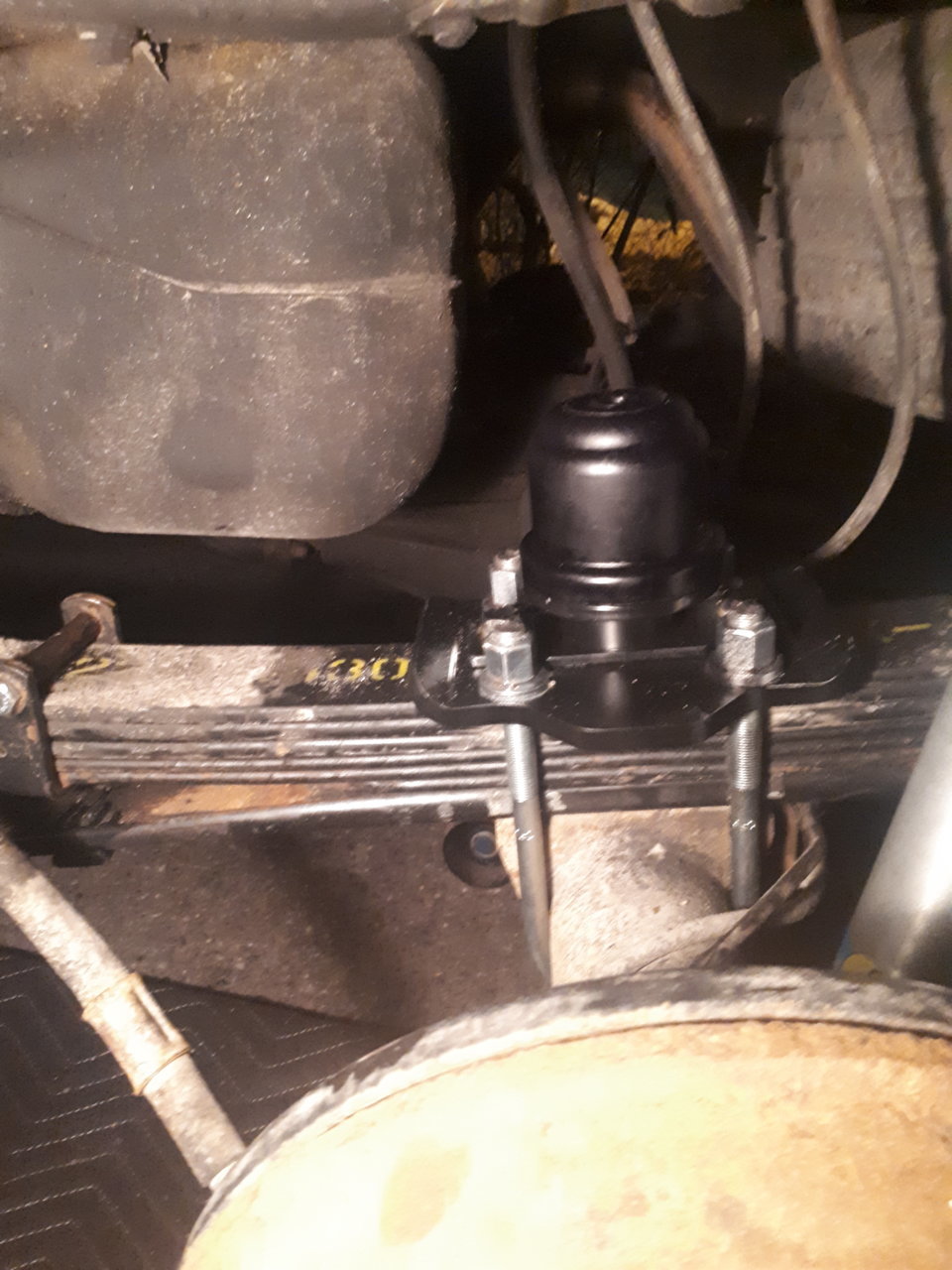

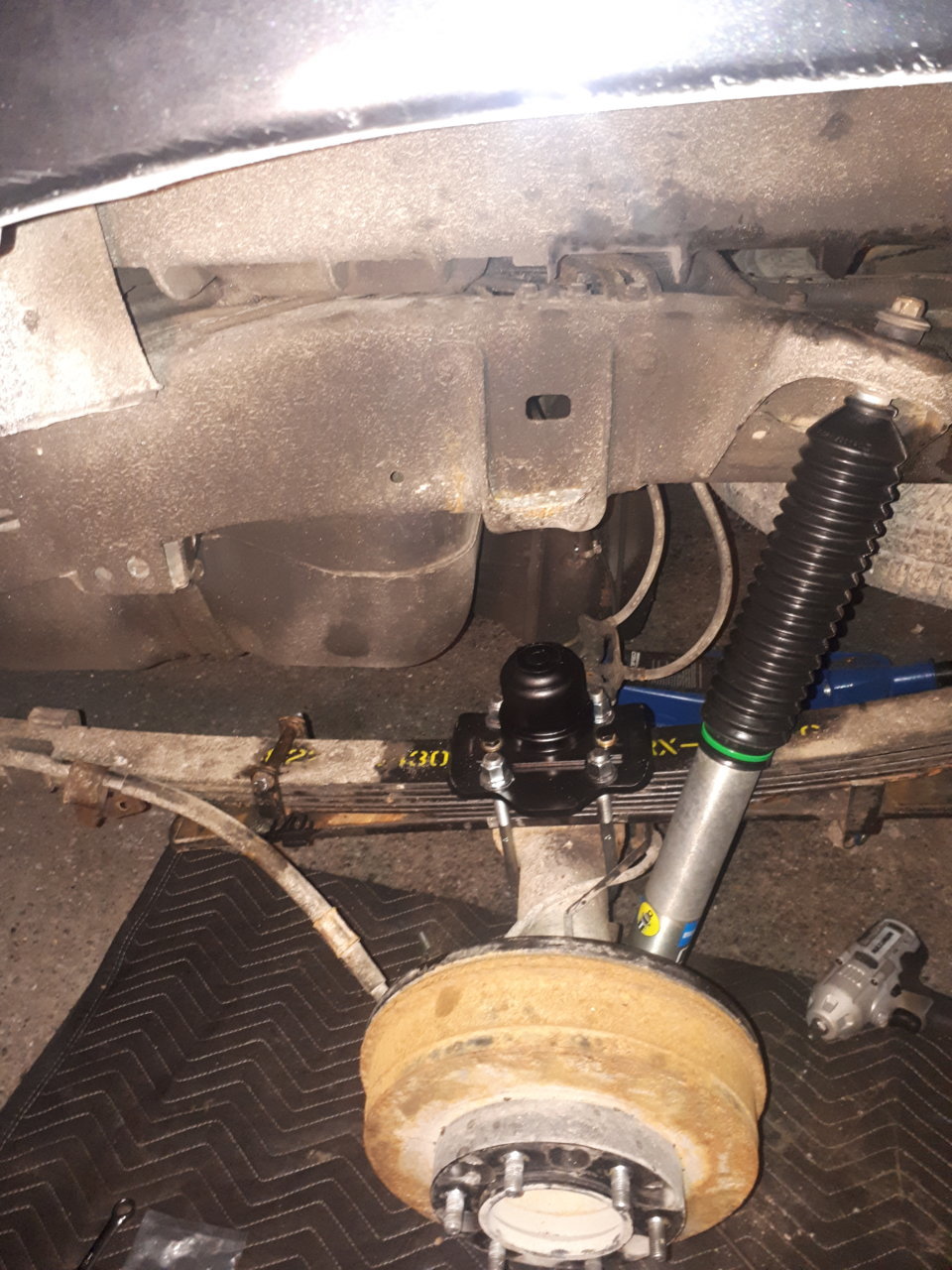

    Well, phase 1 of the lift is officially complete. I installed the rear lift. 5100's, 3 leaf progressive AAL, wheelers U Bolt flip kit and super bumps. Before measurement was 21.75" and I am now sitting at 23.75". Took me about 5 and a half hours to get it all done and buttoned up including set up and clean up. Finished just as the snow started to really come down.
    Before:
    Old vs New
    I chose to leave the overload spring in. Had to cut the bracket that I'm pointing at to make it work.
    Manfred, MarX, quis23 and 3 others like this.
