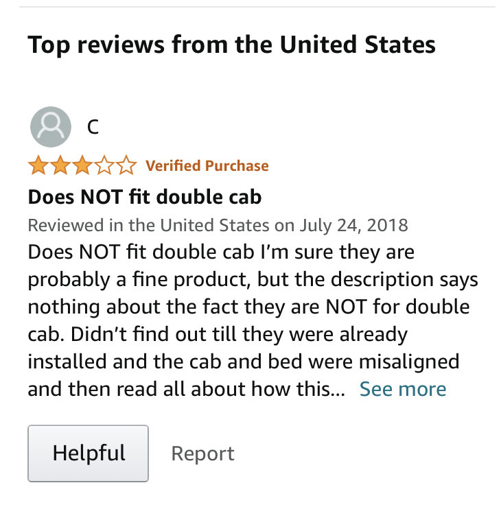

    I want to replace the body mount bushings on my '03 PreRunner Double Cab. At Energy Suspensions website, it states in the description "Will fit Standard and Extended Cabs".
    So, I did a chat and asked if they had a kit for the double cab model. I was asked how many mounts were on my truck and I stated 6 (2 for the radiator and 4 for the cab).
    Customer service agent came back a couple of minutes later and stated "mechanic said they should work".
    Before I order and pay $112, can someone confirm if these actually work for the double cab?
    I can't imagine them being different but I don't know.
    Thank you for your help / suggestions.

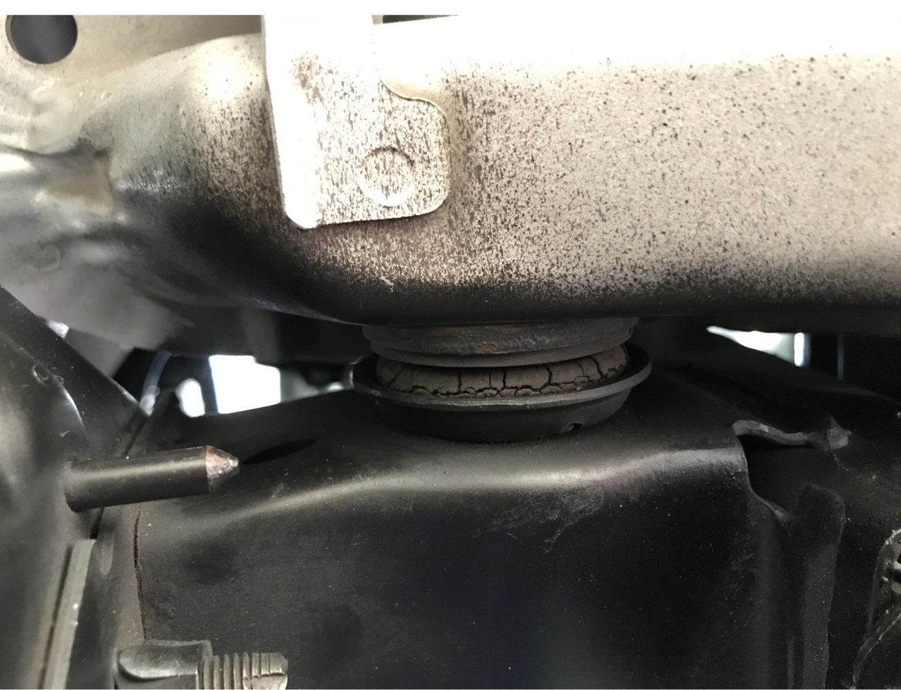

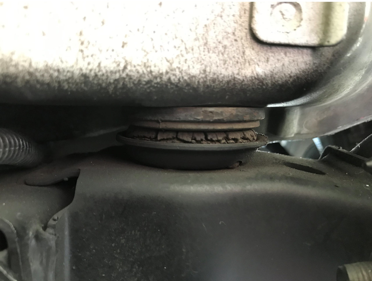

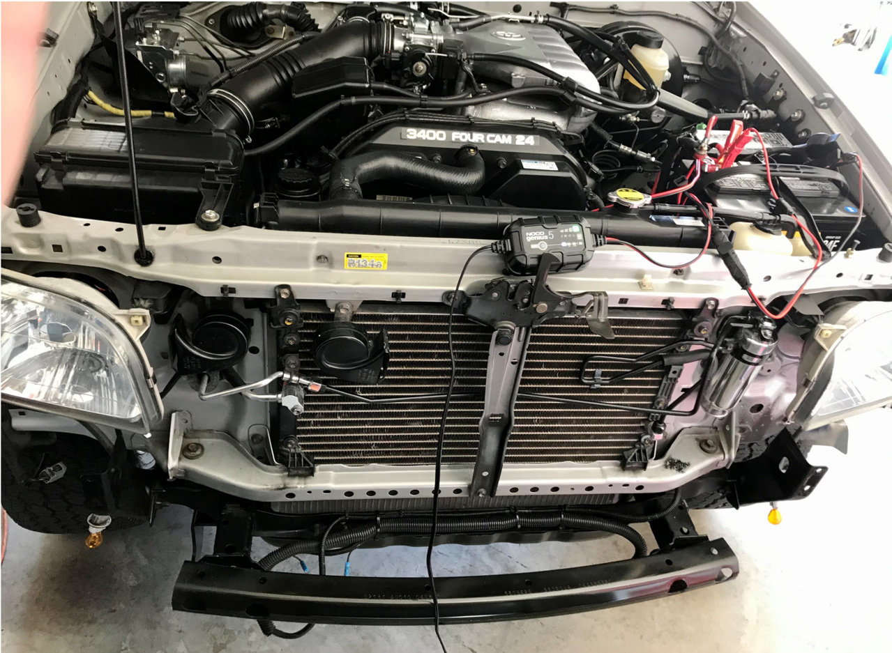

    Jay, I got a little carried away. Went to just remove the bottom piece that secures the turn lights so I can respray it and went ahead and took everything off!
    This provided a great view of the front cab bushings or what some call the radiator support bushings. You can clearly see the rubber appears to be shot.
    Patient hooked up to the iv bags
    Driver side
    Passenger side

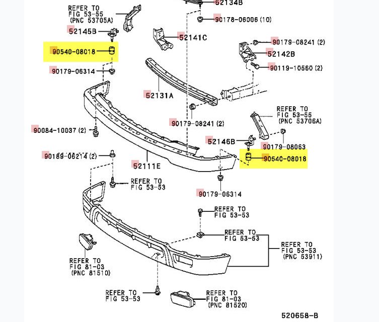

    @GQ7227 I forgot to add this picture yesterday. It's called a bumper cushion. I'll add this to my list of things to replace while I've got it all apart.
    GQ7227 likes this.

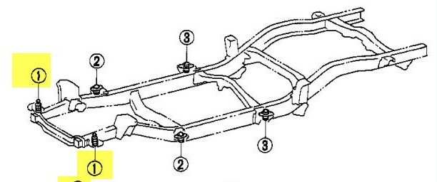

    That sucks. I just read your post again.........so the middle bushing (#2) will fit the rear (#3)?
  20. Dec 1, 2020 at 1:42 PM
    #20
    penadam
    penadam Well-Known Member
    Feb 25, 2019
    #284448
    187
    Denver
    2003 Double Cab Tacoma TRD
    It sure looked that way. I didn't test fit it in the truck, but I remember the energy suspension 2nd position bushing being taller than the 3rd, and it looked the same height as what (the 3rd) I'd taken out of the truck.
    On the 2nd gens, I know the energy suspension part # is the same.
    Here's the height of the factory 3rd position bushing. Maybe someone can measure the energy suspension ones or a factory 2nd position one.
