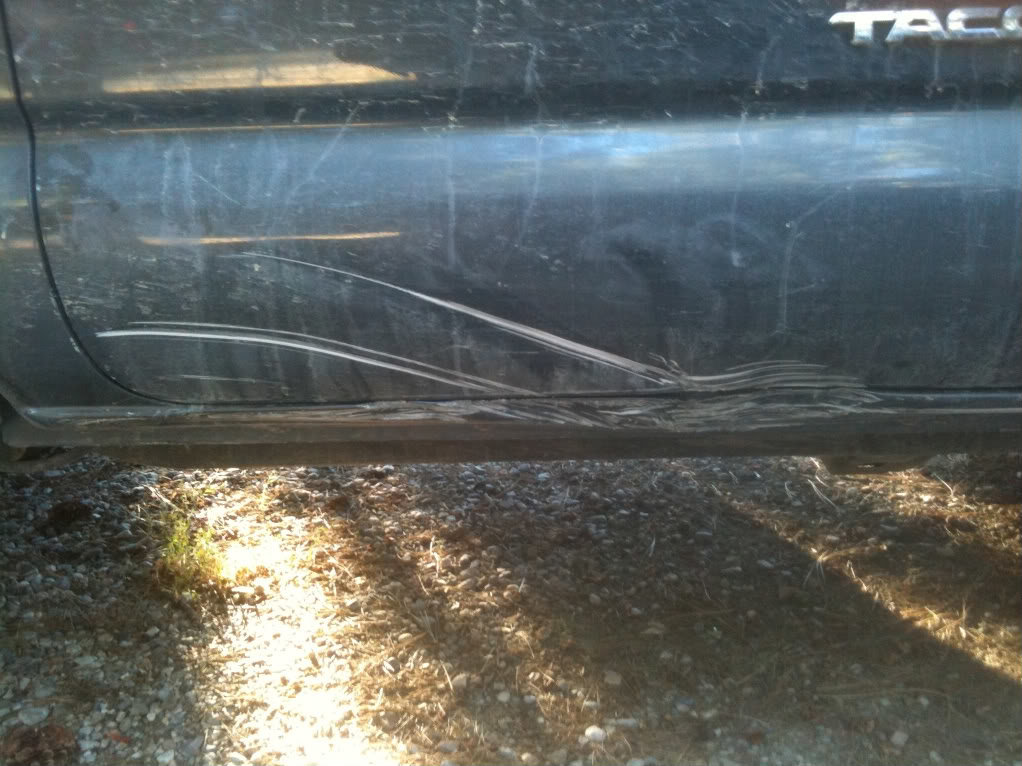

    not as expensive as rocker damage...

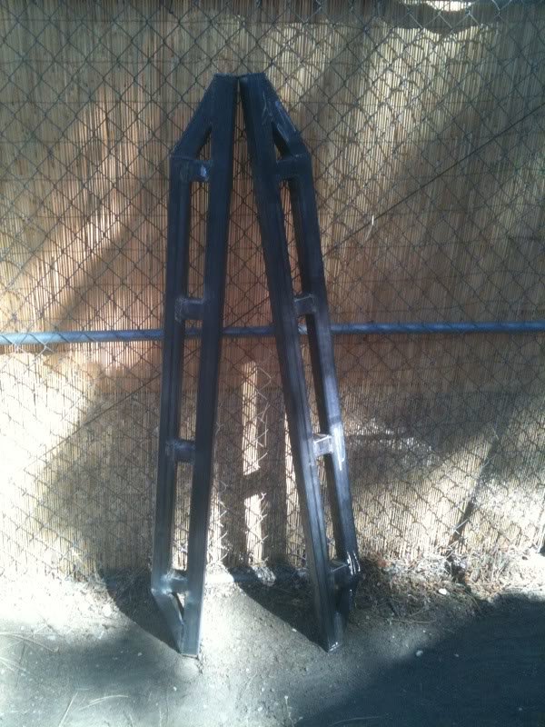

    i made my own... square tube seems to be the strongest. if you do dent them (i havent come close to denting them) they will retain structural integrity better than round. you put a dent in round and it ruins the whole structure of the tube.

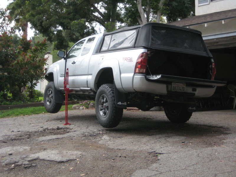

    Actually your right, sorry, that picture was before my rear swingout, full skids, onboard water tank, etc....right now she sits at 1800 over weight. But I have lifted her up on ths sliders as she stands now and they dont move.

    with 4"x4"x3/16" mounting plates it covered 3 or 4 big holes that were stock on the frame...
    welding to the frame will not weaken it when welding 3/16" of beef to it. Take a close look at the stock frame. its welded together. If toyota isnt worried about welding the frames together why would welding steel plates to the frame hurt it?
    Look at first gens. They say if you wheel hard you should weld frame supports to the rear of the frame.
    all the vendors recommend welding to the frame for serious offroaders.
    Do whatever you want but for something you dont plan on removing and want to be the strongest you can, welding is the way to go.
