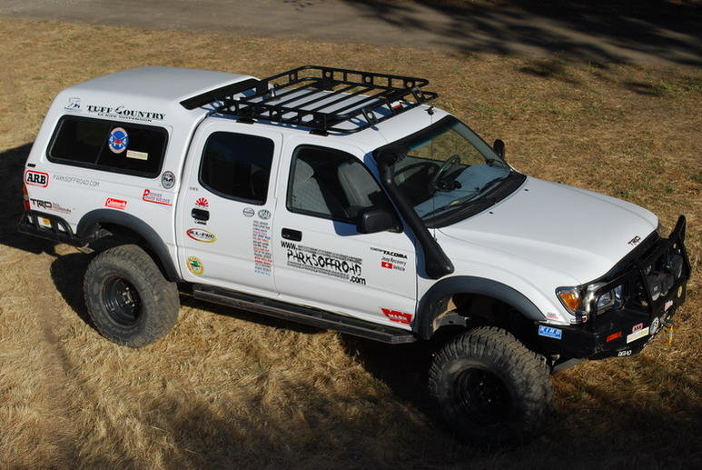

    Rocket has anyone in your group ran a roof rack?Im thinking of putting a Defender roof rack on mine,if so had anyone said they hear wind noise.
  9. Aug 10, 2011 at 2:54 PM
    #249
    Box Rocket
    Box Rocket [OP] Well-Known Member
    Mar 1, 2010
    #32389
    7,184
    Adam
    Syracuse, Utah
    1995 FZJ80 Land Cruiser
    3xLocked, lifted, well used
    Only Tacoma that I get out with that has a roofrack on the cab is Kurt at Cruiser Outfitters. He's using a Front Runner low profile rack. I know that he did a bunch of the R&D work on the mounting feet and actually fabricated them, but I think they are now sold as an option through a Front Runner dealer. Check with Equipt Expedition Outfitters for availability on the feet and rack.
    If I were buying a cab mounted roof rack it would be this same set up. But I will probably end up building my own.
    I haven't heard any complaints from him on wind noise. He has as ARB awning mounted to it, and is also running a Front Runner bed rack for his ARB roof top tent. Awesome setup and one of the best equipped Tacomas around for sure.

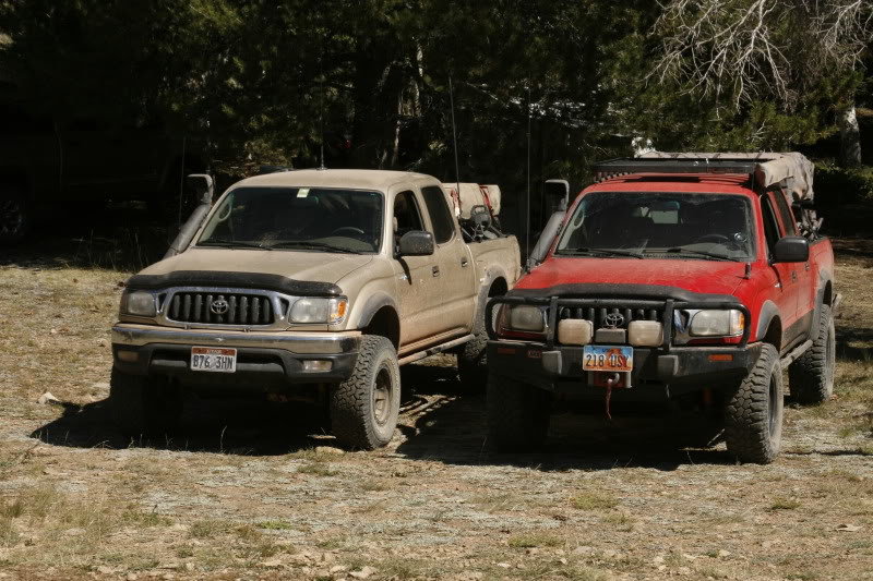

    Im getting ready for this years Baja trip,looking at the elite bumper,Ive got the same OME kit with 882,my question is whats the red truck running up ft and what did the ARB bumper and winch do to it?
  13. Aug 10, 2011 at 8:14 PM
    #253
    Box Rocket
    Mar 1, 2010
    #32389
    7,184
    Adam
    Syracuse, Utah
    He's got the same suspension I do, (or I should say I have the same that he does, since he sold it to me). 882's and 10mm spacer up front. He's running 32x11.50s. But has much more weight up front than I do. The ARB bumper, a Warn winch, Budbuilt skids, supercharger, dual batteries, hot water shower all in the engine compartment all add to the weight up front. My guess is he's still in the 2"-2.5" range up front.
