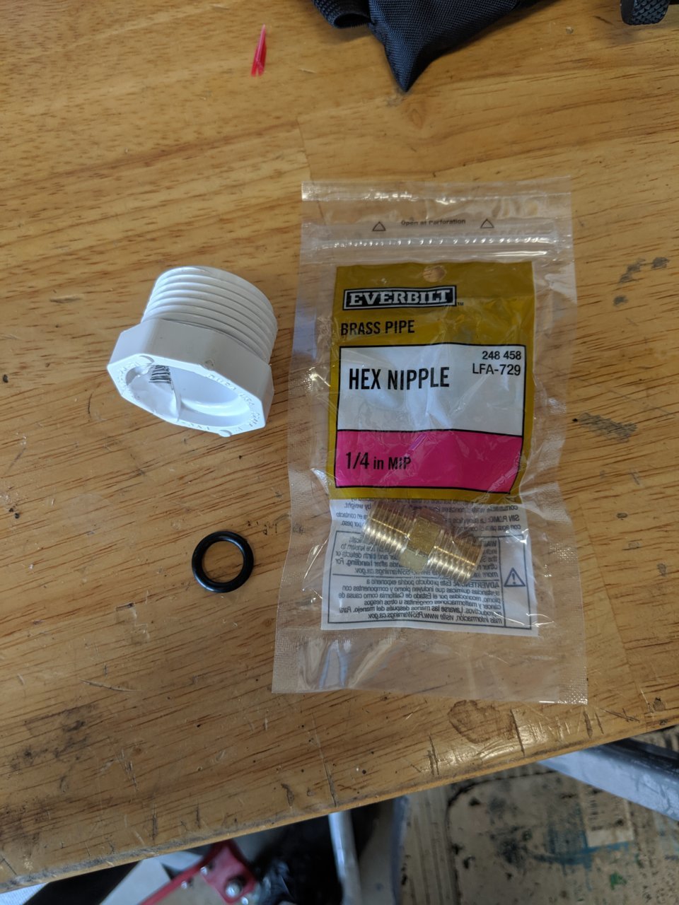

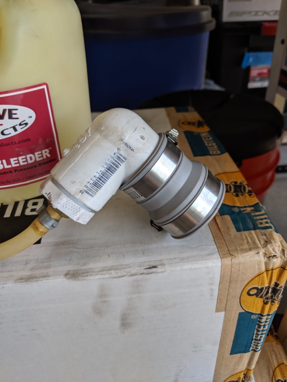

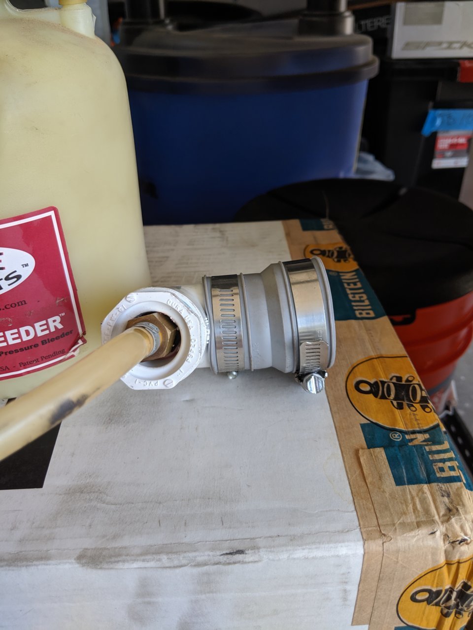

    UPDATE:
    Ended up making an adapter for the Tacoma and Power Bleeder. Worked much better than trying to teach the wife how to pump the peddle.
    My method was to fill the resivor up to the top and pump the bleeder up to 12 psi. Bled each wheel and even tapped the caliper a few times with a hammer (mtb trick) to get all of the bubbles out.
    Alllllll fixed. Thanks for the all the info!!
