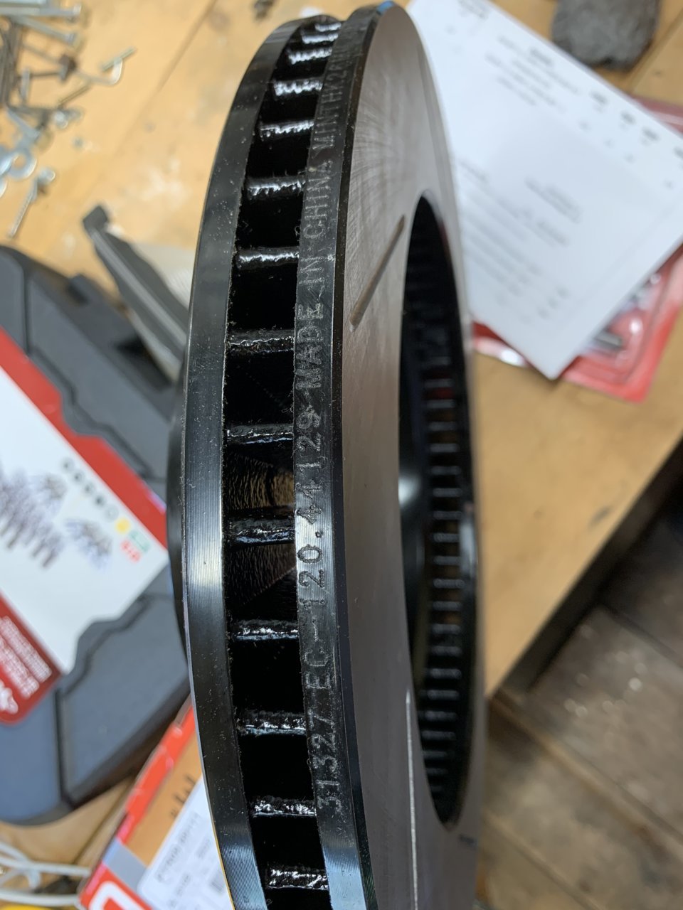

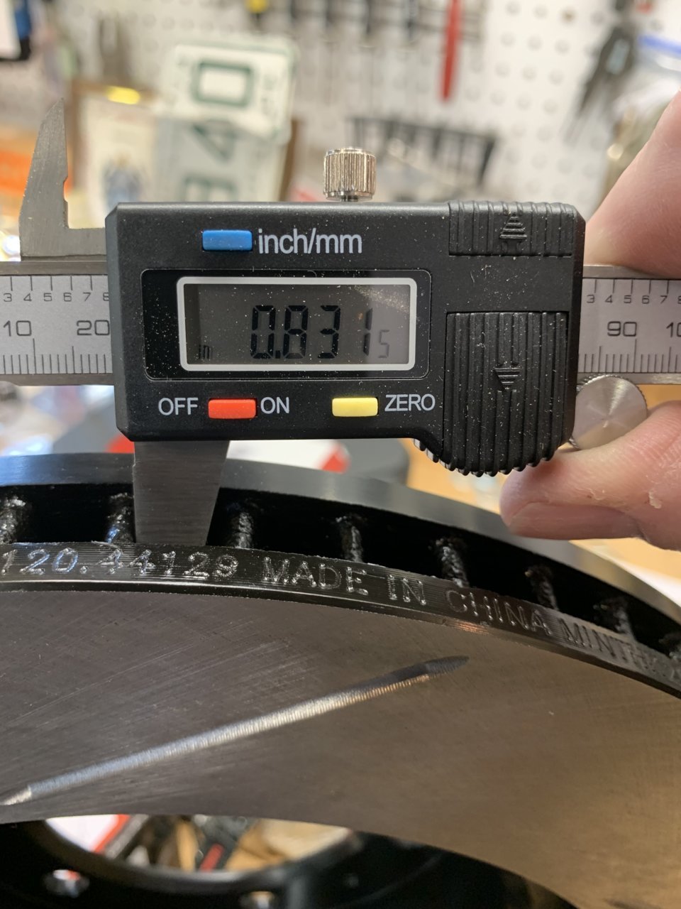

    Apologies for taking so long...
    I couldn’t get an accurate weight on them but they felt lighter than the ones I got a couple of years ago.

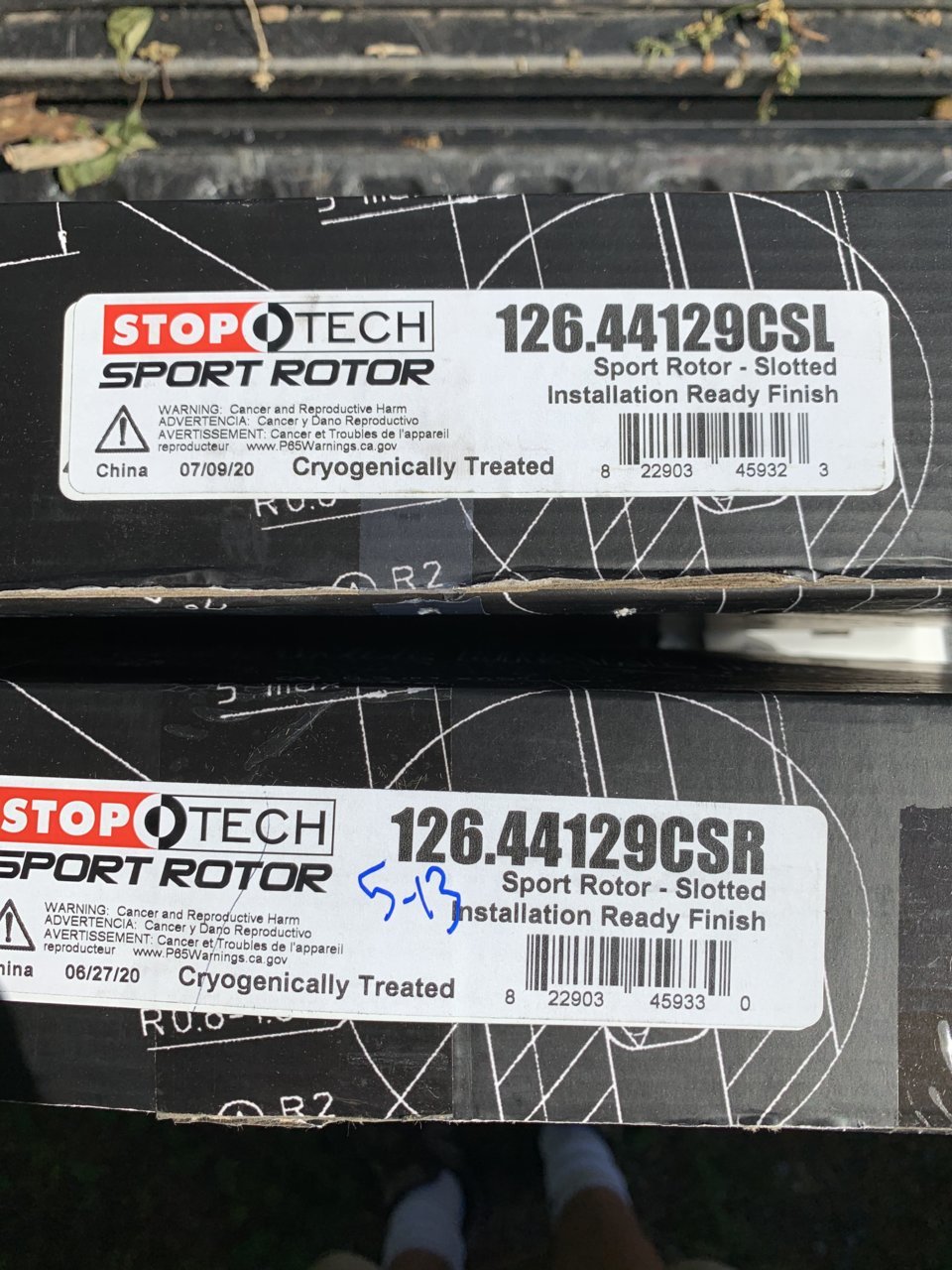

    @crashngiggles just waiting on the new Rotors and pads and this is what we will be changing over to sir.

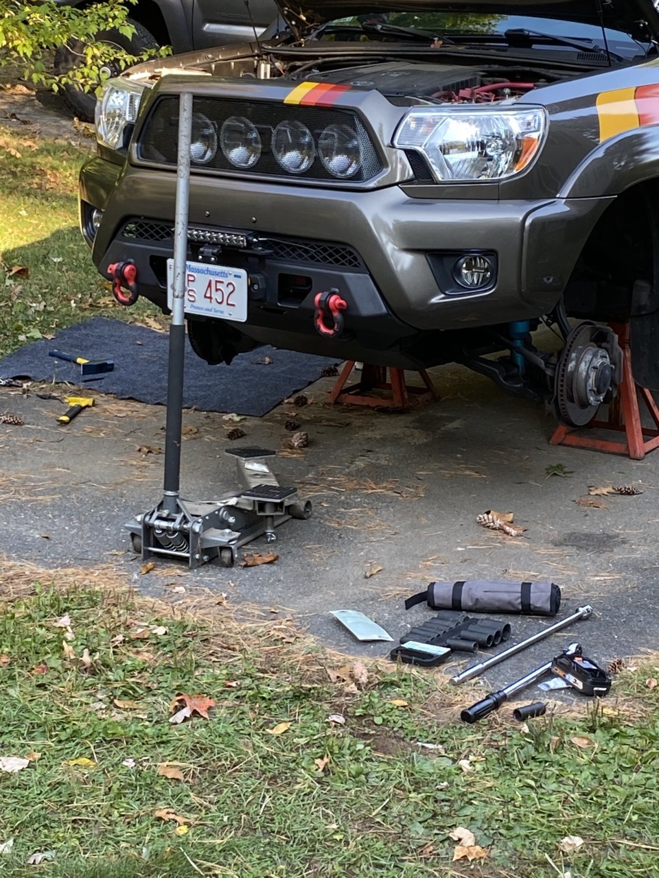

    And so it begins
  16. Oct 10, 2020 at 7:10 AM
    #796
    Unchained 5150
    Unchained 5150 Rick
    Sep 25, 2014
    #139054
    65,355
    Rick
    Auburn Ma
    2021 TRD Poser Pro Manual.
    Pins on the passenger side royally sucked to get out as the last place that did them bent them putting them in. Drivers side popped right out. Now it’s time for a brewski with my friend @crashngiggles
