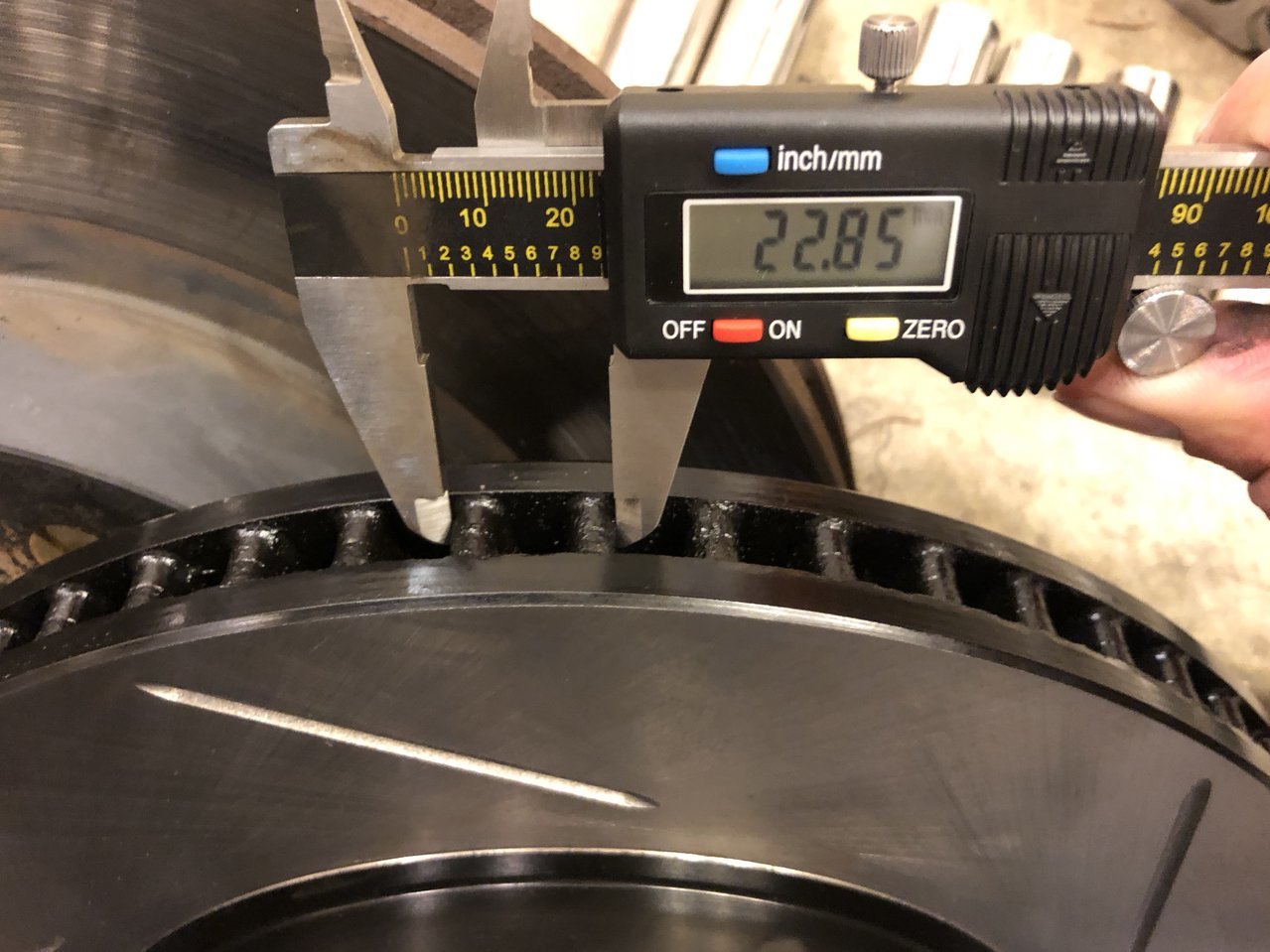

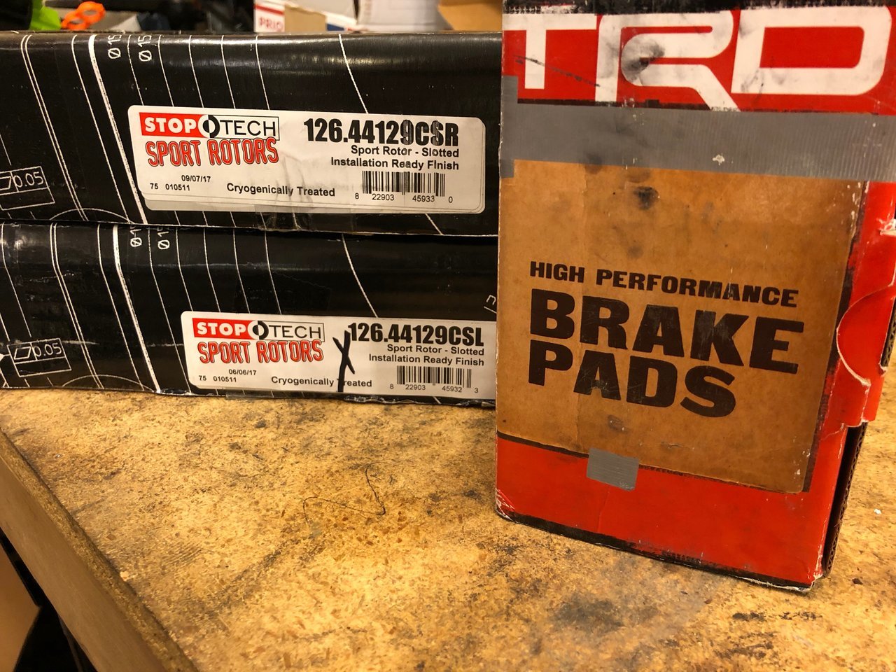

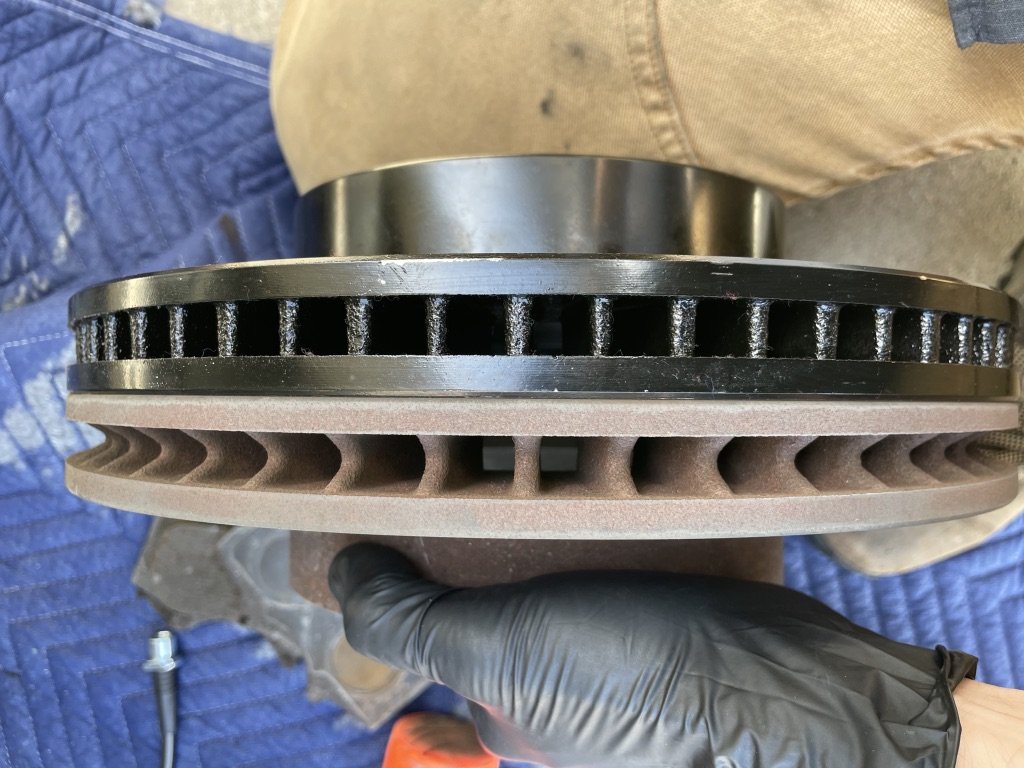

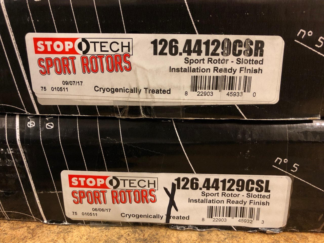

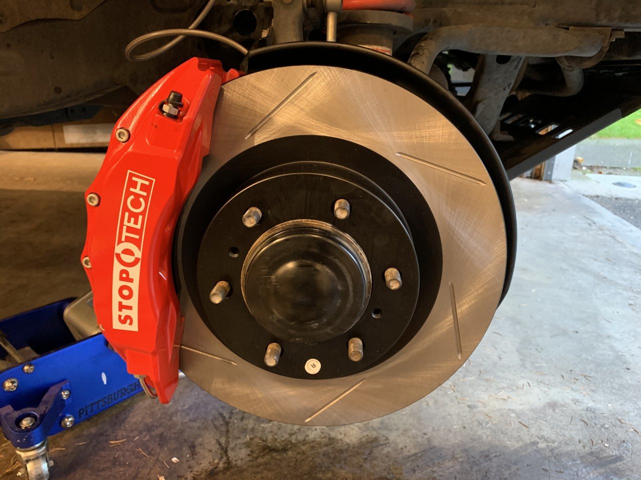

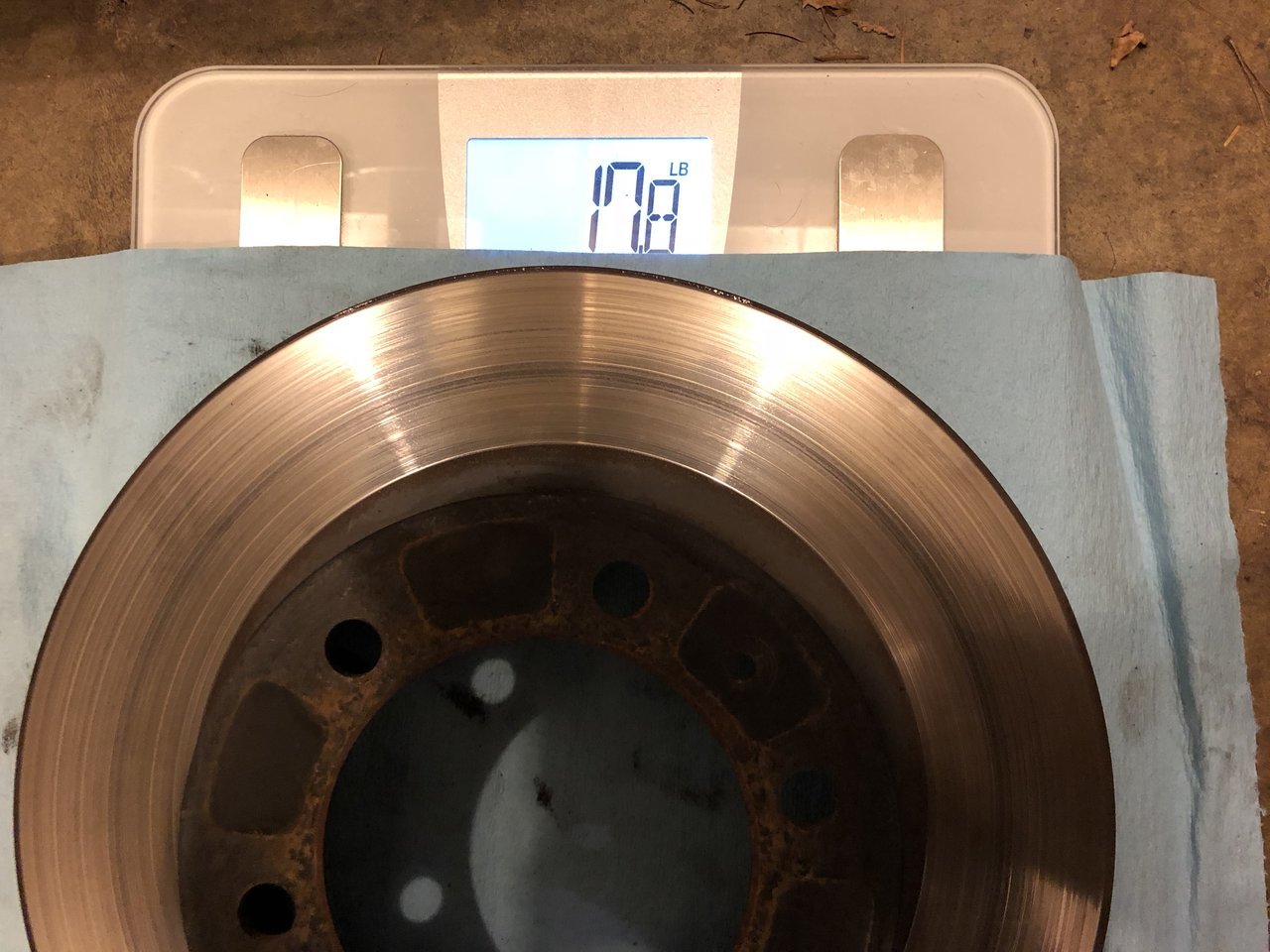

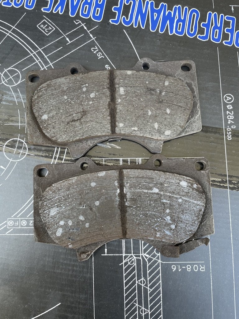

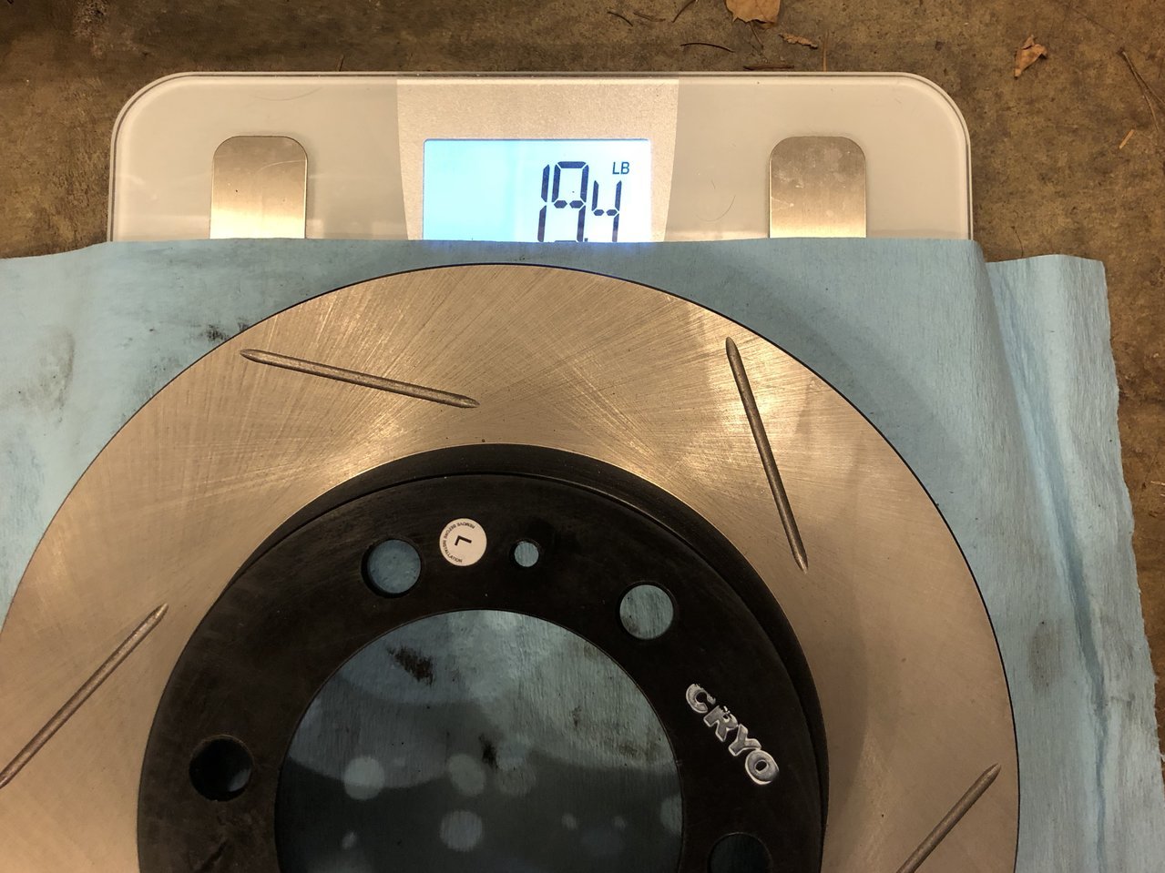

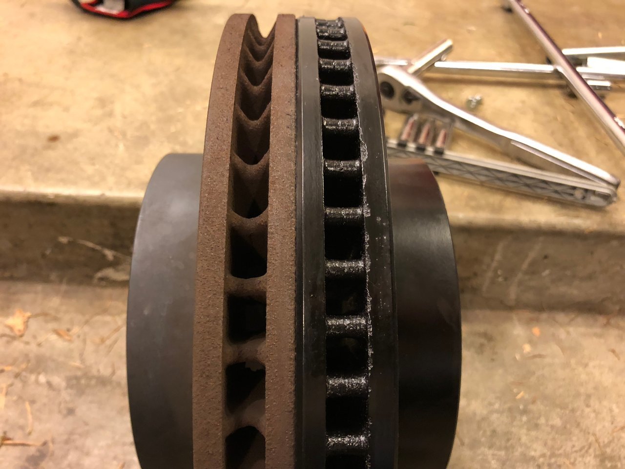

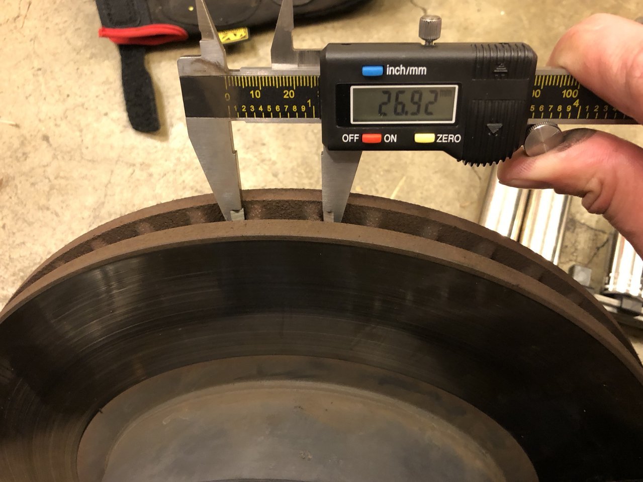

    Just got my brake upgrade finished and took a 4 day off-roading/camping trip through the desert - everything worked great! I was really nice to get rid of my old setup that had terrible vibrations. Figured I'd chime in to re-confirm what's currently being shipped for the StopTech rotors.
    I purchased the cryo version with part number: 126.44129CS. They're beefier than stock in pretty much every dimension so it's no wonder they handle heat better.
    Old rotors weighed 17.0lbs
    New rotors weighed 18.2lbs
    My old pads weren't looking so good.

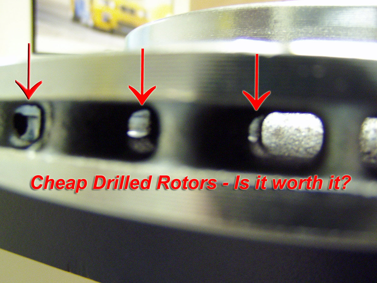

    1. is there any real performance gains or improvement in longevity w/ Cryogenic Treated option ... is it worth it?
    2. same question regarding the Centric High Carbon option?
    3 thoughts on Centric Premium Pads & Shoes vs. other aftermarket options?

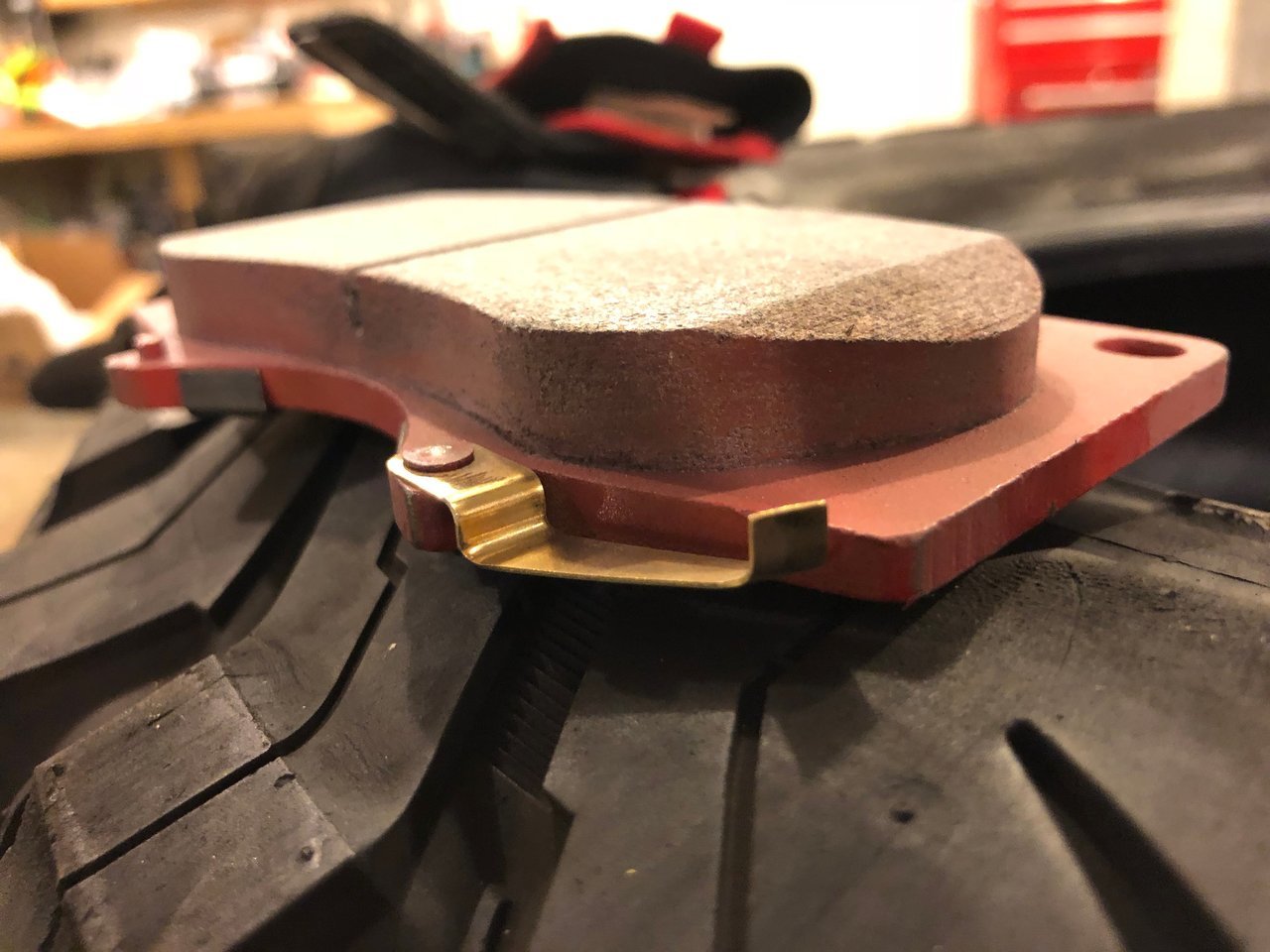

    Ryan, Ryan, Ryan. It’s too late. Next week I am installing stop tech rotors and TRD pads that I ordered three months ago. Thanks anyways.

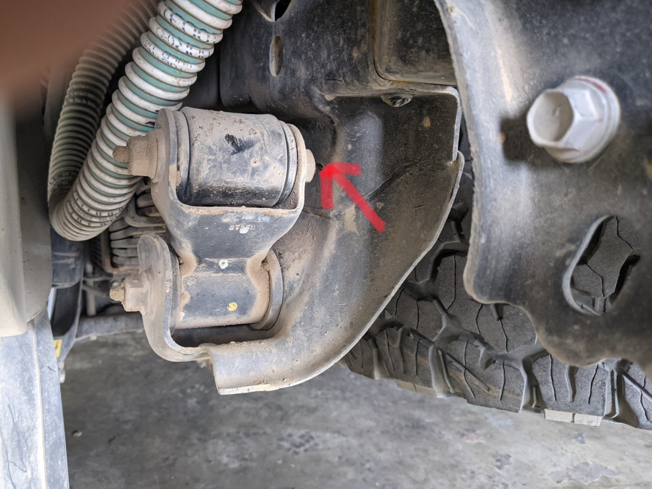

    But seriously thank you for the suggestion on the Archive hangers. Yesterday at the shop it was pointed out that one of the OEM hangers was bent and rubbing on the frame so we’re installing the archive hangers as per your suggestion
