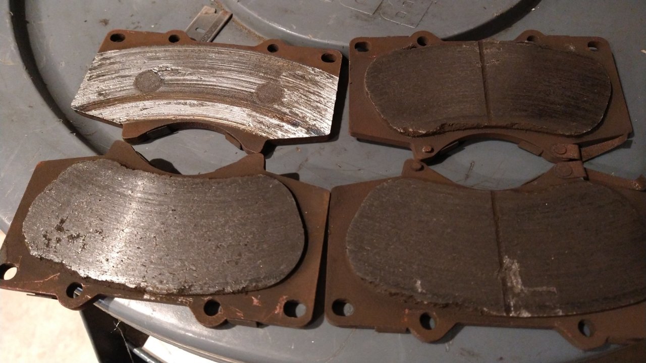

    Here is my recent experience with Stoptech and TRD pads. This past weekend I did a 750 trek to and through Death Valley. Day three I started hearing a slight grinding noise and we were already on our way to Beatty Nevada to top off on fuel. I had put these on my truck about 25k miles ago and looked at the pads prior to the trip. So when I got to Beatty my left front inner pad had come off the metal and now I was metal to metal.
    So now I am 100 miles from any auto part store and my truck is not drivable. A resident of Beatty who happens to race cars came to my rescue by helping me make a pad from a Corvette pad that he had in his shop and then I was able to continue the trip.
    Looking back I would have never bought the TRD pads and will never use them again. My rotor got chewed up on the inside but I was able to get home and now I was able to get a racing pad from Porterfield Brakes here is SoCal and had new pads at my doorstep in a day. Lucky me a local car repair shop Hilltop Auto Repair re-surfaced the rotor for me for free and I was able to install the new pads last night. Did I mention they re-surfaced it for free.... Shout out to them nice people.
    So I learned alot about the brakes on the 2013 TRD as the use the same pad as the Tundra according to Porterfield. I was thinking I needed to do the caliper update but I just need a pad that can get really hot.
    The person I met in Beatty suggested a pad that could get up to 1200 degrees. Since I don't want to drive around town riding the breaks to get them hot I opted for the R4-S pad from Porterfield

    So I am not the only one. My first set of TRD pads lasted 4-5 years, worked flawlessly. My second set of TRD pads lasted 6 months, total pieces of shit. Same exact experience. Started chipping and falling apart, grinding like crazy. I replaced them, resurfaced the rotors, brakes are perfect now. There definitely is shitty knock-off TRD pads out there, and they suck big time.

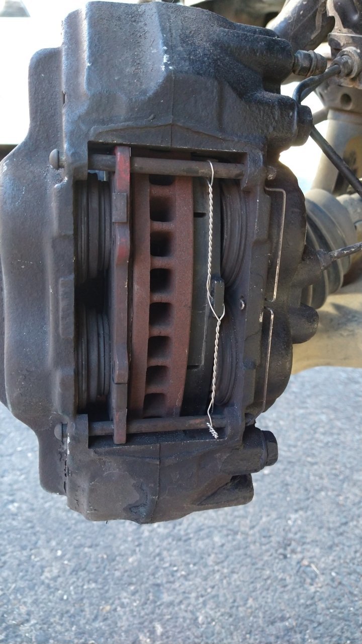

    It's good to know all of this. As a mild-aside from the topic: If you find yourself in this situation anytime in the future, you can just pull the caliper off, and if possible put a block of something between the pistons and tie it off to some structure. It isn't ideal but it'll let you get out of a bad spot.
    I've never thought about carrying spare pads before, but I can see the benefit to it now considering the types of long mountain downhills I'm likely to encounter. Good stuff (from bad stuff). Glad you got out okay!

    Thanks, yea never knew I could just make a pad, but I did look at the pads and thought they would be fine for a few hundred miles, not thinking the pad material would just come off the plate. Ended up doing 700 miles total driving in 4 days, but the pad still should have not failed. Now I will always have a spare set, but make sure there is plenty of pad for the long downhill drives. looking back I should have just replaced them before I left.

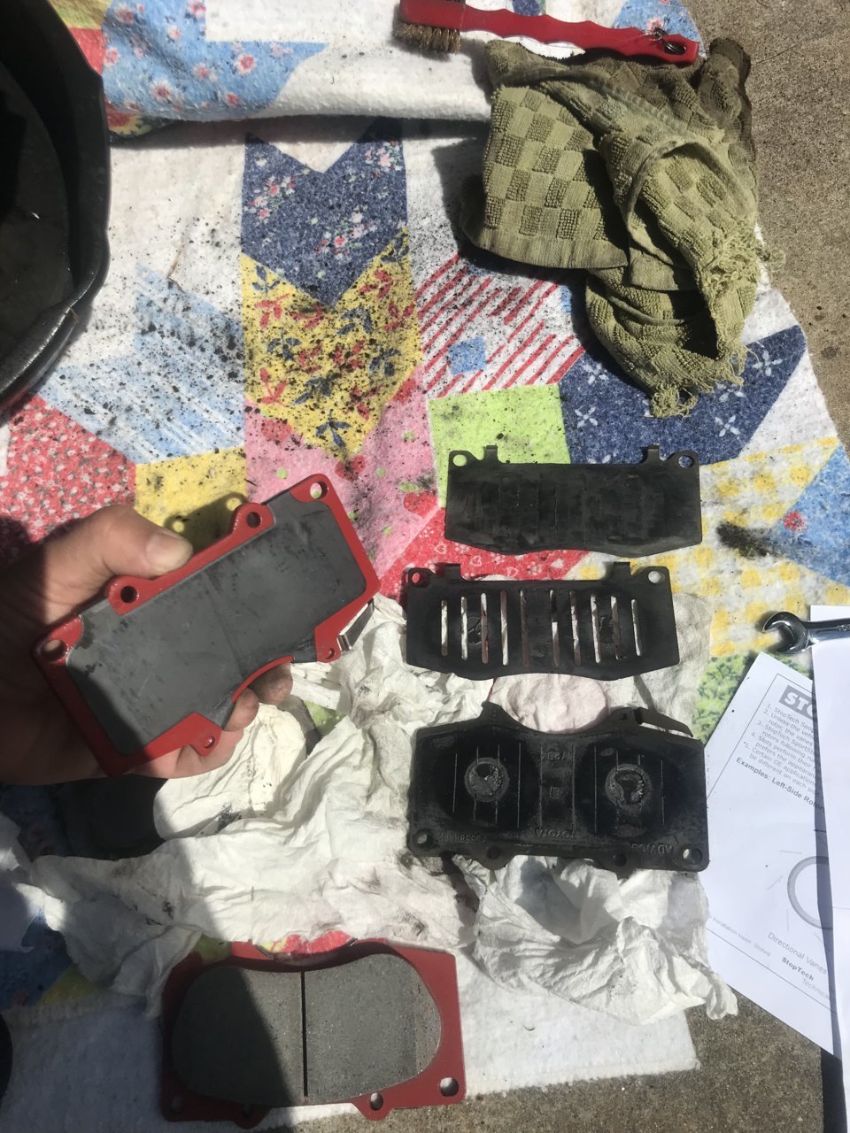

    Need Help!
    Installing TRD pads and stoptech rotors right this second and need to know if I reuse any of these plates off the OEM pads.
    TRD pad instructions say not to reuse the anti-squeal shims, but transfer wear indicators, springs, and fit plates.
    I know one of these is the anti-squeal pad, but is the other the fit plate? And which is which?
