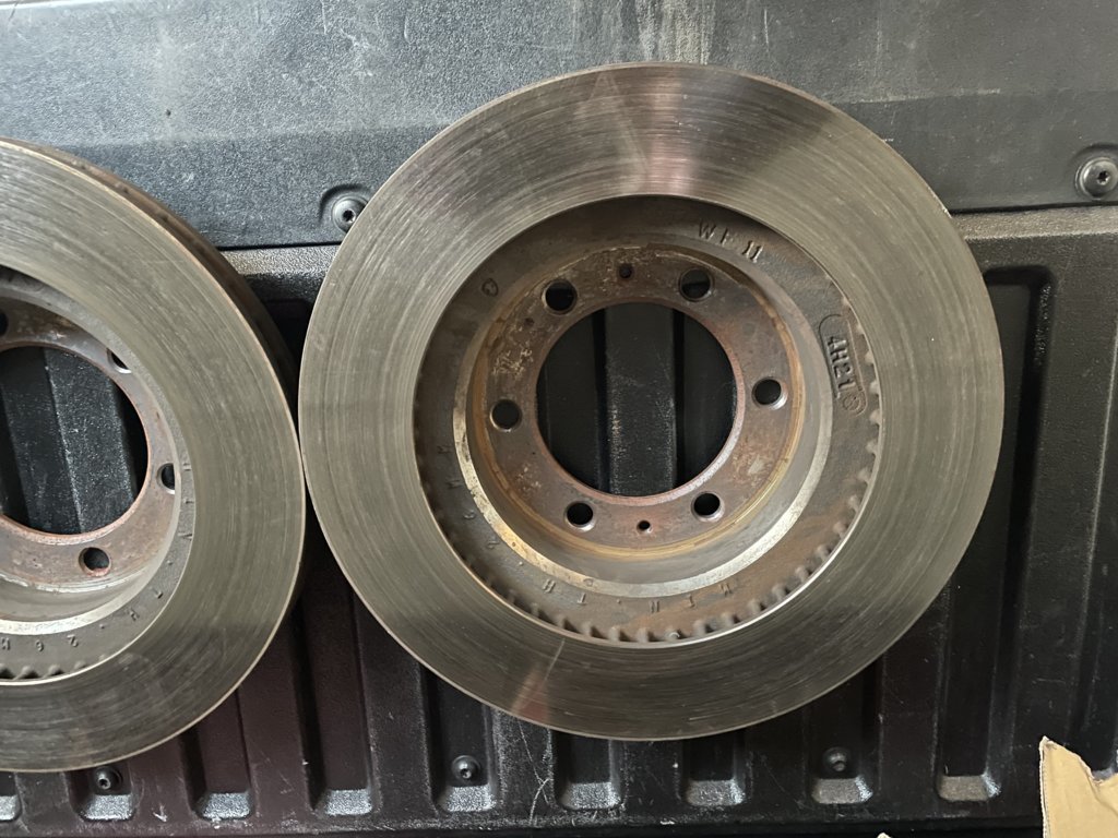

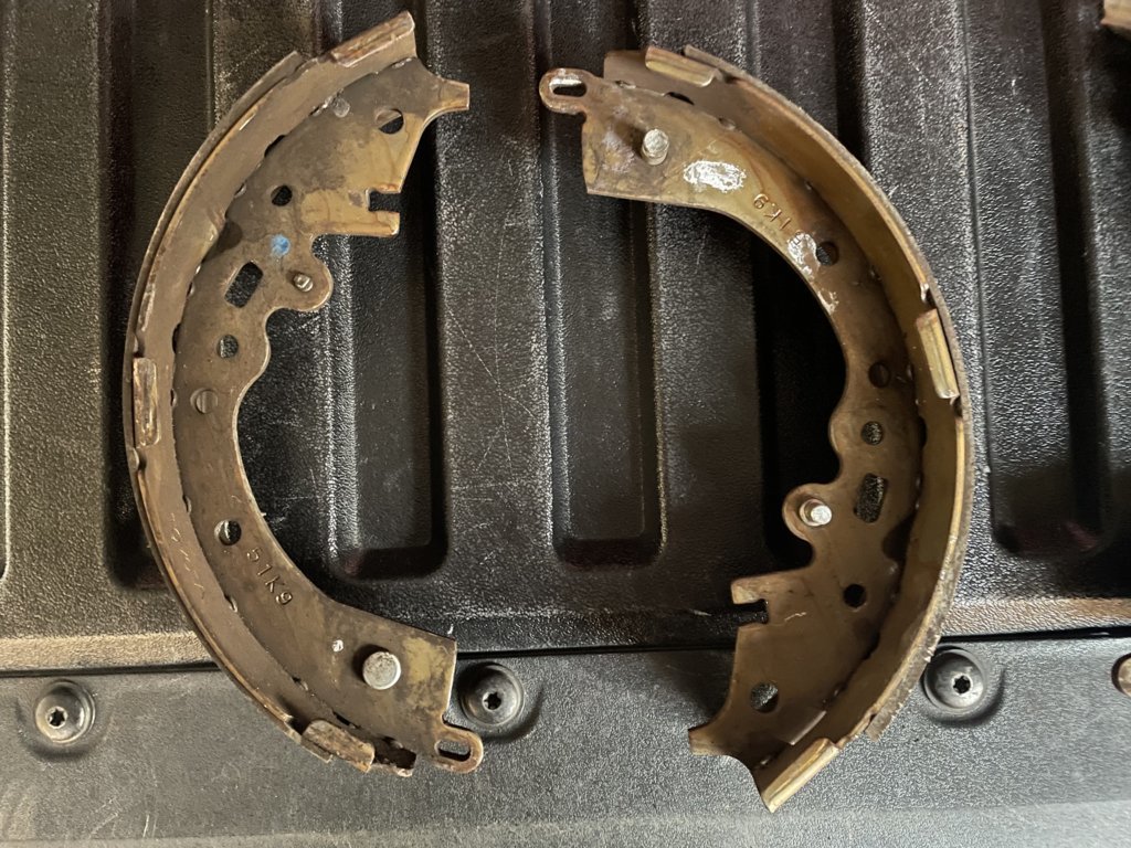

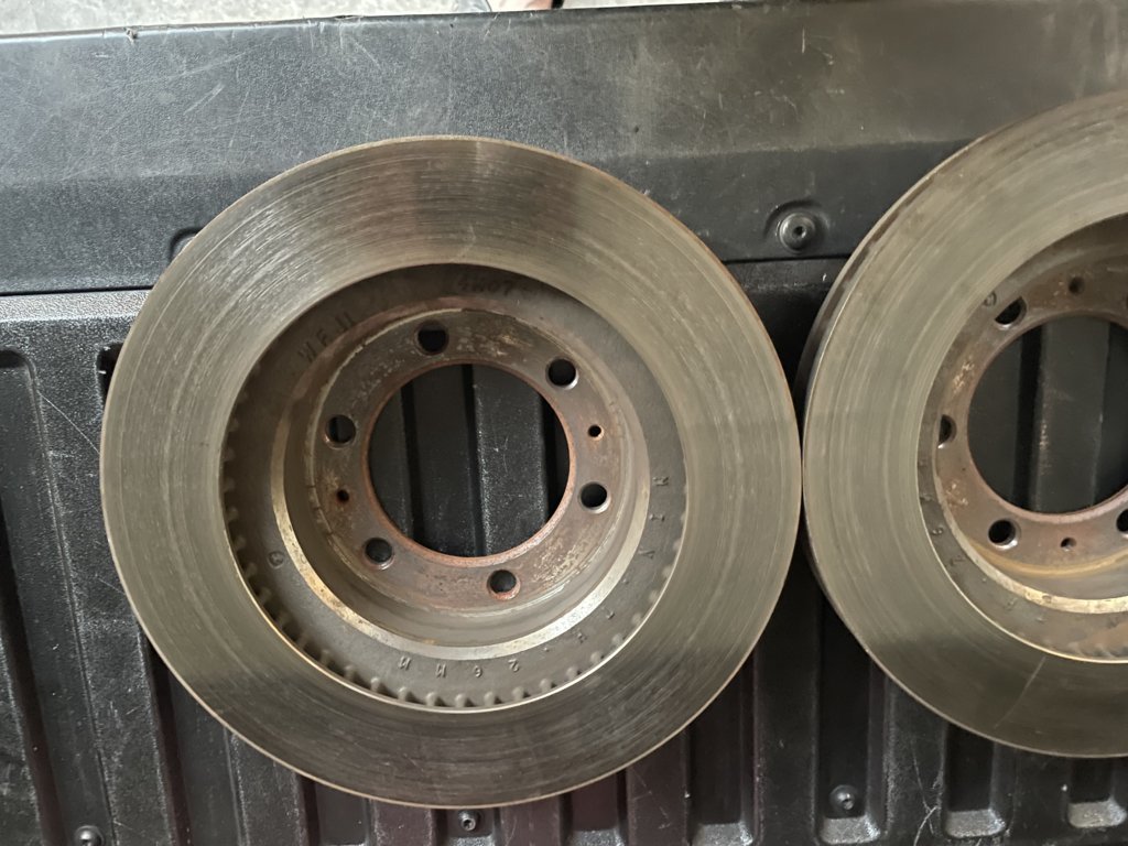

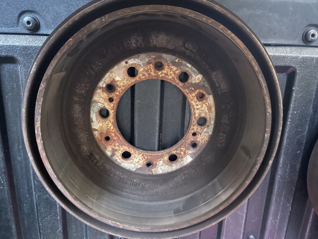

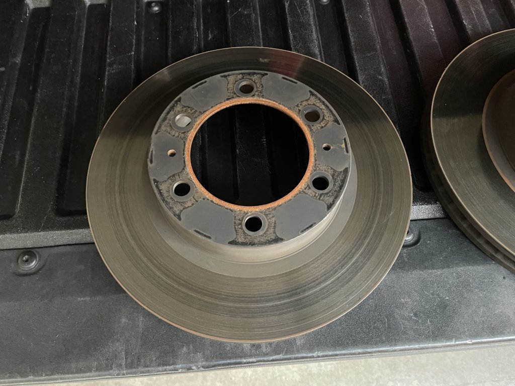

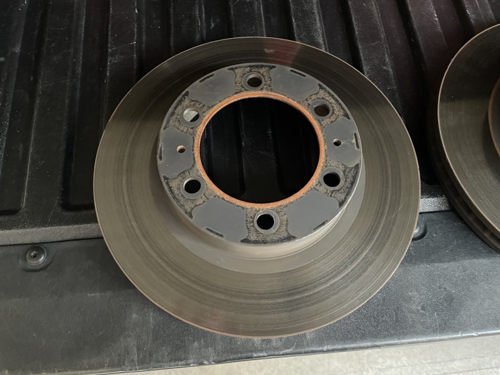

    Updating this for what it's worth.
    About 3 months ago I took the truck to Big Brand Tire off Raintree in Scottsdale to have the brakes done. The truck had about 60k miles and was due for front pads. The rear drums were also squeaking a low speed stops (parking lot stops), which was an indication that the sides of the shoes were likely rubbing on the contact points of the backing plate. The drums were also due for a good cleaning.
    Big Brand ordered new oem pads and rotors from the local dealer and the parts arrived for install a couple days later.
    Well, $1000 bucks later I had new oem rotors, new oem front pads and the rear drums were cleaned and lubed. Or so I was told. I took the truck back within a short time frame (maybe a couple weeks) and told them the drums were worse and squealing horribly.
    They put the truck on the rack and cleaned up the drums again. They pointed out one of the drums had a groove worn in it from something and that was likely the culprit of the sound.
    I left dissatisfied knowing the tech was dumbass and I was ripped off.
    Fast forward a few months to yesterday afternoon and I took the truck to Yota Pros in Tempe, AZ for new drums, new shoes and the new pads I ordered in the previous post.
    As it turns out, the oem pads Big Brand installed were the good oem version and not the cheaper A200 alternatives I suspected. However, the rotors showed indication that they were much older than 5000 miles. Additionally, the rotors were too small causing the new front pads to over hang on the rotor and wear the edge of the pad goofy.
    Furthermore, the rear drums were adjusted incorrectly along with the parking brake causing the shoes to wear irregularly at the top and the bottom of the shoe. So, Big Brand completely trashed my rear drum shoes in 5k miles and either the dealer where the rotors came from or big brand lied about new rotors.
    Great! :rant:
    Yota Pros in Tempe ordered new Akebono rotors, lightly scuffed the new pads and installed the new drums and shoes I bought at Toyota's last big sale.
    $800 later not including the cost of the drums and shoes and the truck is squeal free and and braking as it should. All in all I think I've blown about $2000 getting oem brakes done and about 12 hours waiting on 3 separate trips.
    Tomorrow morning I'm going over to Big Brand Tire off Raintree in Scottsdale to inquire about a refund/reimbursement for their incompetence. :smack:
    I mailed the performance pads back Automotive Brake Solutions, but I'm out the cost of return shipping and a 25% restocking fee. Wonderful. :mad:
    I've attached a few pictures of the old drums, worn drum shoes and the supposedly "new" rotors with only 5k miles. :mad::mad:

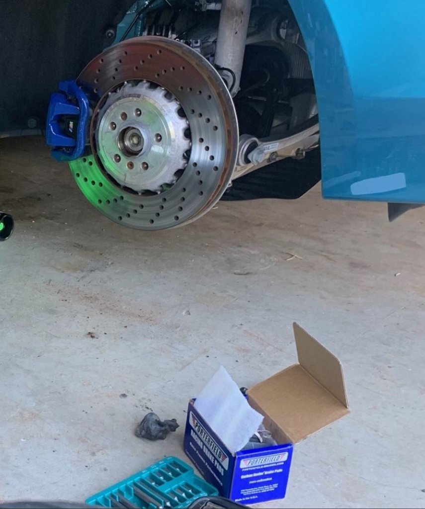

    I used the Porterfield RS-4 on my 18 BMW M5. They worked great for the first 4k miles but then they started to squeak horribly upon braking and they produced more brake dust then the OEM pads. m5 portrerfield 3.jpg M5 porterfield 1.jpg M5 porterfield 2.jpg
