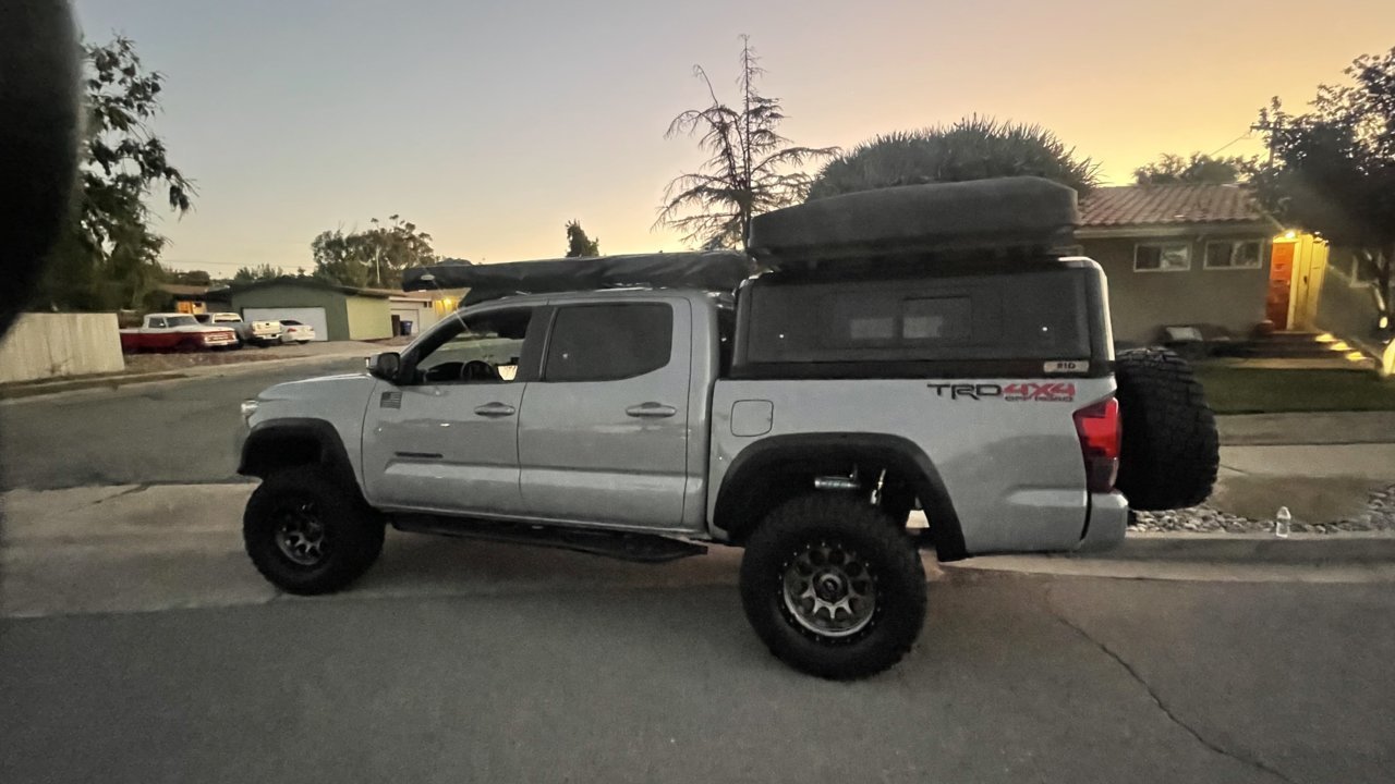

    Looking to replace my brakes. Don’t know if I need new drums but I am looking for a brake rotor and pads upgrade for my front breaks. My rig is fairly heavy. Vendor, website, type and brand would be appreciated. I have a 2018 DCSB OFF-ROAD.
