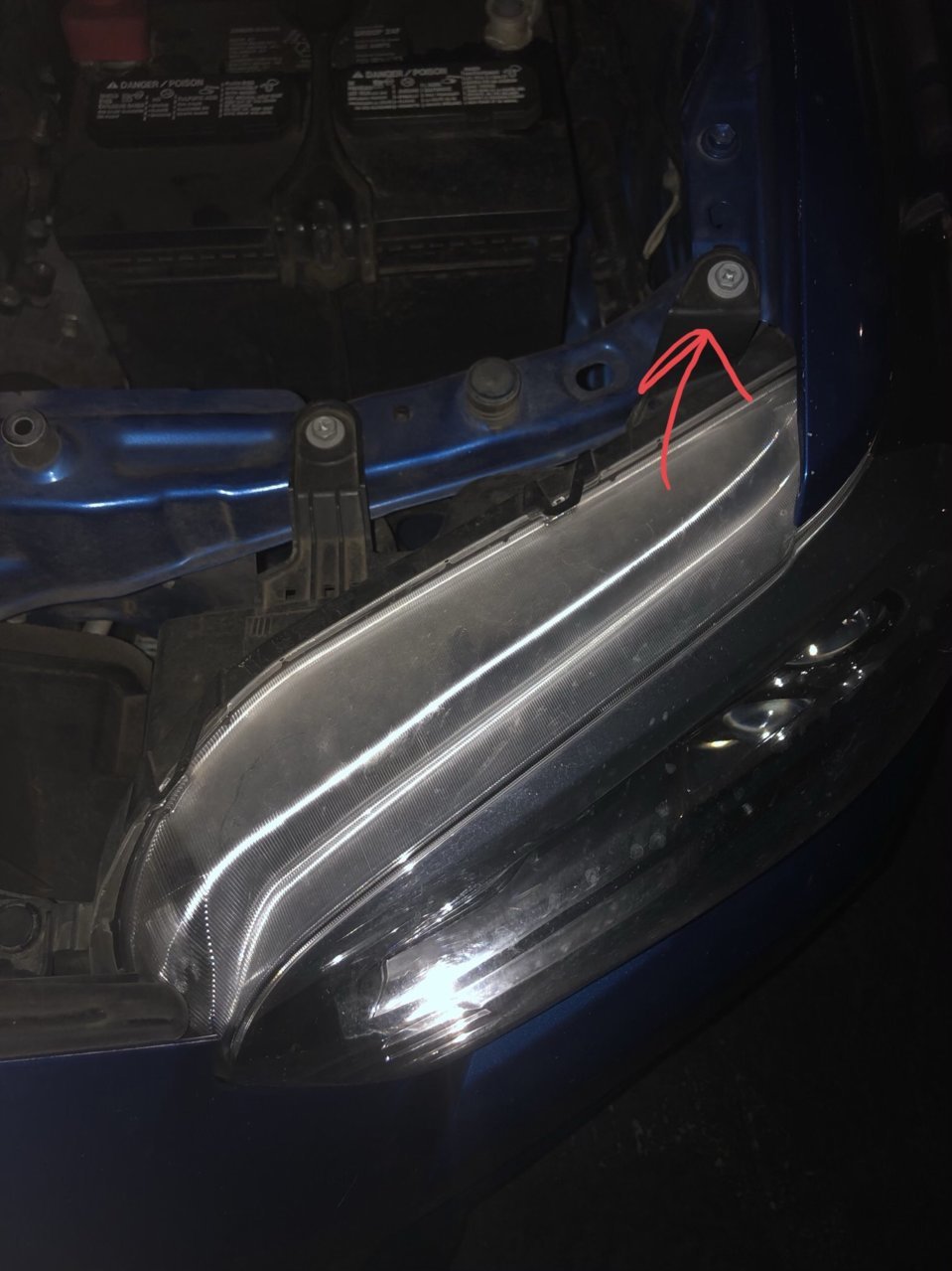

    I can’t seem to find what screw you’re talking about. Am I an idiot? Is this it?

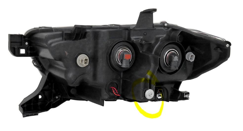

    This? I don’t see anything directly on the top of the housing... sorry if this is stupid lol. I just need some help :confused:

    If it's like the 2 gens there's a bolt on the back of the housing facing the back or the vechile right above the rubber garmet for left right adjustment then another one down lower where the bumper meets the fender that's a bitch to get to for up and down adjustment

    Thanks, that would make more sense haha. Not sure how I'm gonna fit a screwdriver back there without taking the headlight out

    No that's not it. It's on the back of the housing.

    See the vertical slot leading to the "bolt"? That's for a #2 Philips screwdriver. If you look directly down that slot you'll see where to insert the screwdriver and turn the bolt via the teeth/cogs on the adjuster. It's quite easy and does NOT require removing the housing.

    Thanks guys! :) I knew it didn’t make sense that the mounting screw would be adjusting it lol... but I saw the “up/“down arrow right next to it on top of the headlight, so I was extremely confused
