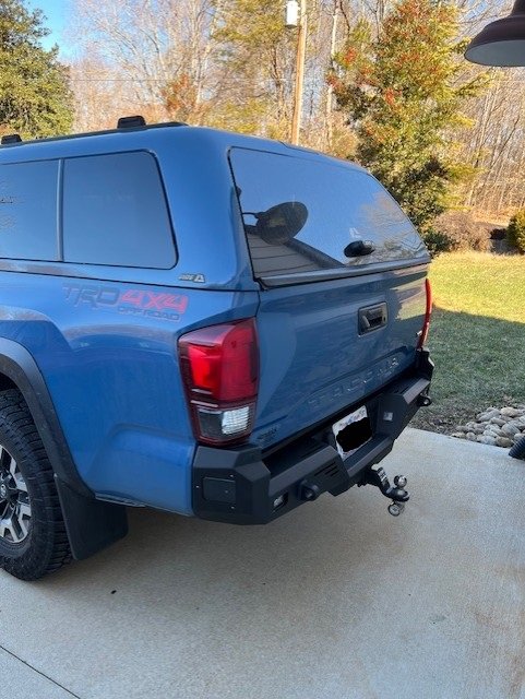

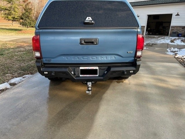

    I have a Rago bumper, however the BSM does not work. The angle of the sensor is only 30 degrees and unless I'm mistaken it needs to be around 50. When I first installed the bumper the BSM would pick up every fence post or mailbox I passed. After a few weeks of this glitchy behavior it completely stopped working and displays the BSM unavailable message. I scanned the ADAS with my scan tool and confirmed the horizontal beam axis misaligned fault and the live data showed the yaw angle of the sensors was only 29.6 degrees. I may try to modify the angle of the sensor and recalibrate, but I hate to cut into the bumper and have to redo the powder coat.
    MBangs, INTERRUPTOR22 and Klinc207 like this.
