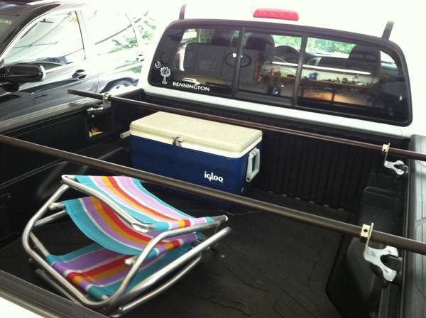

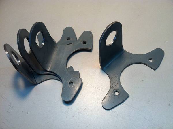

    Cut, drilled and bent from 1/8" scrap metal, $4
    $13 of scuffed up Lowes 6' ceiling fan extension rods(trimmed ends), $14 Tractor supply 3-point hitch collars & $2.48 worth of 1/4-20 bolts washers nyloc nuts
    Craiglist Yakima basket $125

    The Cleat's caution sticker warns against angle loading and damage
    The Toyota Cross bar setup limits weight at 100lbs across tw bars and four cleats. That's 25 pounds per.
    I wanted this setup to carry cargo box, mountain bikes, skis, kayak, some fire wood, folding chairs, coolers, hand tools, lighter gear, etc.. the Yakima basket’s weight limit is 140 pounds. I’ll bet the Tacoma factory roof system is not much over 100 pounds ? If you go to the L2S web site all the logic and original intentions are solid.

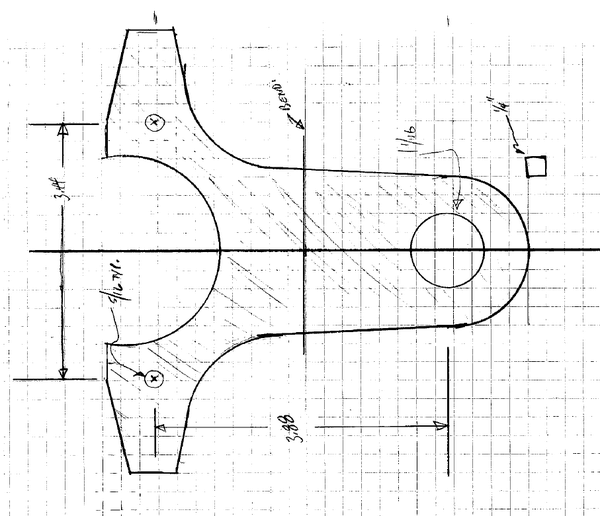

    Here’s the drawing I made and used. I traced it on some heavy card stock and sharpied it onto some salvaged steel. I cut with a 50 year old B&D jig saw, drilled it by hand, smoothed it all out with an old Craftsman belt sander and dremel tool finally bent it with a big dead blow hammer. The drawing should help as I shit canned the first one. I been asked twice in just a few weeks “where did you get those ?”…. kind of like saying I made them.
