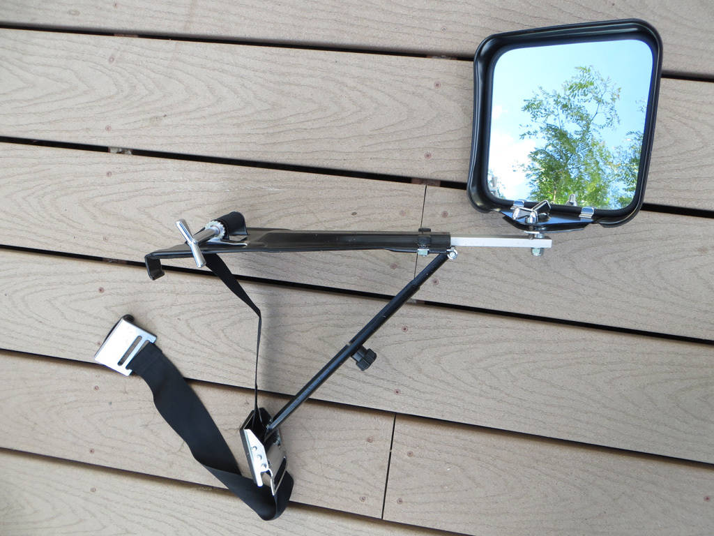

    I just ordered these mirrors, they look to be about the best option for the $$. Thanks Goober

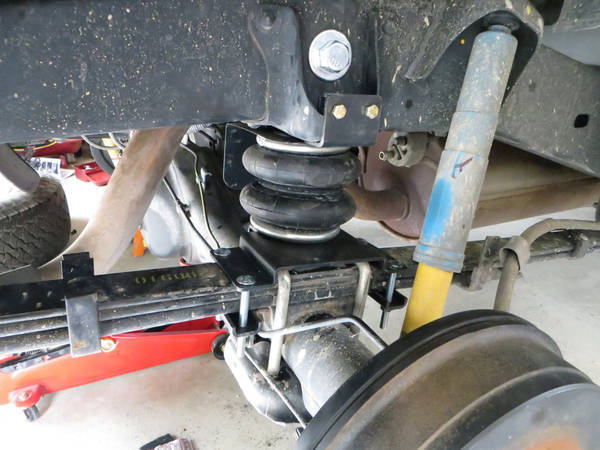

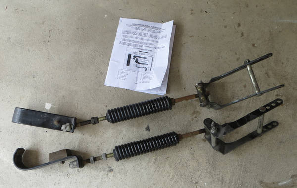

    Took off the Roadmaster Active Suspension
    Installed Firestone Ride Rite air bags
    Much better ride and handling
