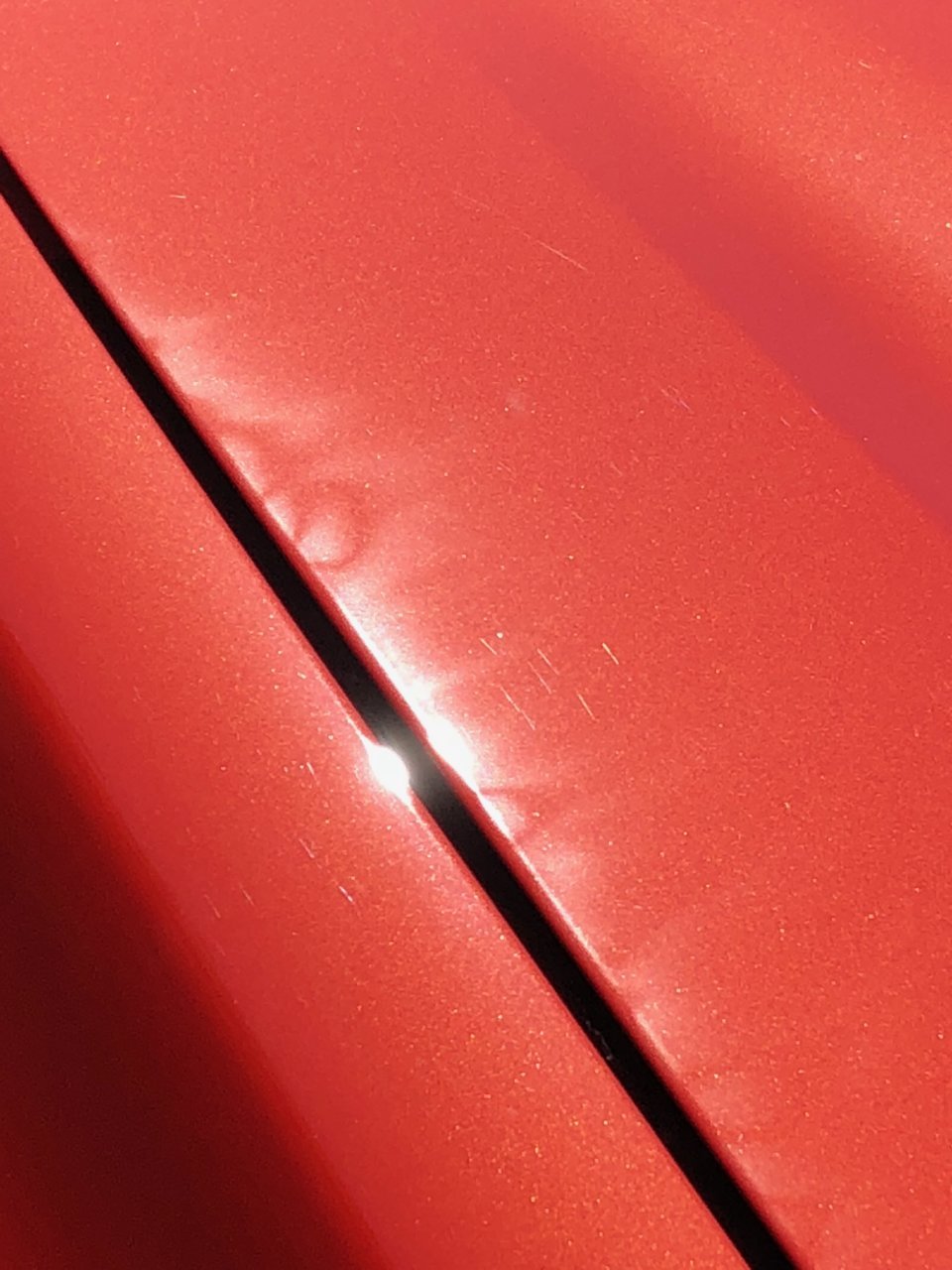

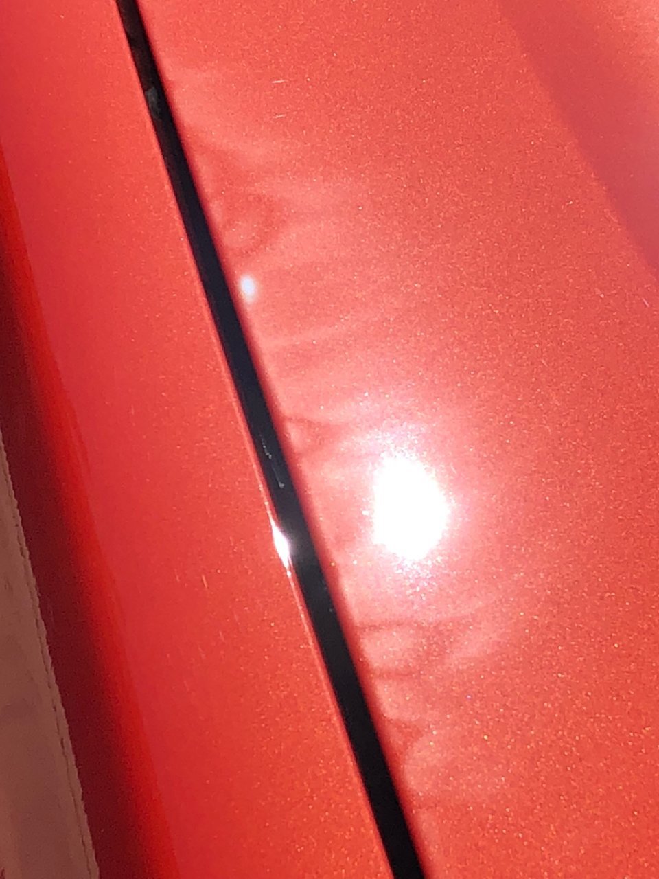

    Hey all, I have an Inferno OR 2018. The night after I brought it home I was washing and then putting on a good coat of paint sealant. I noticed some blemishes on the hood, right at the fender seam. Light buffing did nothing, so I went ahead and laid down a good coat of sealant and the next day a good coat of carnuba. I honestly didn't want to go through the hassle of dealing with the dealership and likely getting told 'sorry'.
    I did a decent wash this morning and noticed it again (you have to have the angle just right). It's not always visible, otherwise I would have taken it in and complained. Has anybody seen anything like this?
    Three pictures of the same location, slightly different angle. It's almost as if there's some heat effect from welding.... but don't welds occur before paint?

    And primer which has to dry before stages of finish coats and clear. So no its not for factory welds.

    That looks like it was caused by a solvent spill.

    TSB-0044-16
    For some reason I can't file attach it here but, it talks about water getting trapped under the vehicle wrap (Rapguard) and it stains the paint.
    You heat the affected area with a heat gun to 70-80 deg C (158-176deg F) but stay under 80C/176F , for 5 mins, let cool down and inspect, repeat as necessary.

    Thanks for the info. File attached. I may give this a try. I happen to have a relatively new porter cable heat gun and a decent laser thermometer

    Yeah same as it ever was... OP should stand back and look at the plastic paint compared to the metal paint... then notice he's got a 3 tone paint job. Toyota specializes in this.
    The hood doesn't look good to me. Looks like paint was exposed to some serious wind and paint thinner. Maybe the gun that was spraying the hood ran out of paint in the middle of painting the hood.

    That looks like overspray. Should be able to get it out, but need to wetsand, compound, polish, and wax.

    Oooh, wetsanding always spooks me a little. I have some finishing polish and a good dual action orbital. I'll try the heat gun first, and if no luck will move to my finishing polishes.

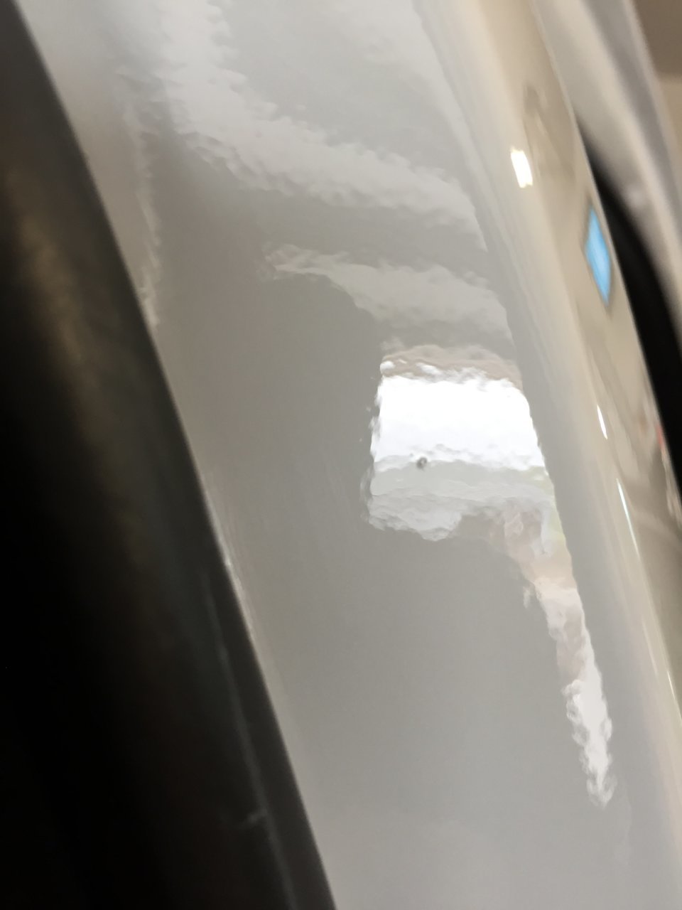

    Nepa
    2017 white Tacoma Trd sport
  13. May 6, 2018 at 6:57 PM
    tomwil
    tomwil Well-Known Member
    May 15, 2014
    #129887
    8,048
    East Coast USA
    2014 Reg Cab 4x4
  14. May 6, 2018 at 7:03 PM
    rdjr17
    rdjr17 Well-Known Member
    Apr 15, 2017
    #216341
    438
    Ron
    Nepa
    Chucked likes this.
