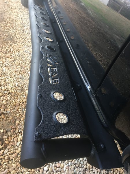

    Very nice, those look good! I like the idea of the Line-x on the step pad. More traction and it will hold up to scratches from dirt and rocks stuck in shoes allot better.

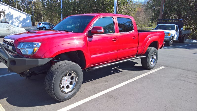

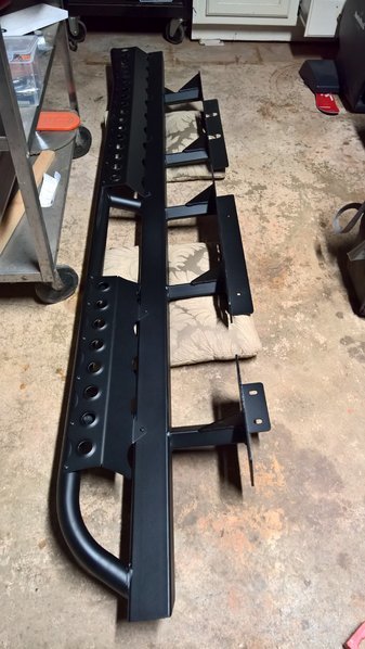

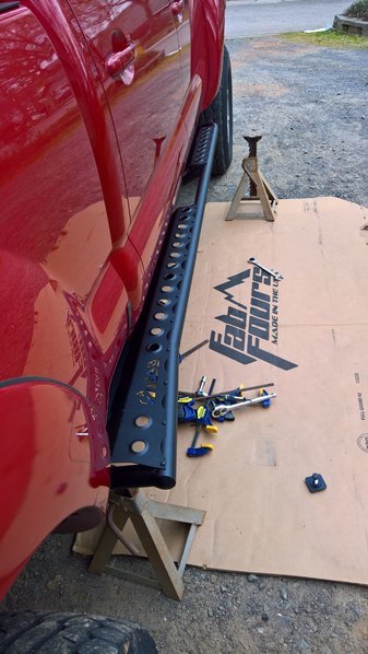

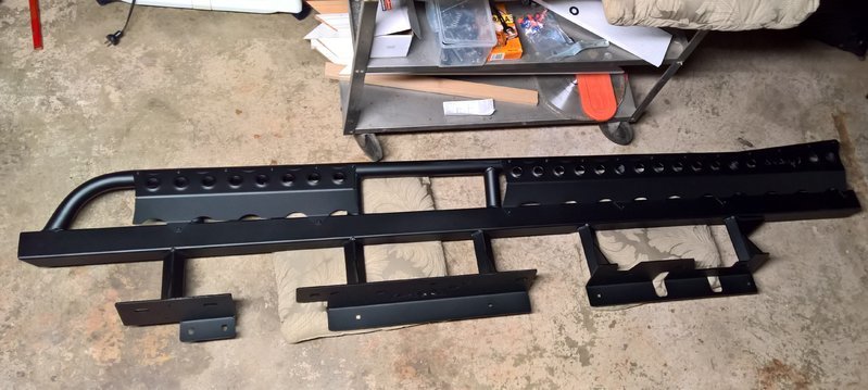

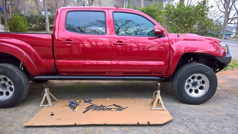

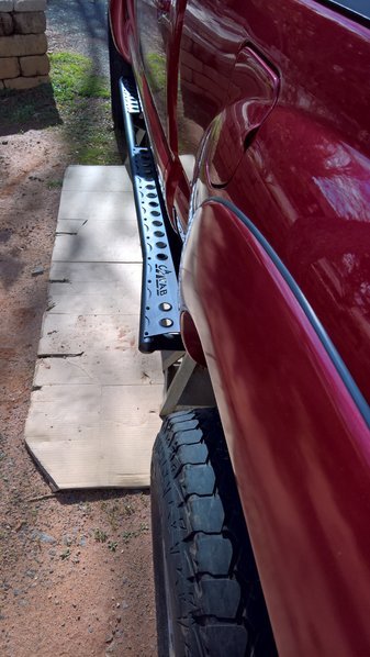

    Ok, so I don't have any of those little electric boxes on my frame(2nd gen) so it was way easier of an install also Long bed so much more room under the truck.
    WP_20170303_10_11_44_Rich.jpg WP_20170228_23_12_44_Rich.jpg WP_20170228_23_30_24_Rich (2).jpg WP_20170301_15_15_21_Rich.jpg WP_20170301_15_16_04_Rich.jpg WP_20170302_10_04_15_Rich.jpg

    Thanks for posting up pics, they look great!

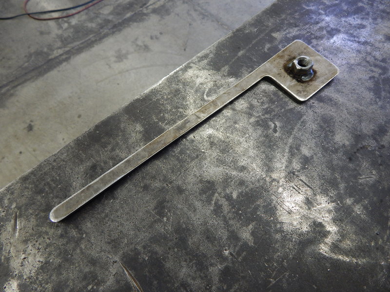

    My hardware is slightly different than these photos. I don't have this captured nut on a stick for the rear. I also only have 5 bolts per side and three backing plates per side (3 plates w/ loose nuts plus the two nuts on the forward capture sticks) so I think there was a design change rather than missing hardware. Can you confirm?

    I'm sorry we did not get back to you earlier we do not check this thread very often for messages. There were some design changes to the hardware and by Toyota. There are not as many holes in the side of the frame on the 2017 and up models. We updated our install instructions to reflect these changes. Instead of the single nut on a stick, you will now just use a square nut plate with flange nut in that area.

    Mine is just between the bolt and step plates. Guess I’ll have to get the steps recoated then use plastic washers.
