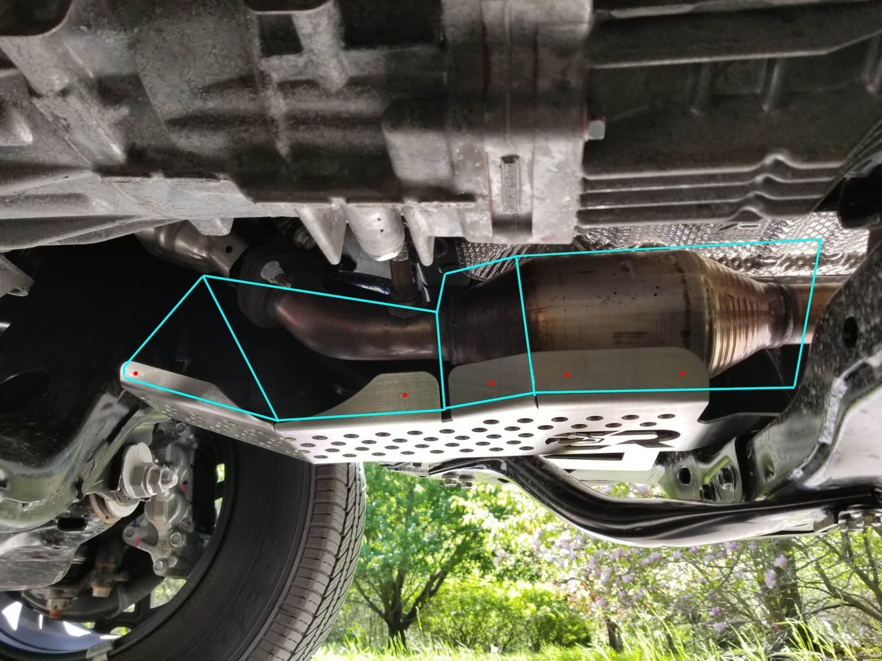

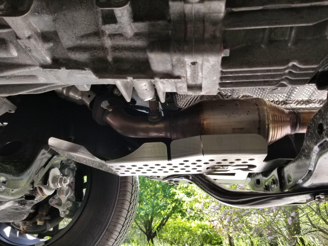

    AJFCJaXs0gtlfARYtqfaMz0hp3452oBiyLEFWaAP_c1c48315fe4d6f0e6f326e1a8416d3e93e0bfde8.jpg
    Another bent-to-fit piece of steel would do it. Had CaliRaised pre-drilled the existing piece, an additional piece of steel, bolts, washers, and nuts could be been offered as part of a more-expensive 6TM-only kit.

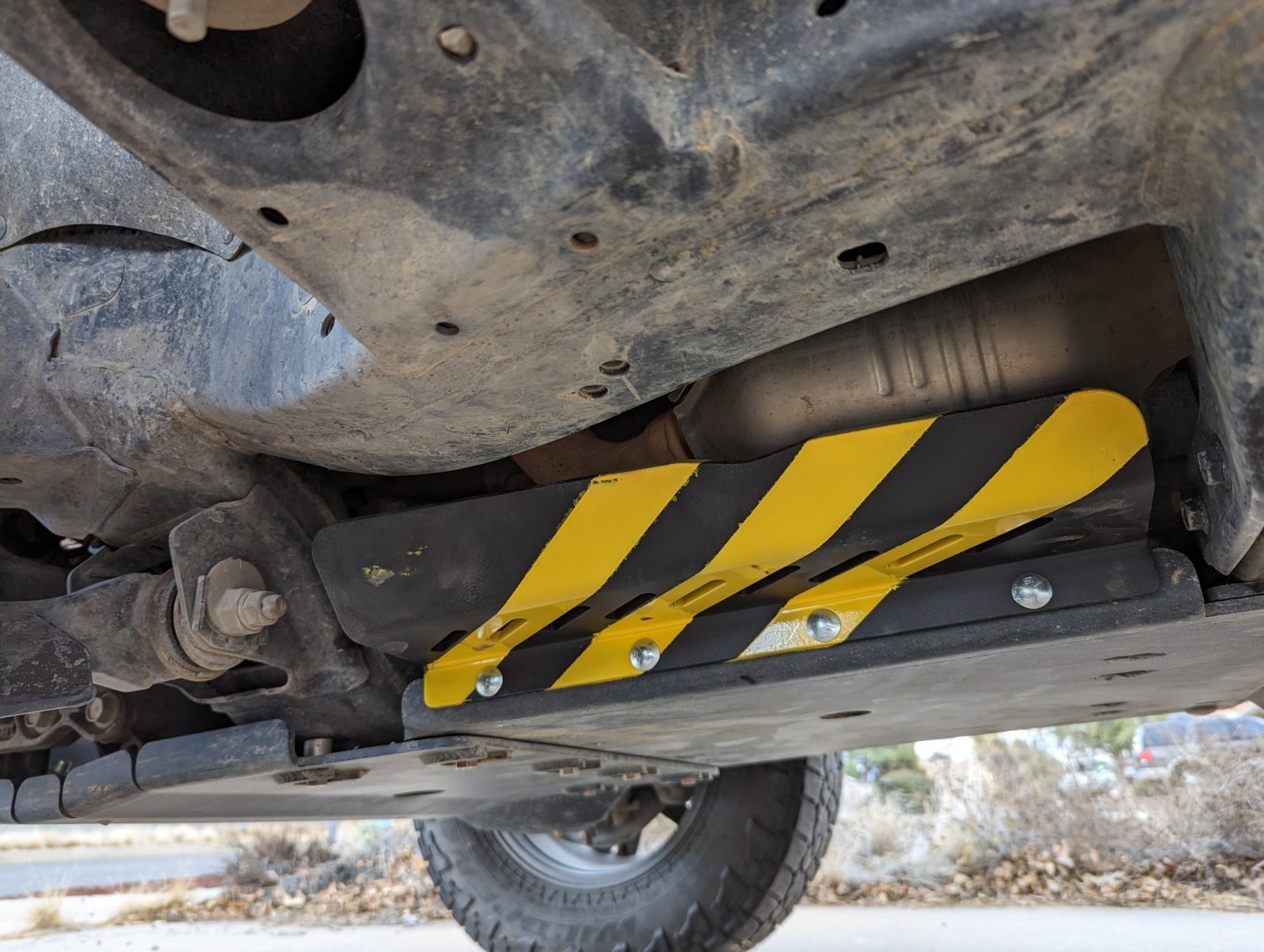

    Seems if you have a full skid plate system, the opening the MT leaves wouldn't really be an issue. That gap would be covered by the transmission plate.
    ... no?
    I have their full skids, so...
    But I'm still really torn between waiting to see if they release a 2nd Gen MT version and just buying what they have and modifying as I must. Not ideal, but ... .
    In the meantime, I ended up buying the RCI add-on wings, drilling some holes in the trans plate and mounting them up. Not bad, but could be better.
