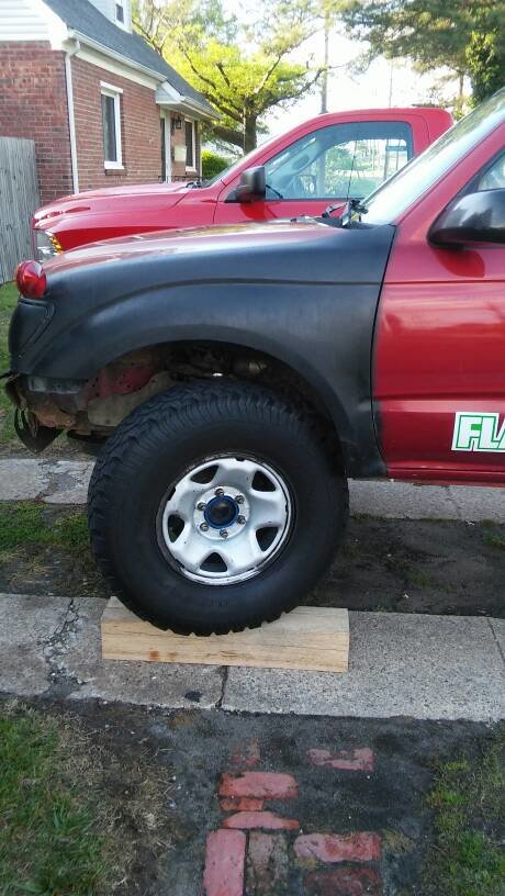

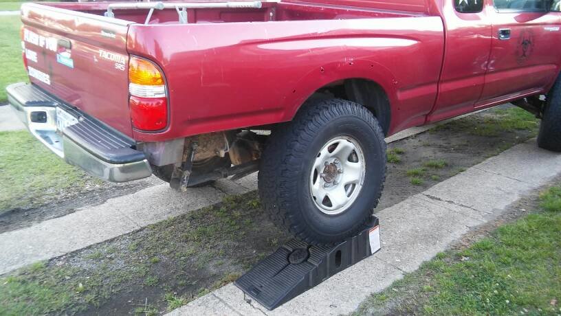

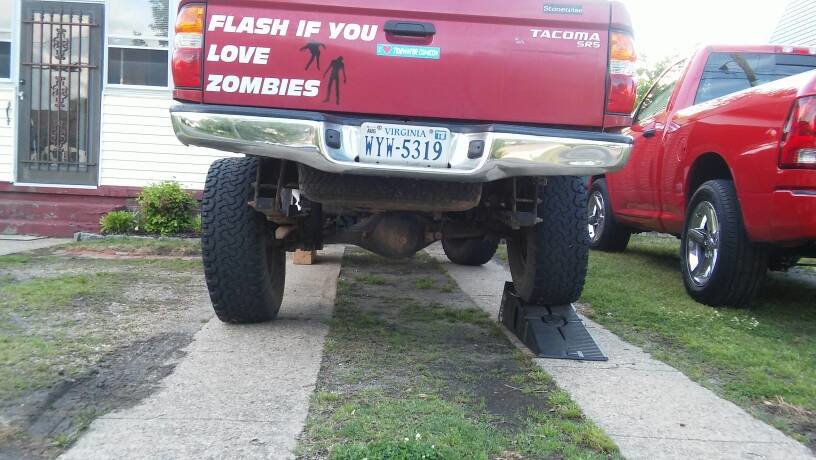

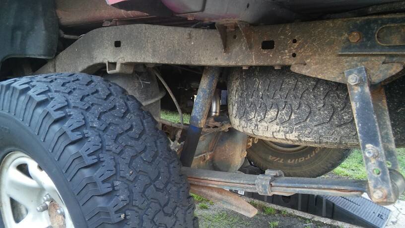

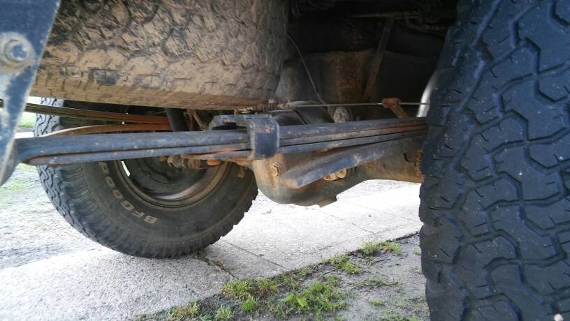

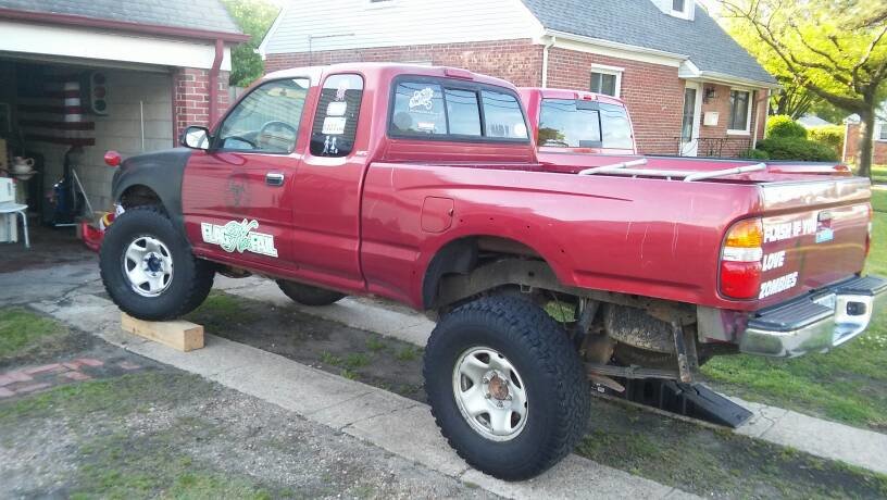

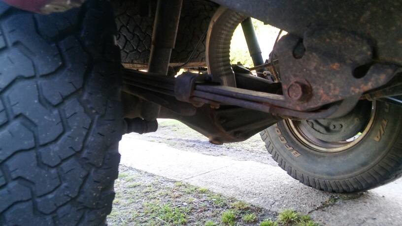

    So I'm in need of a bit of help. I decided I'd go out and prop my wheels up like this today.
    I noticed that my leaves went negative. That shouldn't happen correct? Time to replace the leaves?
    I've got extended shackles in the back for my lift and I fitted T-100 shocks because they were longer. I have about 1.5 inch left droop in the shock.
    Also I have this issue here. I'm not skilled nor do I have the equipment to weld. Would a BFH handle that? Just bash the shit out of it. As you can see it's not the prettiest truck in the world. So not to worried about the paint underneath. I always spray clear if I crack the paint. Any opinions are welcome.
    Should I invest in longer shocks? Any recommendations on something that won't break the bank. My wife and I are expecting our first baby in the next month. I've done all of the basic upkeep just want to get some of this other stuff done as well. I wheel roughly 2-3 times a month. Random trips to the mountains and mud now and again. Also I wanted to say thank you. My truck has come along way since I joined TW and found this thread.

    The leaves look fine. As long as they have arch when sitting there it is fine... The leaves will usually go flat or negative when flexing... Your best bet would be maybe adding a leaf or going to a junk yard and finding some leaf packs there or maybe doing a chevy spring swap... I forget the guys screen name but he has a white first gen and has a very good write up on here of how to swap chevy springs into a first gen
