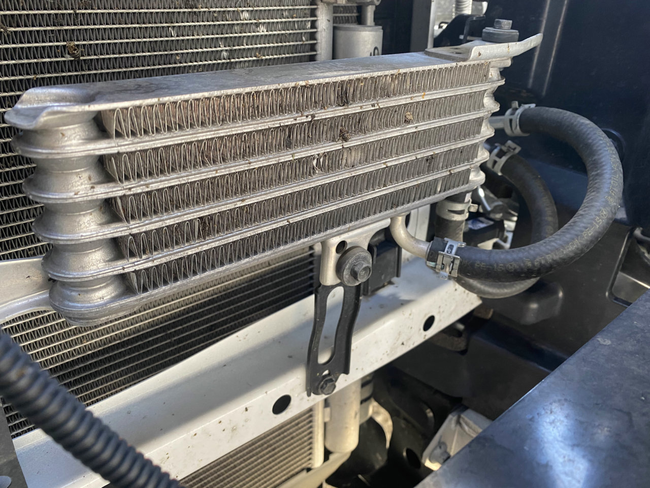

    There is an aluminum cooler located in front of the radiator and a/c condenser. Not sure if this is for power steering or tranny. The manufacture date was 10/19.
