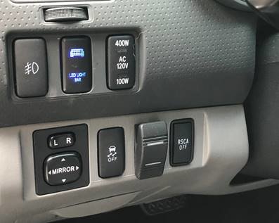

    Will fit with some dremeling , but sticks out like a sore thumb on dash.

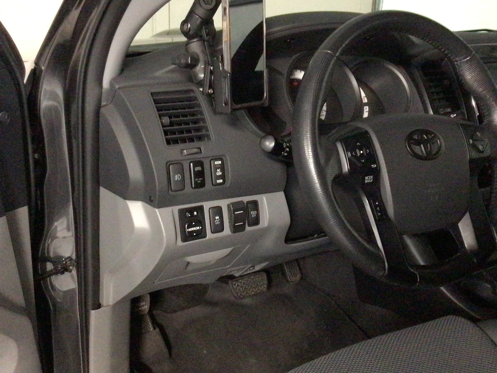

    I don't think they had DPDT's when I did mine. (In fact, this company may not have been around or widely known back then?) I see this one but it's not listed as Toyota size so I'm not sure how it would fit.
    https://www.ch4x4.com/product/ch4x4-rocker-switch-dpdt-on-off-on-main-back-light-symbol/
    Agreed, thankfully it's mostly hidden by the steering wheel for me!

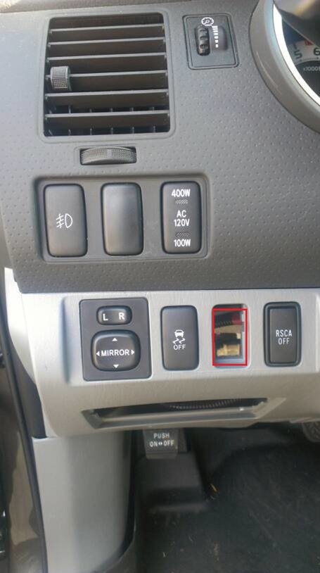

    Oh, I only had to Dremel the lip inside the hole so the body of the button fit, the face and visible area of the dash were not breached at all.
    The marine button I used is built well and reliable, and to me looks better than a pin-shaped toggle.
    Photo below not mine, stolen from post: https://www.tacomaworld.com/threads/blank-switch-removal.283658/
    This inside area I marked in red is where I had to shave down some plastic:
