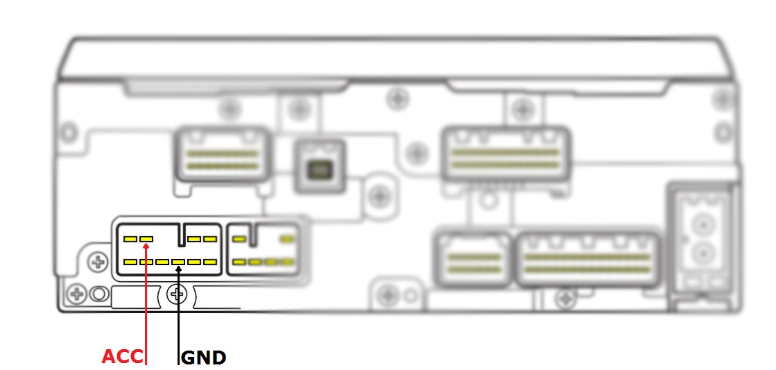

    So, my HU born date matches my truck, so I would assume that it is factory stock. It does NOT have an apps button, so maybe therein lies the difference? What packages do you have on your truck? Also, do you only have wiring for the two speaker plugins (upper left), two video plugins (top right and 3rd right), left bottom grey connector, and bottom-most white connector? I think those are the only things I have hookups for
    @DES2009 The SR HU you posted appears to be the same as mine. That JBL HU is too big for my dash without switching the trim as well. It may be easier to just go with the anytimebackup camera version instead and install an extra switch. Idk if I will have the same issues.

    Here is the official answer from car solutions!
    Link: https://i.imgur.com/8gnUY2i.png
    Since I have a complete wiring harness for my tacoma...thanks to the dealership that burned mine up, I'm going to create another t-harness. I will depin the power wires from the small connector on the CS harness and insert them into the connector from the burned up harness. I could cut open my t-harness for my kicker key amp and wire the CS harness in directly, but I'd like this to be reversible in case it doesn't work. Hypothetically, using ~$10 in metra connectors, anyone could make this work. I'll keep you all posted with my progress and probably make a complete how-to thread if it works.

    So the additional 8 pin is just for 12V power then. Glad that CS gave you the info and will have it sorted out soon. I guess I was right in assuming those wires in the harness were a positive and negative. Hopefully CS will update their instructions in the future so this can be adapted for other SR models.

    I'm guessing that the 8-pin is used to supply power to the GPS/XM antenna, and they just piggyback off of it. I'm not sure why they wouldn't tap into the speaker power pins instead, considering every trim level has that

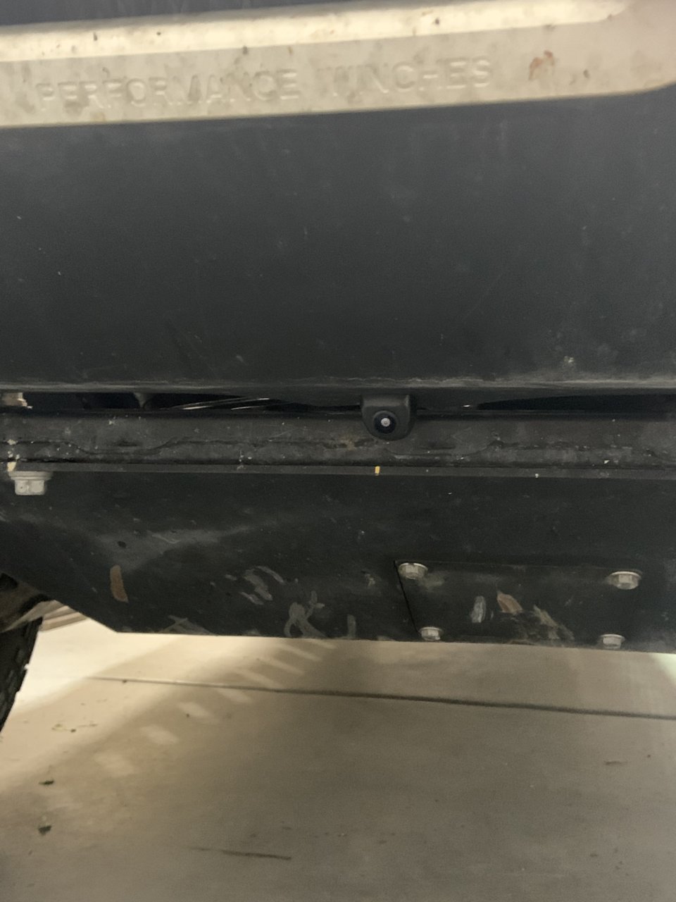

    Great product and the best solution for front and/or rear camera add. Love the steering wheel controls. So happy with this. My unusual camera location will be questioned but I wanted the camera for wheeling and the low view that is back farther than can be achieved with a grill mount. It may get hit but it is actual protected somewhat by the location. If I smear it off, its 40 bucks and 5 minutes to replace.
