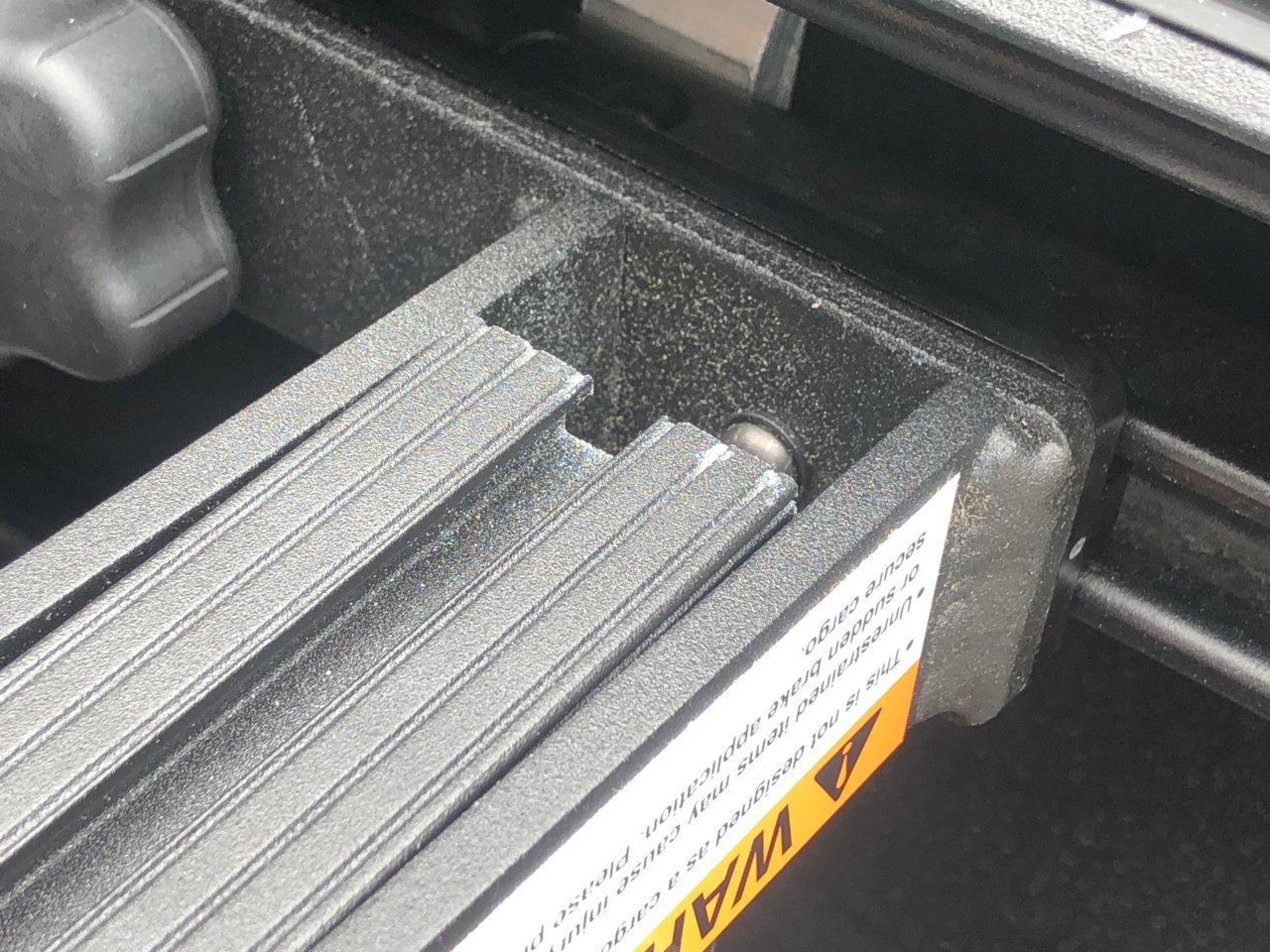

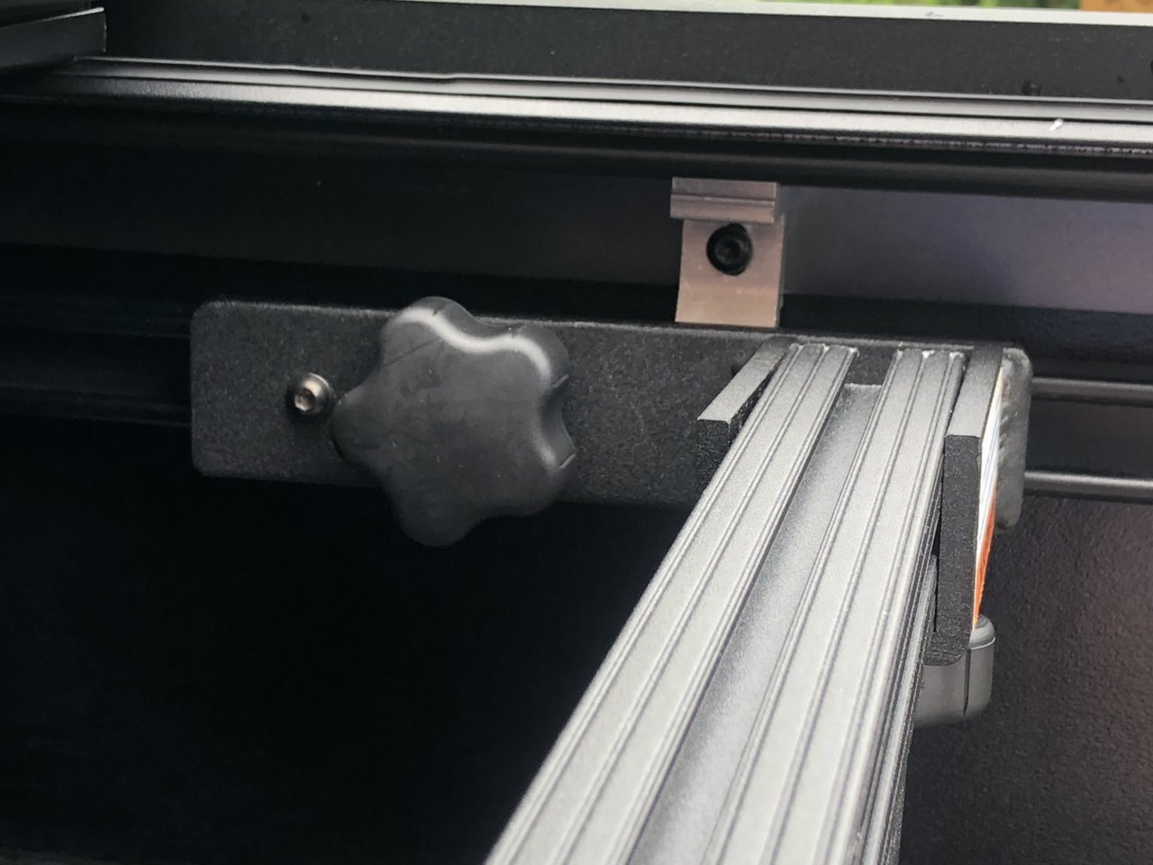

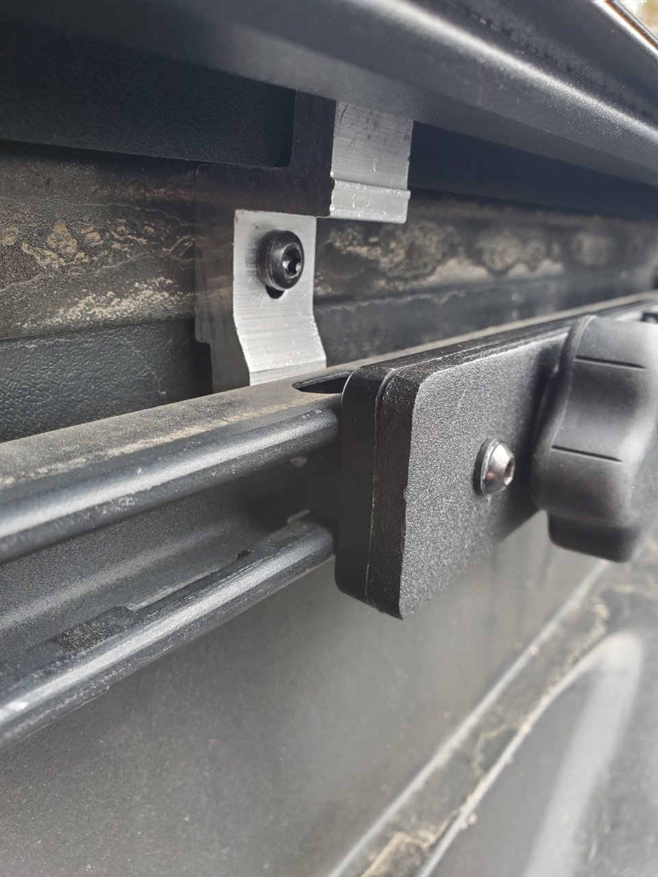

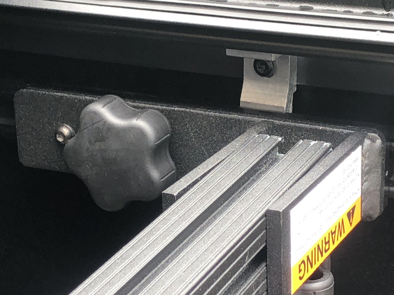

    IMG_5061.jpg IMG_5061.jpg IMG_5062.jpg IMG_5063.jpg IMG_5064.jpg Aren't the replies from 9mmMike and Mojlnir indicating that they were successful using OEM divider underneath the MX4 maybe by flipping brackets L/R and dropping knobs down?

    One inch from each side of divider (hacksaw). Brackets flipped to place divider knob underneath.
