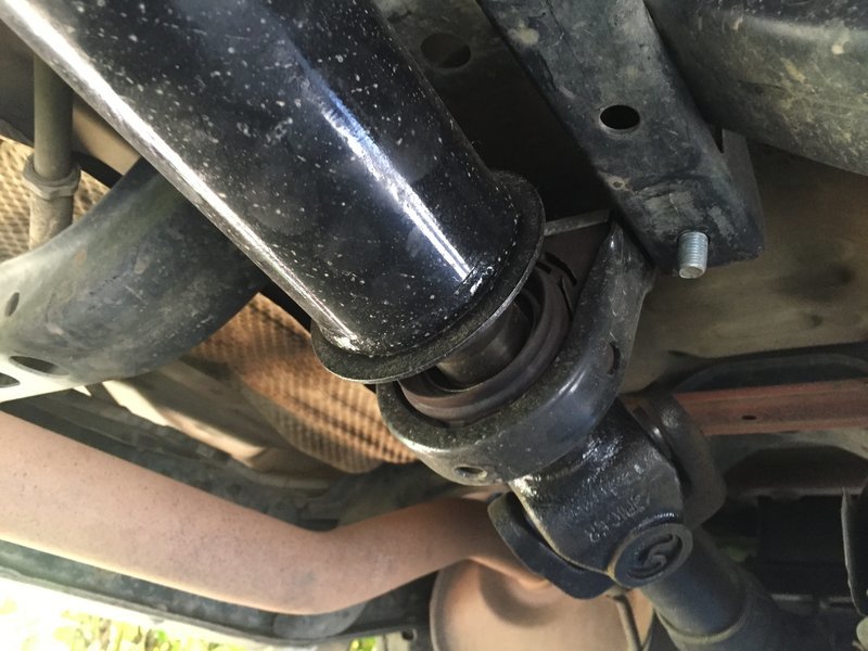

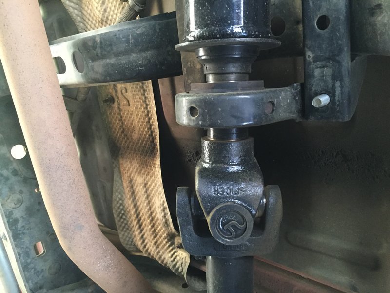

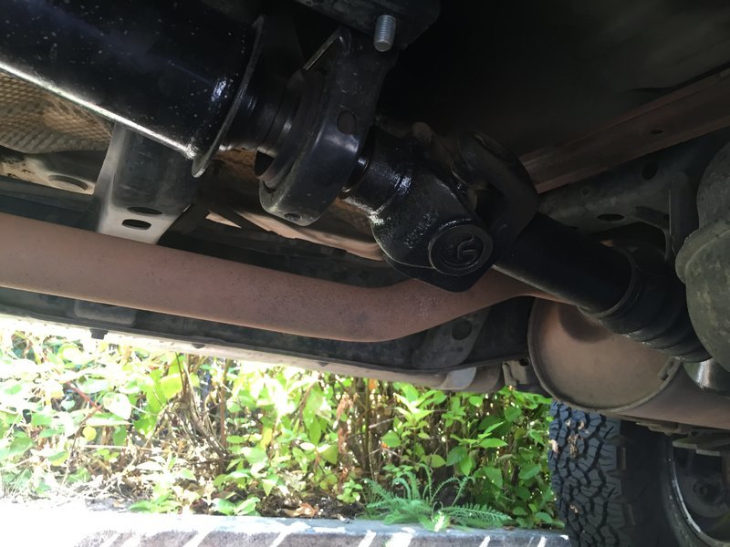

    Bearing is for either a Bronco II or a Ranger, I cannot remember which one. Either way it is the same inner diameter as the Tacoma driveshaft. Also, the support/mounting bracket for the bearing was cut so I could mount the bearing above where it was when stock (i.e. closer to the body). I was dealing with vibrations and going through bearings quicker than I should have been after installing 3'' OME lift. Haven't had any issues so far. Things were installed this way since FEB 2016.
