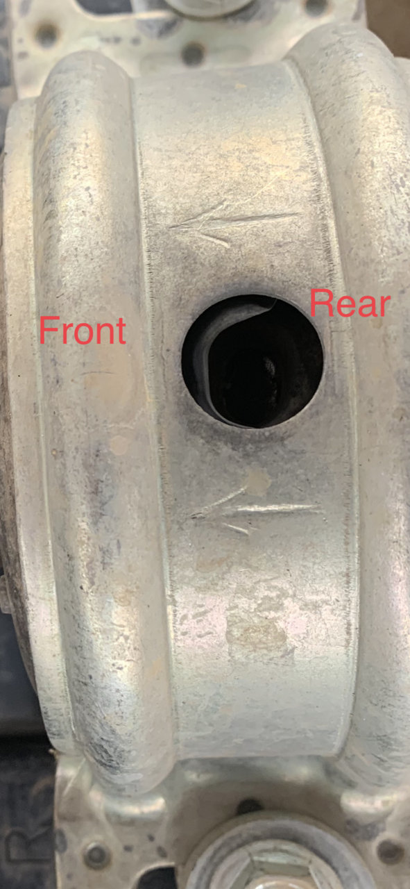

    Does your cb have arrows on the bottom pointing to the front of the truck? If not it might be flipped the wrong way. Also check your centering by tying string to drive shaft zerts and line up with the center hole on the bottom of the cb. If its off you would be adding another angle to everything = harmonic chaos

    I just installed a new center bearing a couple of weeks ago. It did come with arrows but no indication which direction the arrows were supposed to point. Are arrows supposed to point to the front or rear?

    2012 ac trd 4x4 sc , 2012 sequoia 4x4
    mikkydee[QUOTED] likes this.
