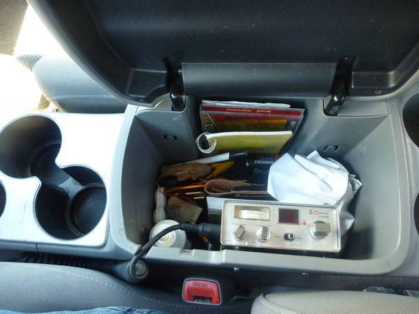

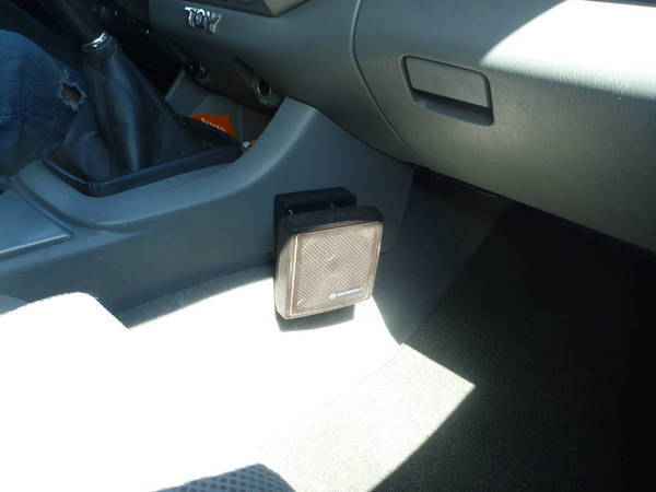

    Has anyone done this? put the CB in the center console. I just did it and it worked out awesome! I put an external speaker on the passenger side of the center and made a little hole for the wire to come out where the console release button is. I will try to get some pics up in a while. just need to go get an antenna.

    mines in their, its in the little gap near the passenger side. External speaker under my coin tray.

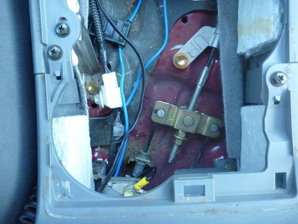

    there is a blower motor underneath the console. The blue and black wire going to the motor had power so i tapped into that and just put an inline fuse.

    Here, Rellik01, i took a picture of the wires under the cup holder for you. and some pictures of what the final product looks like.
    the blue wire is the CB and it goes into that wiring with the big white clip

    looks great, I will be doing something similar.
