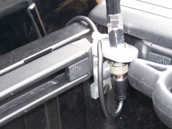

    here's my antenna setup on the 07
    cb location for the 07 and 09
    for a descent setup, i'd go w/ a cobra 29 ltd, 4' fiberglass k40 or firestik, and then the coax....definately dont skimp on the cable. try to find a good radio shop around where u are and have them peak the cb and tune the swr for u so u know its good. also, the easiest way to run the cable into the cab is to take it through the frame until u get to the rubber grommets under the front seat, put a hole in it, run the cable through and under the carpet until u get it where u need it
