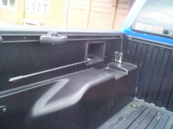

    Finally got around to mount the firestick , I didn't want to drill any holes in the truck so I removed the drop in bed liner, removed the tie down hook and went to work.
    Using my oxy aceteylene torch I Braised these parts, sand blasted/ painted them, ran a ground wire to one of the mounting bolts just for good measure.
    This is the final result, minus the actual firestick, I'll pick that up on Monday. That black wire is the ground that I bolted behind the tie down bolt, I left it long until I actually mount the firestick.
    Herer is a better shot of the final product, then using an existing gromet, I can run the coax to the radio right behind the bed

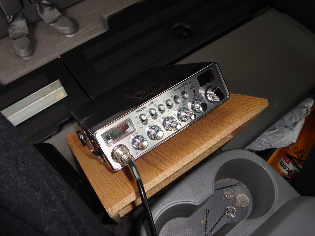

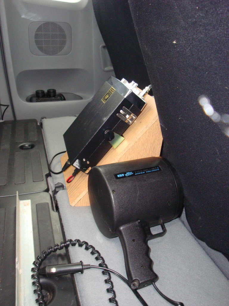

    For about a week I have been working on a new idea for mounting the CB in the cab.
    I am preparing a detailed overview of what I did but just to sum it up:
    I took apart a Cobra 29 LTD Classic (very common CB for truckers over the past 20 years). The only problem is that it is giant radio and hard to find a place to mount.
    I cut all the wires connecting the face plate to the main circuit board (buttons, switches and displays) and spliced in longer wires. This way I can place the face of the CB almost anywhere I want and place the body of the radio somewhere else like under the seat.
    When I finish I will post pics and more details.
