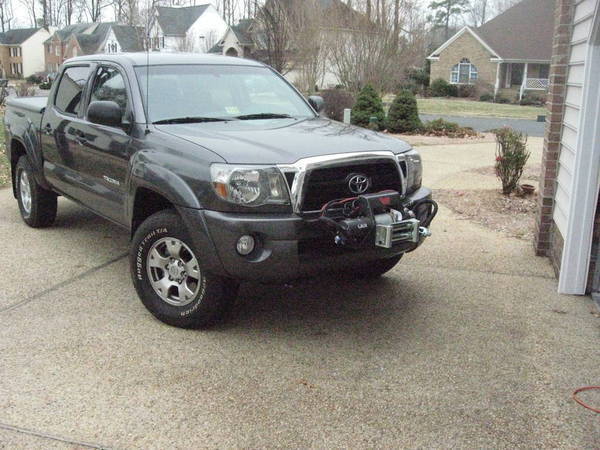

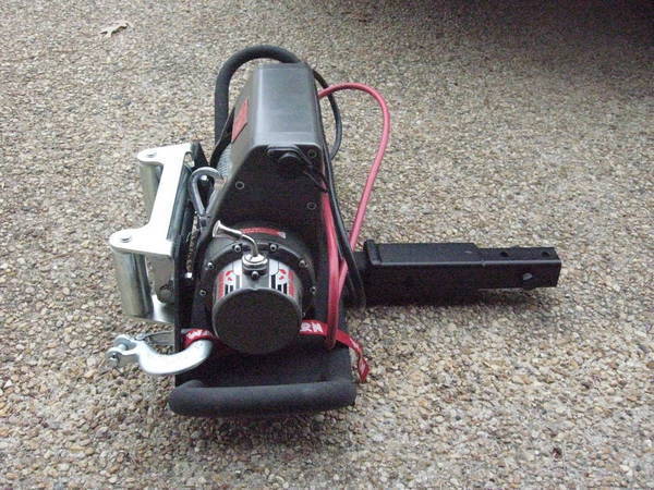

    Been awhile since I provided an update.... I received an adaptor from CBI to address the receiver tubing issue not allowing insertion of standard equipment. I went this route because I wanted to use it also as a method to mount in the winch cradle in the bed when not in use.
    I got my winch. I bought a refurbished Warn XD9000i. I wanted an integrated solenoid for portability and protection of the solenoid. The refurbished unit was about half of the retail price but only $200 less than you can get a new one on sale. Unit looks brand new and I haven't found any issues with it.
    Here is the winch mounted in the cradle made by CBI. Also shown in the picture is the adaptor that they provided. My intention is to put this setup in the bed with a hitch pin tieing the cradle to the adaptor and two bolts down through the adaptor and through the bed.
    Winch / cradle / and receiver adaptor (bed mount)

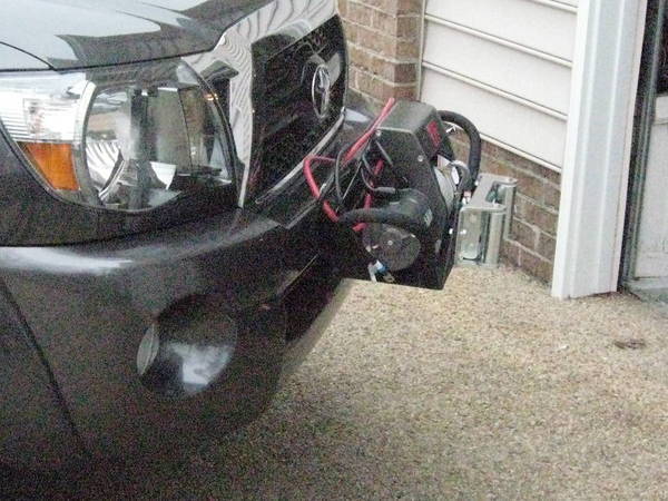

    Here is the cradle and winch on the truck in the front receiver. Note, no adpator is in here because the cradle fits the receiver great. The I didn't have time to hook up the wiring or try it out. I plan to setup for quick connects front and back. I am going to pick up a rattle free, locking hitch pin to pull the cradle tight to one side of the receiver. The lock will give peace of mind if I leave it on the truck.
    The last updates will be to wire it up front and back for quick connects. Also, I need to work out the mount in the bed. I want to drop 2 bolts through the thru holes in the adaptor through the bed and have nuts welded on a plate that is mounted to the underside of the bed. I need to find the right spot and someone to do some welding for me. Ideally, I can pull the whole thing out and will only have two holes through the bed but when I put it in, I can drop the bolts through and thread to the nuts without fishing or trying to line it up. I will post more pictures once I get it done.

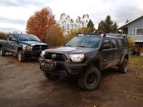

    Access cab with child seat in the back, yellow wire mod, diff breather relocated to tail light, engine block heater, Leer topper with Yakima tracks and rack, Yakima rack on cab, Ride Rite air bags with Daystar cradles, CBI hidden front hitch, wired for winch front and rear Warn quick connect, Warn x8000i on external carrier, sway bar delete, trailer plug relocated to under bumper, Pelfreybilt IFS and Mid skids, BAMF Tcase skid, ECGS front diff bushing, ARB CKMA12 compressor, 255/85/16 Backcountry MT 3 load E tires on stock steel rims, Toyo M55 tires (same size) on another set of stock steelies, Up2NoGood heated mirror kit, Husky X-act Contour front floor liners, Northstar AGM 24F battery under the hood, Northstar 27F in the cab, Redarc 25 amp DC to DC charger, Pelfreybilt bolt on sliders with kickout and top plates, TRD Pro headlights, Depo smoked tail lights, Energy suspension body mount bushing kit, OME Dakar leaf packs with AAL, OME rear shocks, OME 90021 front shocks with 885 coils, SPC LR UCAs, Up2NoGood 2wd low range mod, 4 Wheel Campers Grandby slide in camper, 4xinnovations high clearance rear bumper, Uniclutch 800 lb/ft clutch
    Bumping this one to report successful install. Pics to come...

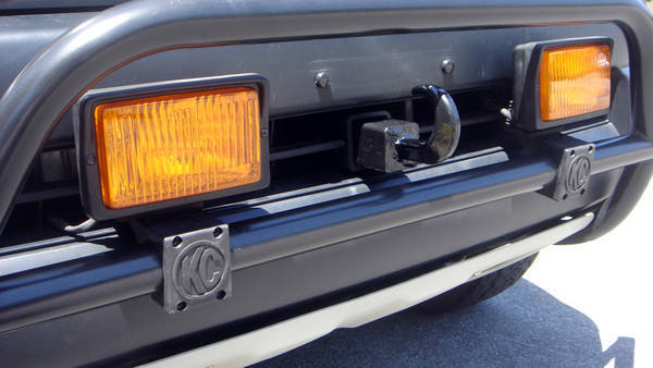

    Did everyone else who installed one of these lose their bolt on recovery point? What was your solution? Losing a recovery point is no bueno...

    I used a grinder to cut off a small corner of the CBI mount to make space for it to bolt back on. I may have also had to change the orientation of the recovery point somehow, can't quite remember.
    Still worth having, even after using the CBI because you may be using the receiver itself for a winch mount and then double the winch line back with a snatch block, and in that case having the original bolt on recovery point as a terminal point for the winch line is a good thing.

    I did try to rotate the recovery point 180, it looked like it would fit but no. I need to figure something out before the snow starts sticking to the ground. I do tree work, so I keep straps and pulleys on hand at all times, as well as 2 fifty foot 3/8 cable extensions.

    I flipped mine 180° and Notched the factory pie-tin front "skid" plate so it would fit....
