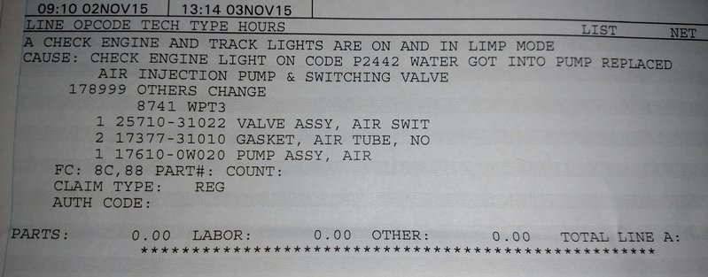

    Yesterday morning I pulled my 2012 Tacoma DCSB OR with 35k miles out of the garage and made it about 2 miles down the road when the Check Engine and Trac Off lights lit up.
    It put the truck into limp mode, limiting the speed to 40-45 mph. The dealership was about 7 miles away so I took a chance and drove it there.
    Upon arrival, they found code P2442. The mechanic found that moisture had gotten into the air injection pump and corroded the stitching valve. They replaced the air injection pump and switching valve.
    This was covered under the 8 year/80,000 mile emissions warranty so the nearly $1600 bill is on Toyota.
    They did have to keep my truck over night and gave me a loaner with no cost or hassle. The replacement parts arrived this morning and I picked my truck up around 1pm this afternoon.
    This is apparently a huge and common problem with the Tundras, but the Shop Manager told me this is the first Tacoma they have had with this problem.

    Thanks for the heads up on the bypass. While I didn't have a chance to compare the older design to the newer one, I feel confident that it won't happen again. I'm considering trading for a '16 or '17.

    I know the new pump is designed differently, but I don't know exactly how. I didn't see the old one that was taken out.
