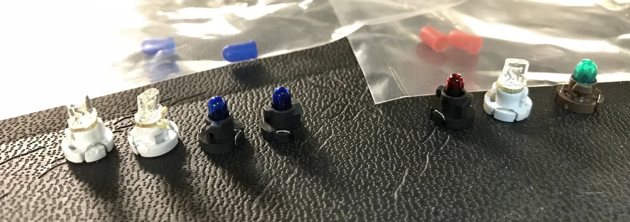

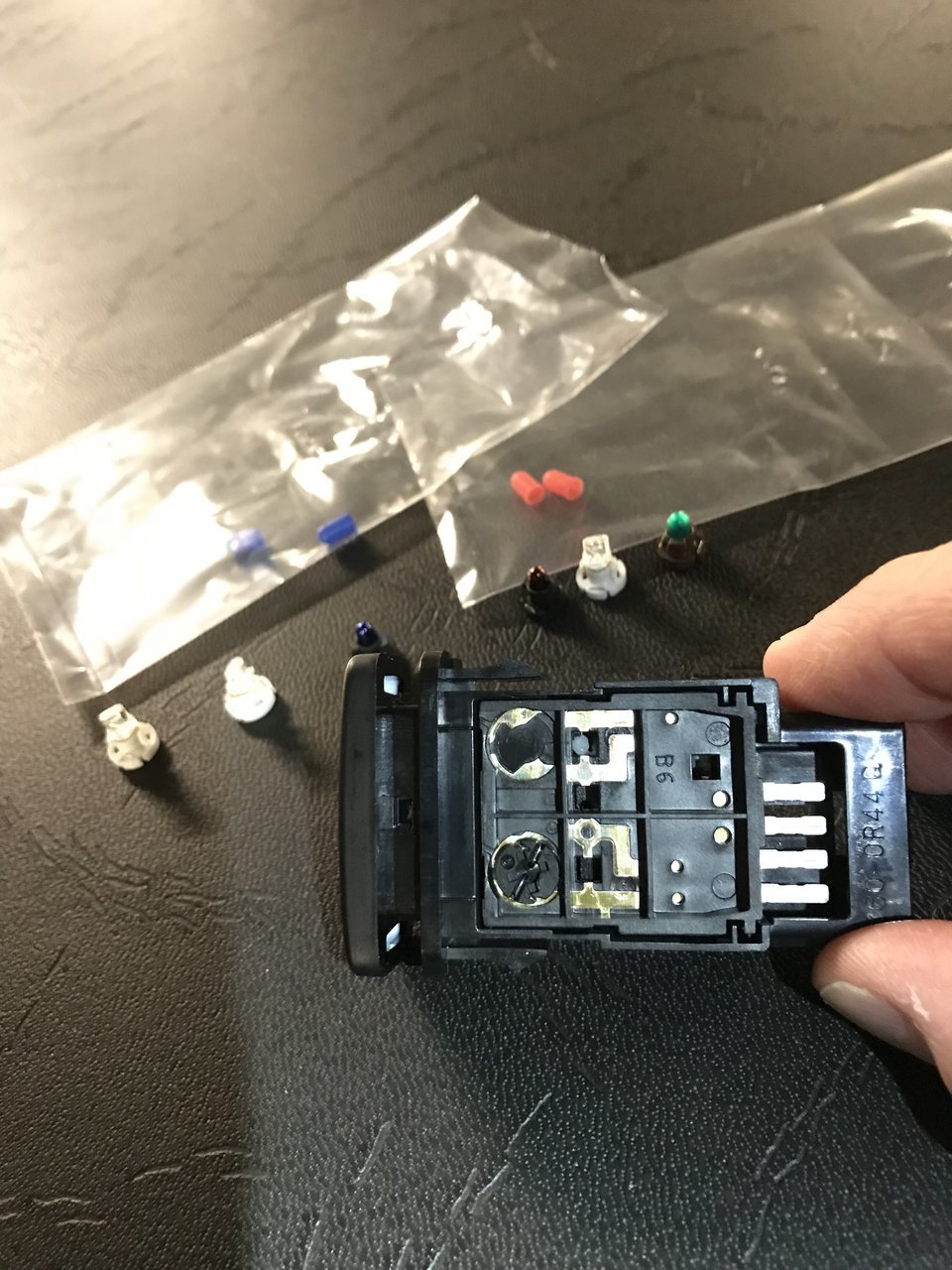

    What kind of modification did you have to do to the LED replacement bulbs for them to fit, looking to replace my factory fog light switch bulb that burnt outv

    If you look at my photo of the led bulbs, the top is clear plastic (the diode is inside). The base is white plastic. If you look in between you'll see a thin fiberglass disk that the led is mounted on. That disk is just slightly larger than the base in a couple little areas (it differs from bulb to bulb-- ie. buy five bulbs, two will probably fit perfect and three might require filing in a couple spots). I think the disk just isn't cut "perfect".
    So on each bulb there might be a couple little spots where just a hair needs to be filed down ever so slightly to match the profile of the base. Basically, that fiberglass disk might get hung up on the hole in the switch in a spot or two. Those holes have very fine tolerance for accepting the bulb. And cutting that small of a piece of fiberglass into a perfect circle is apparently not a piece of cake.
    I used a file to knock off the uneven edges. You could probably fix them with a dremel in two seconds. Or you might get lucky and your bulb will fit perfectly. One of mine did. A couple others did not.

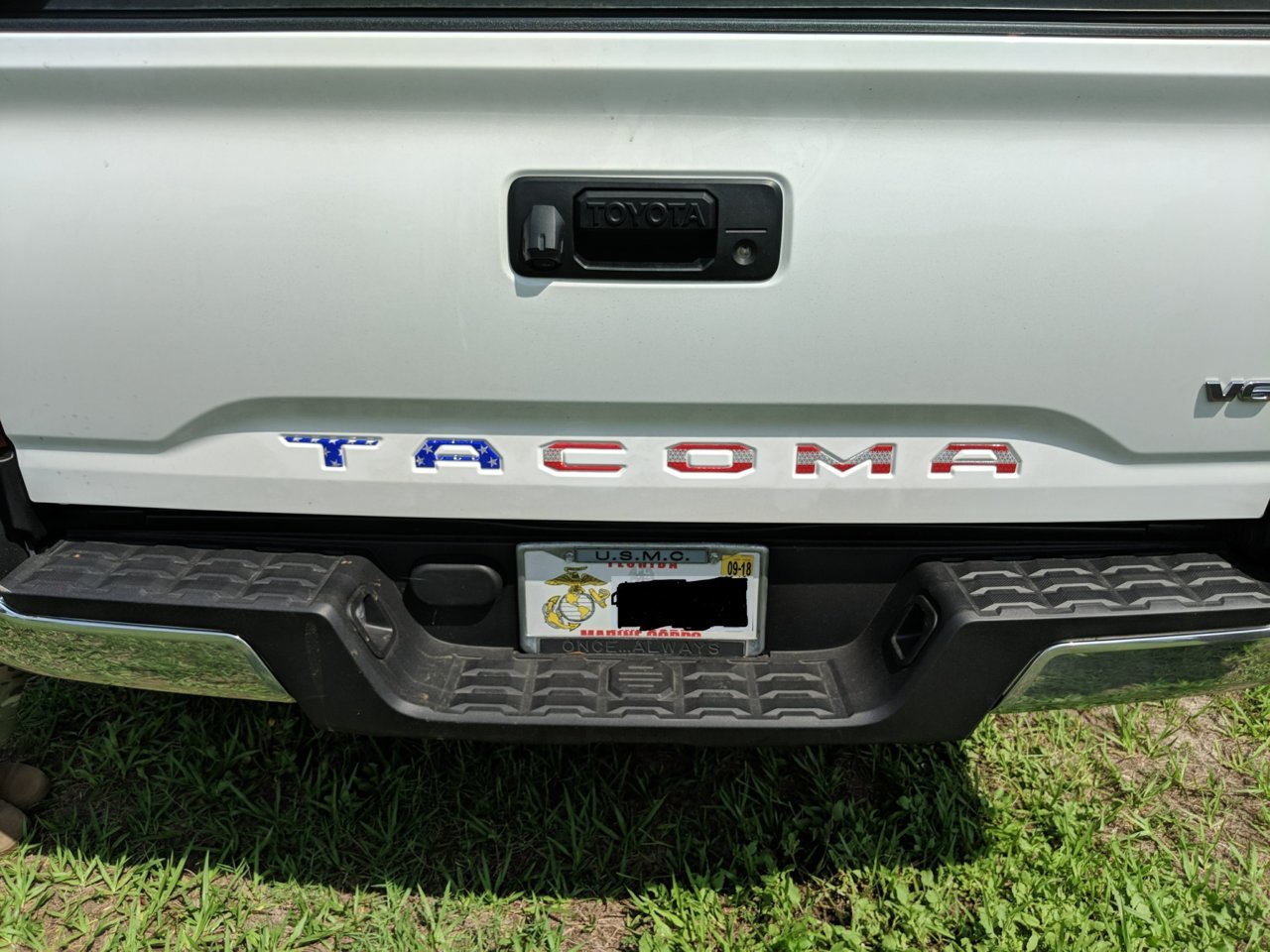

    'Murican Taco.jpg Wife bought me these the other day. Friggin so happy with the way they came out. And so the addiction has begun. Already looking to add step rails, LED interior lighting, all weather matts, and so much more.
